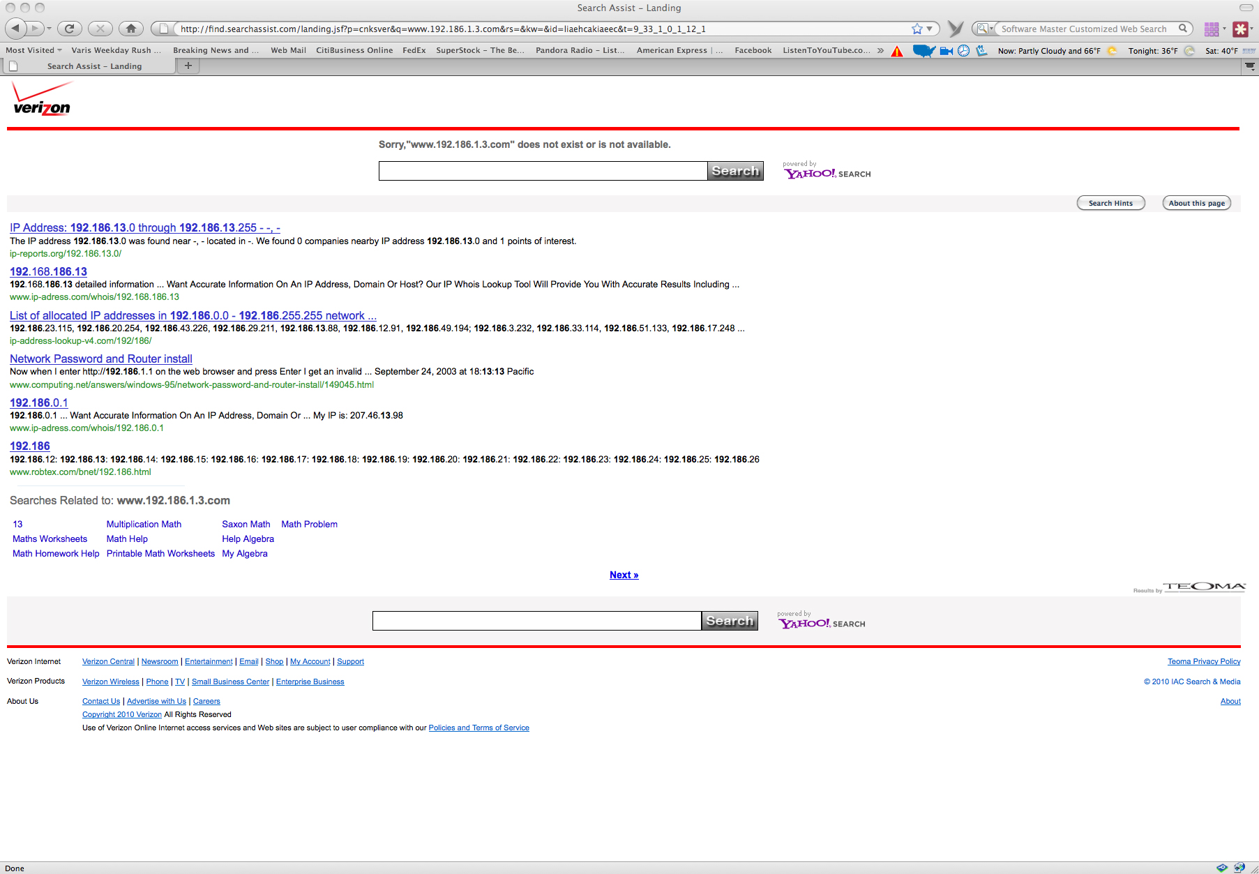

Okay, I have 2 computers here on my home network, a PC and this iMac, if I input the IP address of the PC into the URL bar of Firefox, I get "Unable to connect - Firefox can't establish a connection to the server at XXX.XXX.X.XX.", since the PC does not have file sharing or anything of the sort turned on, I can't connect to it. My printer a LaserJet 4m is fortunately or unfortunately still using AppleTalk/LocalTalk so it's not on the network. In the case of your printer you should get a configuration page (similar to what you got for your router's IP address). What do you get?

This is what I get when I type the address that use to be the laser printer address. Someone just told me it might have changed since I upgraded to a new DSL on its own and since my panel is burnt out I can't figure out how to print out the configuration page.

When you do get back, try the IP address again, but put 'http://' first, otherwise, your VZ router will grab the address. I've got a LaserJet 4, and when I set it up, I entered an address manually, into the IP setup, then entered that new IP address into the printer setup. If your panel is burnt out, you might be out of luck, because if it was setup with BOOTP, your router would have to support it. If you can't figure out what the IP of it actually is, you may want to call Verizon, and find out how to log into the router, and find out what IPs are being used.
