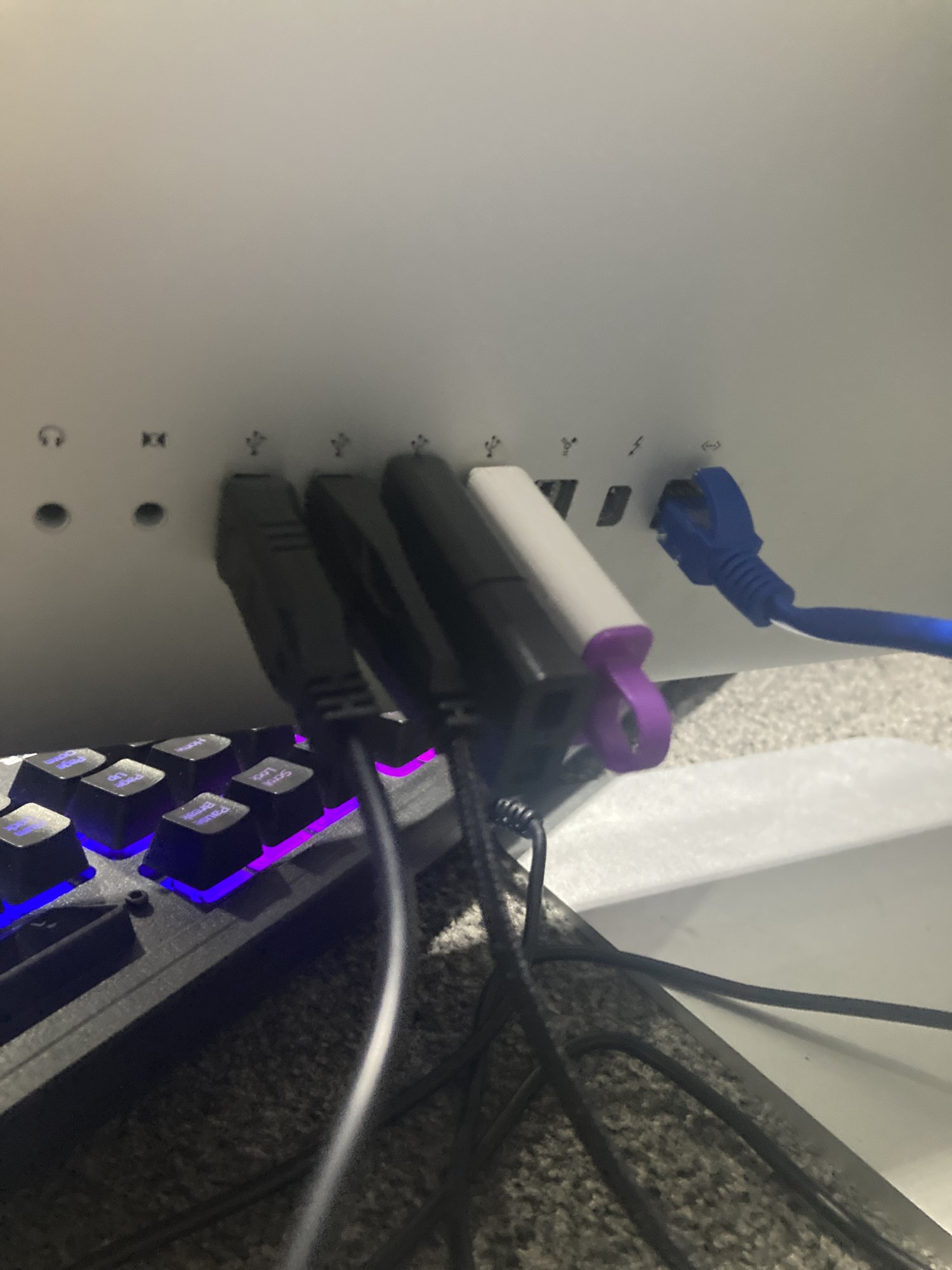

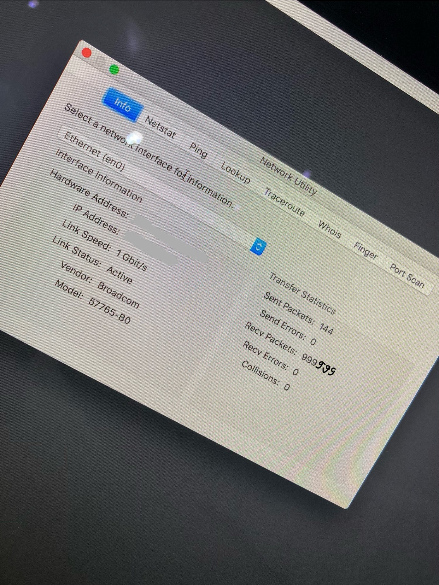

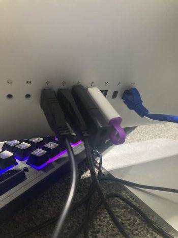

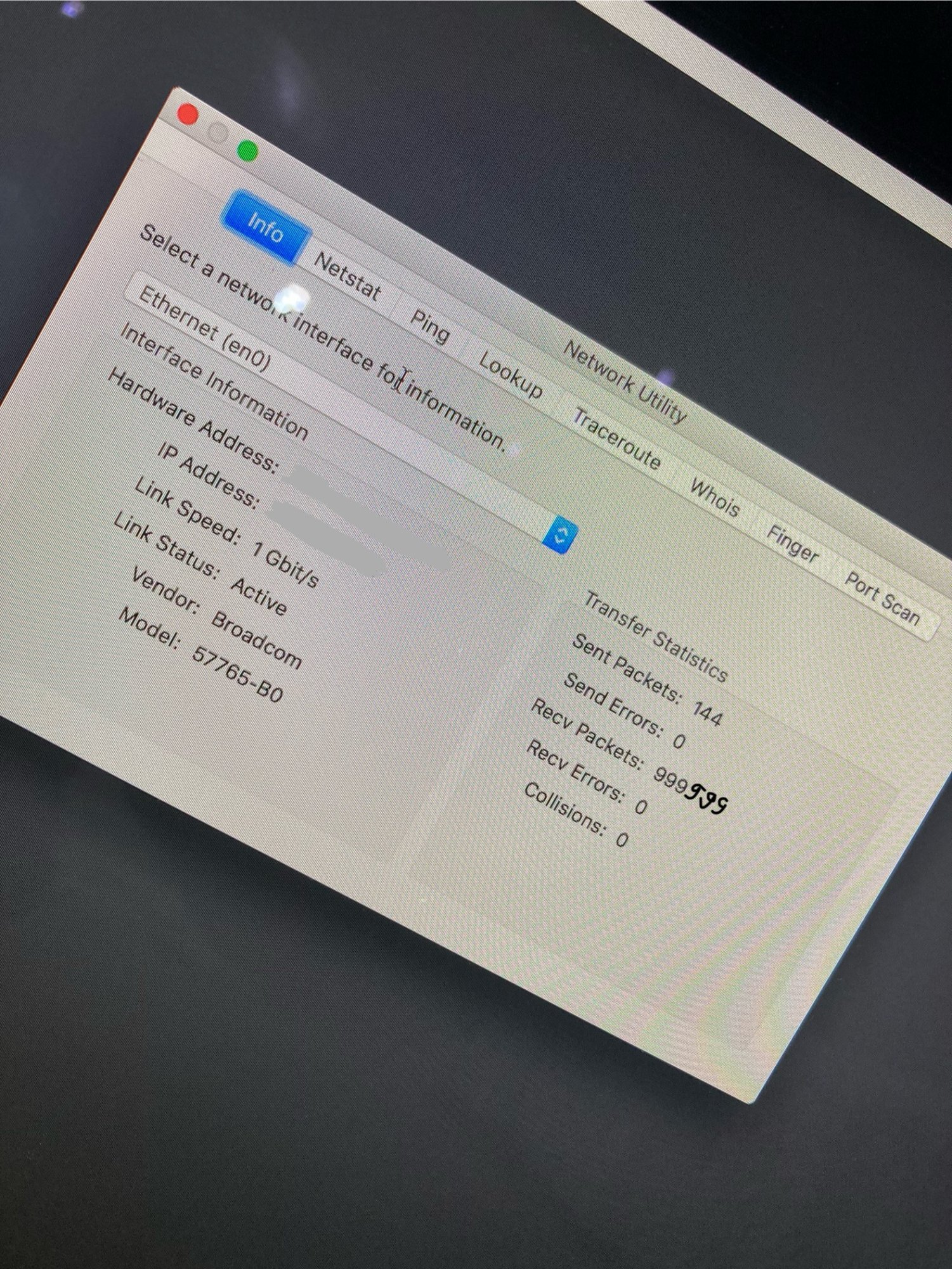

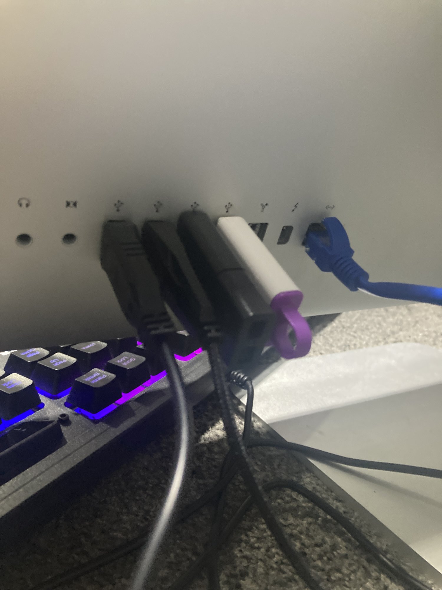

Connected via Ethernet

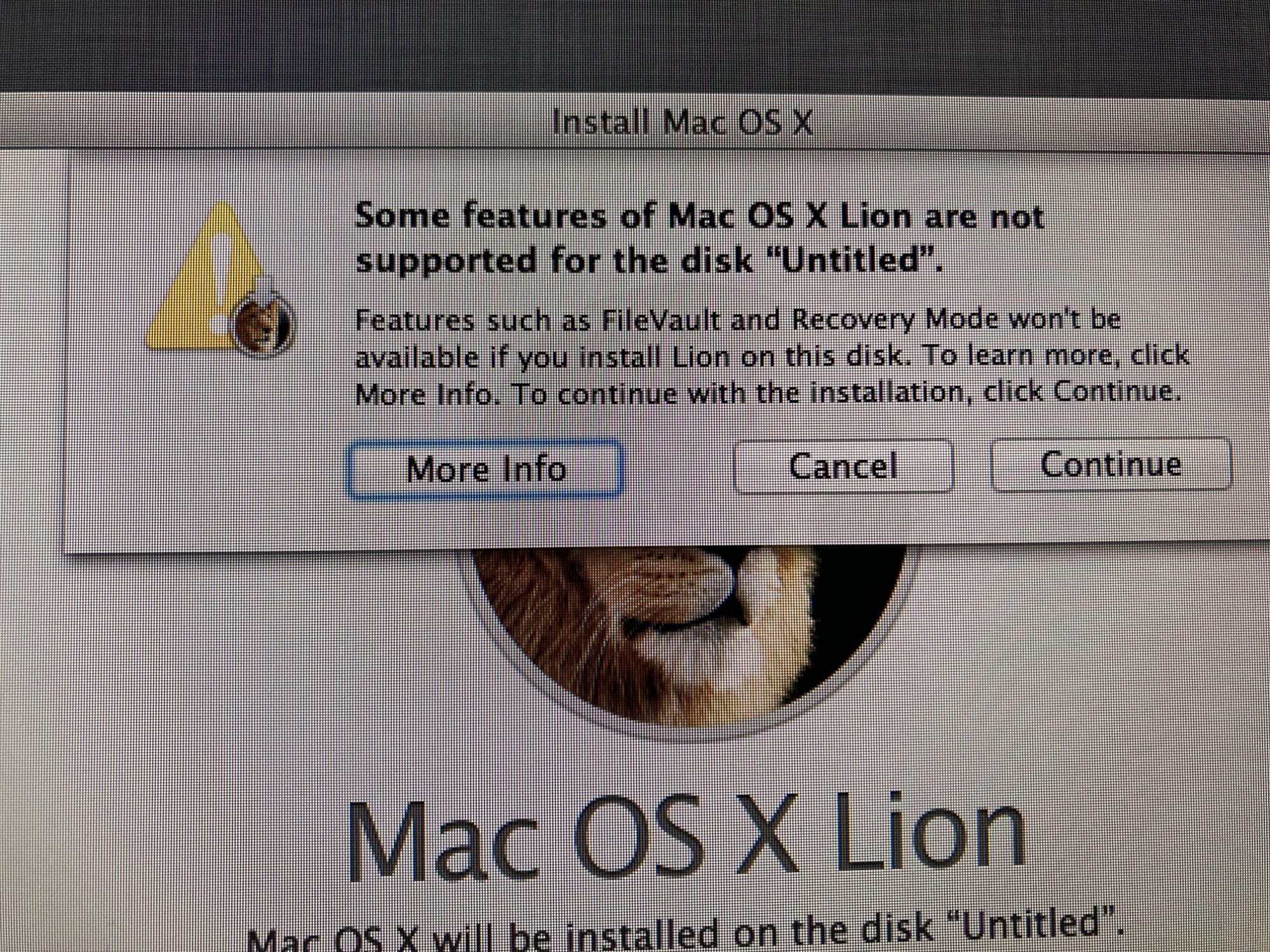

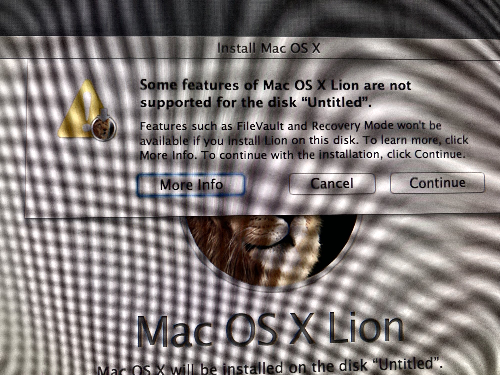

Update, New error using Bootable USB Lion
OP:
Re the alert in reply 27 above.
My advice is to just ignore it and continue.
The goal at this point is to get SOMETHING onto the internal drive that will boot the computer.
Once you get that far, then it becomes possible to address other issues.
But again... a Mac that boots, any version of the Mac OS, is preferable to one that will not boot at all.
