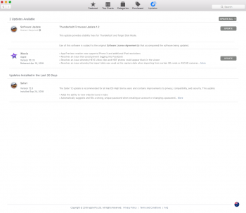

A new development today, in App Store, the Thunderbolt Firmware Update 1.2 shows up again in available updates, which I had installed many times before. The system dose NOT recognize the Thunderbolt ports again. :-(

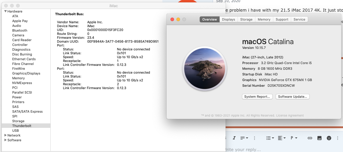

I've got this same problem. I've tried everything on line to remedy this but to no avail. The only thing that changed for me is Mojave. Running the hardware tests show no issues.
Here are some screen shots. Maybe someone can help fix this. It's MADDENING.
Thanks for your help.

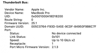

Same problem i have with my 21.5 iMac 2017 4K. It just stopped after i had the memory and storage upgraded. Now i have faster machine but no thunderbolt 3 and i've been suffering with this issue for about a year now. very furstrating and i dont know what to do anymore. i searchd online for any workaround to no success. please help.
Any luck with this issue? Same thing happened to me when I update to OSX 10.13.6 for my imac 2011 27". My Caldigit hub was working perfectly before the update and now it's dead. Tried the same hub on my macbook pro and it detects easily. Searched everywhere for answers, tried all the resets and reinstalls of osx but still doesn't work

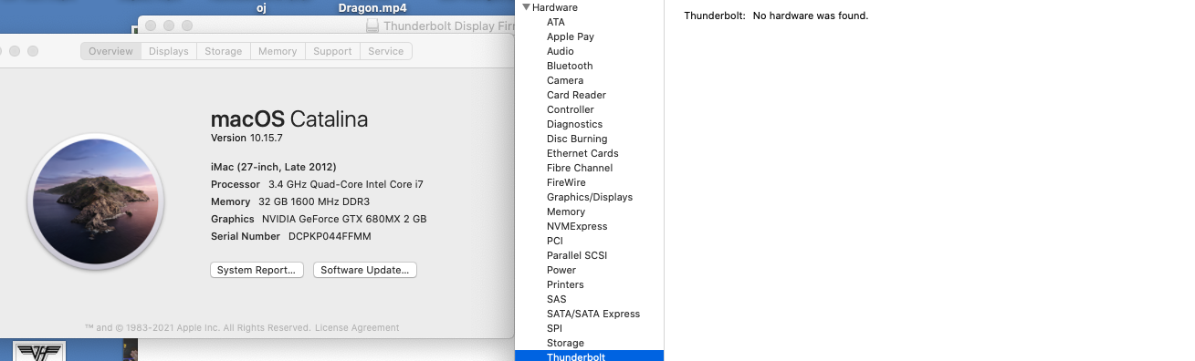

I just attempted to connect a dv camera via firewire adapters to thundebolt ports on my iMac 27" late 2012 model and nothing happens. Is it the same problem others on this thread are having? I can get the camera to connect to my Macbook Pro 2019 with the same firewire adapters and an additional USB C adapter and camera control and video capture work fine.

If anyone stumbles into this thread and has a solution for TB ports that just stop recognizing anything, please... send help.
I've been racking my brain over this...

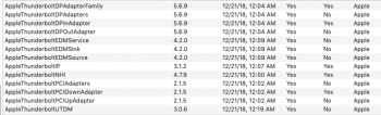

Late 2012 iMac 27 but system report doesn't look the same as others I've seen. Someone please figure this out.
