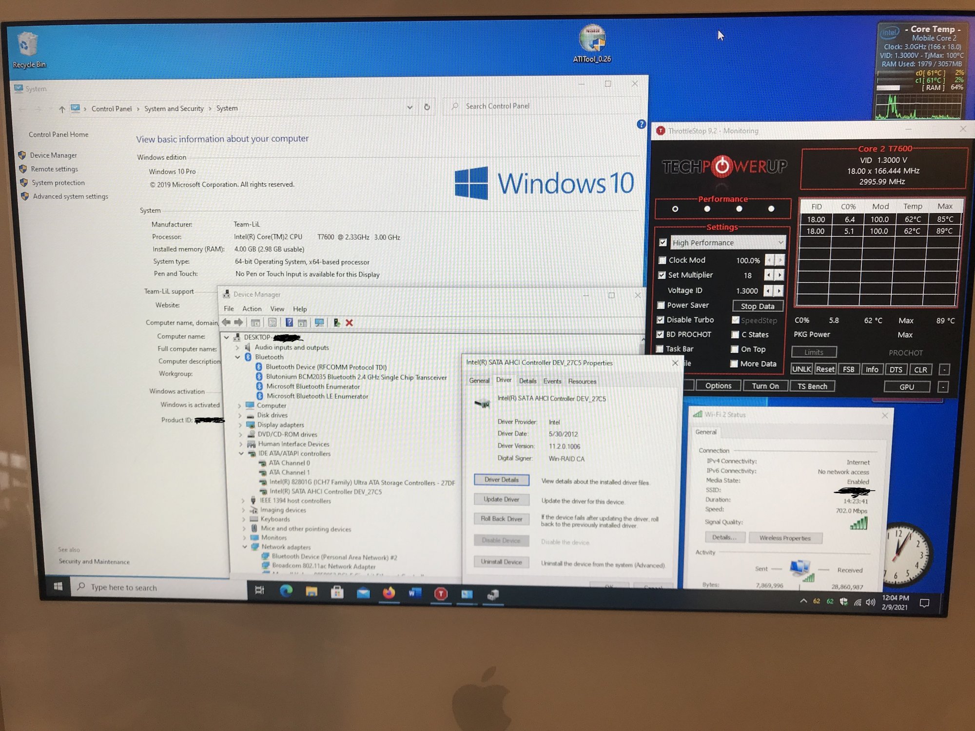

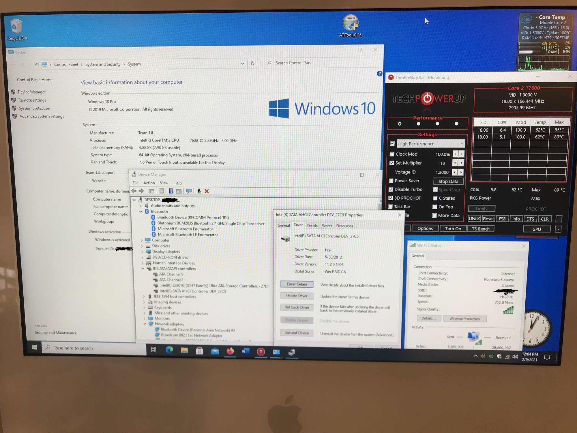

Everything works. I was probably a little conservative when I said you could only have half a dozen pages open at a time. It has handled everything I have thrown at it so far. Even x264 video files play with the x1600 graphics.
