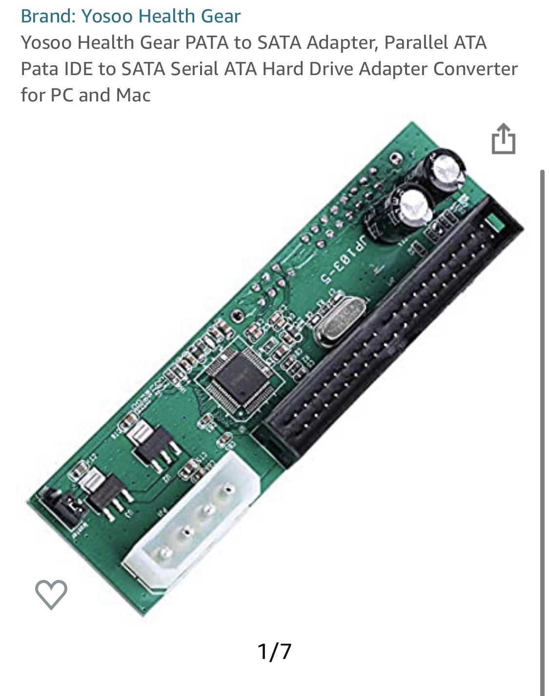

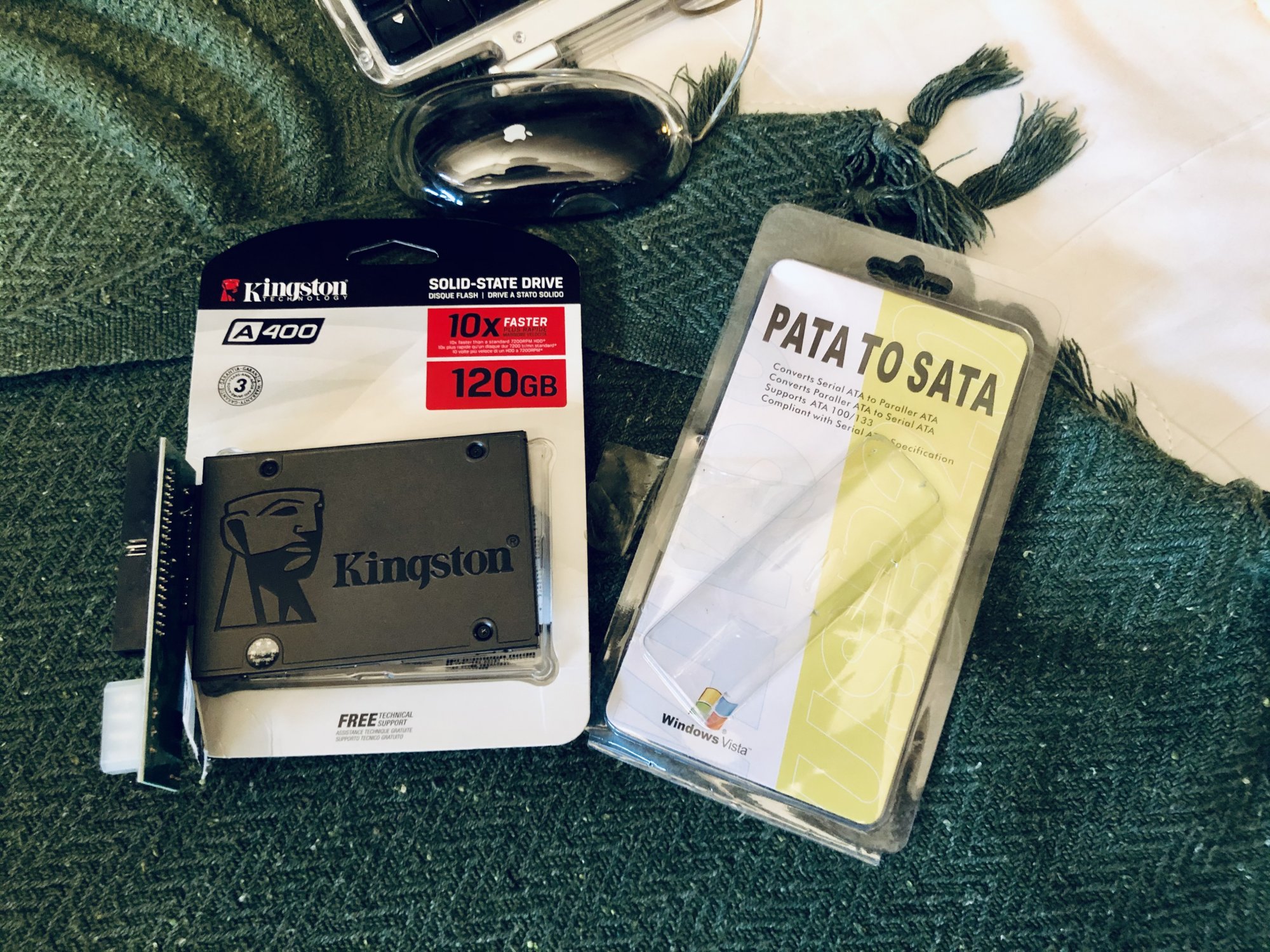

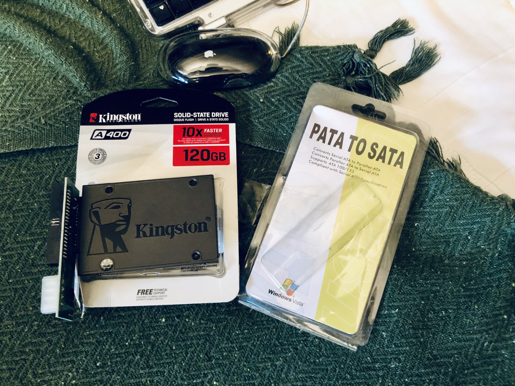

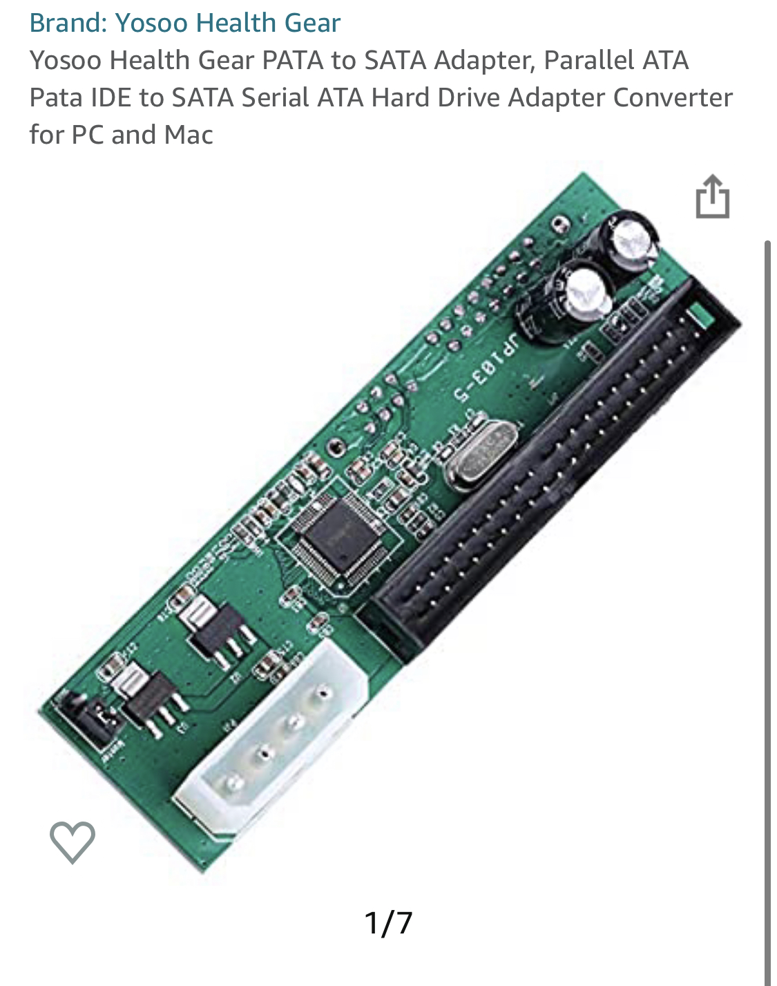

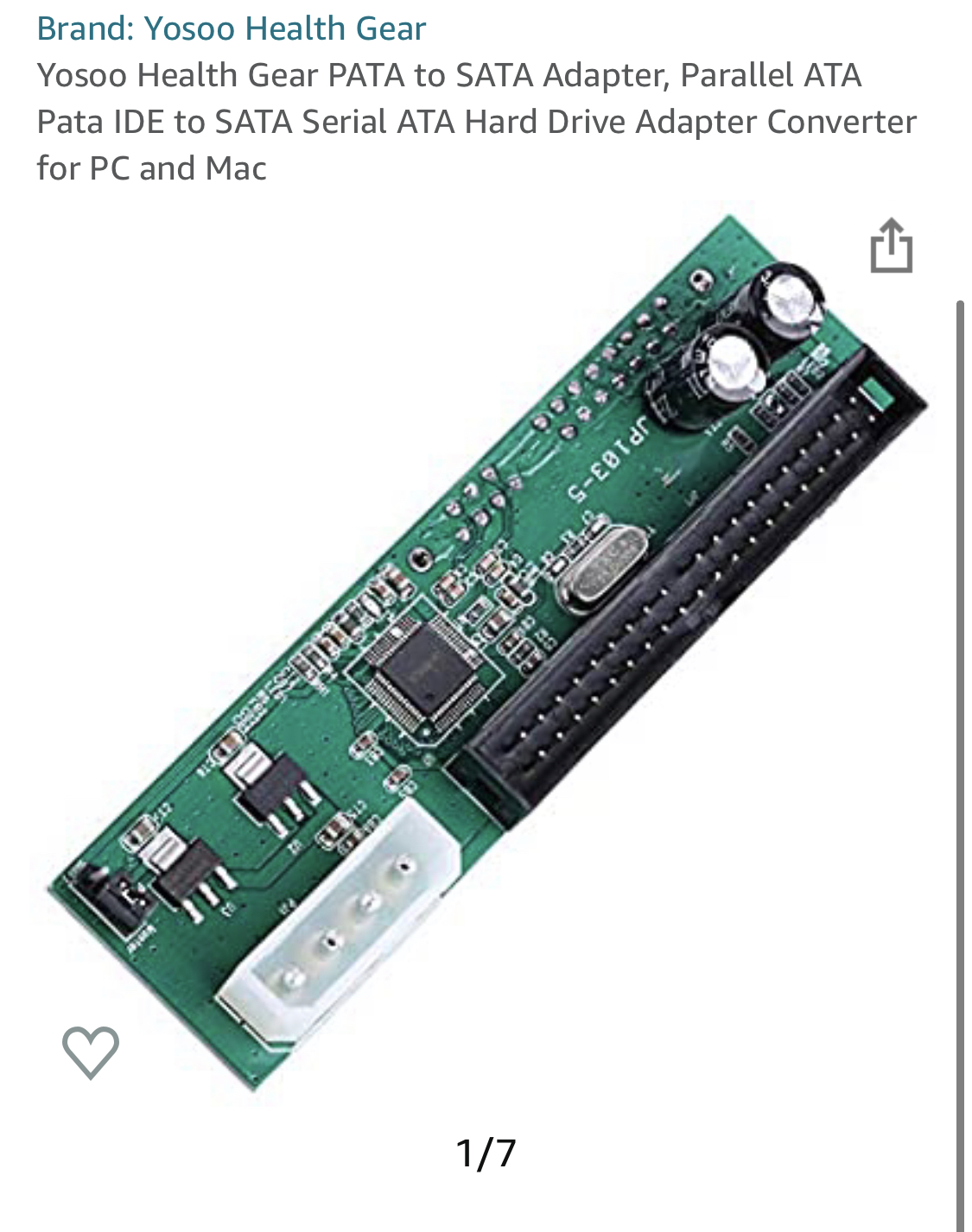

Ordered an adapter and SSD, but it unfortunately didn’t work, results in erratic behaviour. Had a nightmare to be honest.
I’ve ordered another adapter this time with a red circuit board, but if this doesn’t work I’m going the compact flash route.
I Originally ordered this green one as it has the slave/master jumpers on the left-hand side which are needed for the iMac apparently. When installed and set to master the iMac kernel panicked within about 10 seconds of trying to read the Mac OS X install disk.
I Switched the jumper over to Slave option and the install CD booted all the way through, but the new SSD did not show up at all in Mac OS X disk utility or the OS 9 equivalent.
when attempting to load the machine into Target Disc mode the iMac just switches itself off within ten seconds.
I also connected a mechanical SATA hard drive just to make sure power was getting to the adapter properly and I can confirm the two mechanical hard disks I tried did spin up but they still wasn't detected either within disk utility or the install screen.
I have made sure everything is pressed in properly and nice and firm, putting in the old 3.5 inch IDE HDD the iMac boots right away and no issues at all.
so far a rather disappointing experience.
