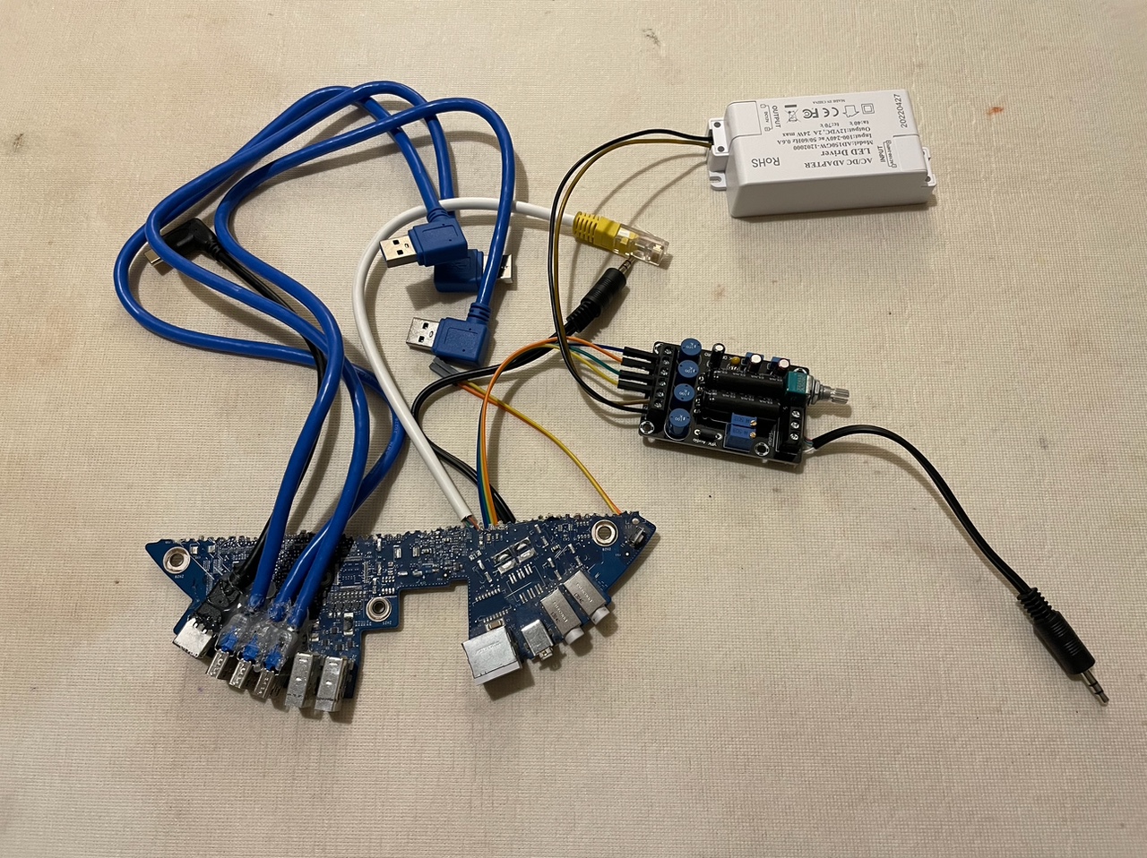

Since a few months I stayed in contact with @PML7554 and he offered me his service to convert an original iMac G4 motherboard with the ports so I can use it for my conversion. He did:
- 3x USB 3 extensions
- Ethernet extension
- I/O power button extension
- Audio 3.5mm jack extension
- Audio 2.5mm speaker extension (incl. powered amp)
- USB-C extension for future upgrade for an M1 Mac Mini.
This looked like this:

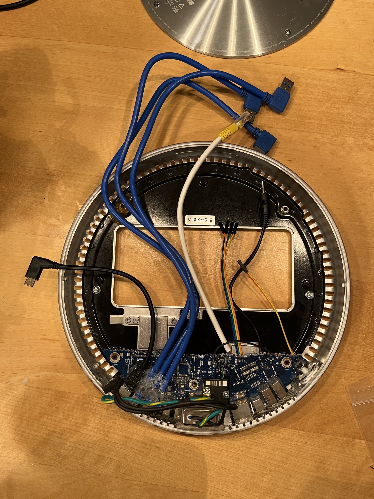

So I built in my modified board into the G4's base:

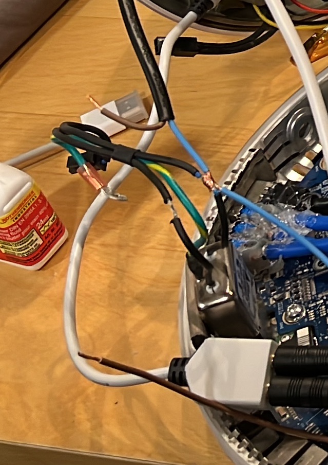

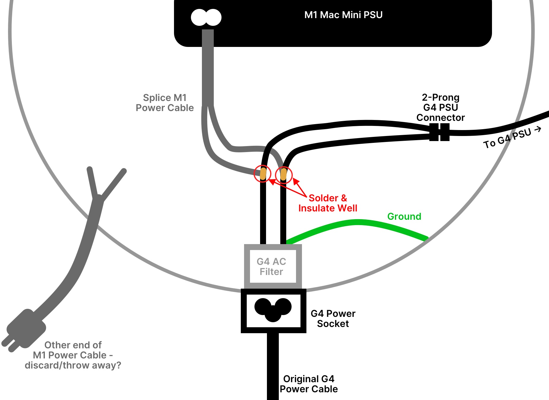

Had to solder the AC/DC and power chord of the Mini's PSU to the power cable of the G4:

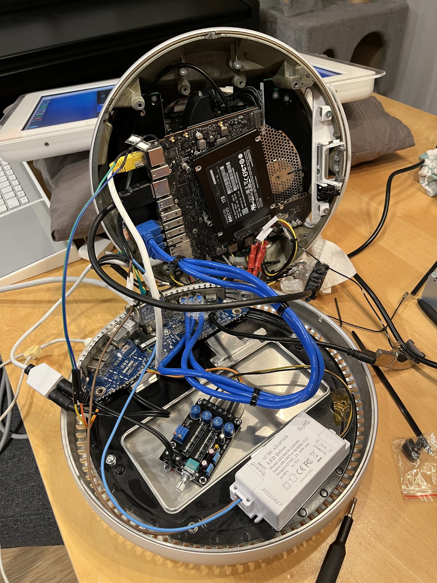

And tried to fit in all the internals incl. motherboard of the Mini inside the G4. Unfortunately I noticed I need some new cables as my SSD won't stay in position and the audio jack and HDMI cable are too long so I need some with angled plugs. So this is the update so far, it's not finished but will be soon!
Are you doing this with a drive in it? if so, its Very easy to run out of space. Looks good though!
No unfortunately not as the 2012 Mini board is too big for that. When I find a cheap M1 one I'll replace them and hopefully will add a DVD drive to it.
So I put everything inside the G4 case and closed it. It ran maybe 1-2 hours and I noticed screen started flickering and it was getting hot inside the case. So i shut down the computer and decided to disassemble it again. Maybe a 2012 Mac Mini quadcore isn't the best solution for this project, so I'm getting rid of the little one and will save for a M1 Mini for this project.

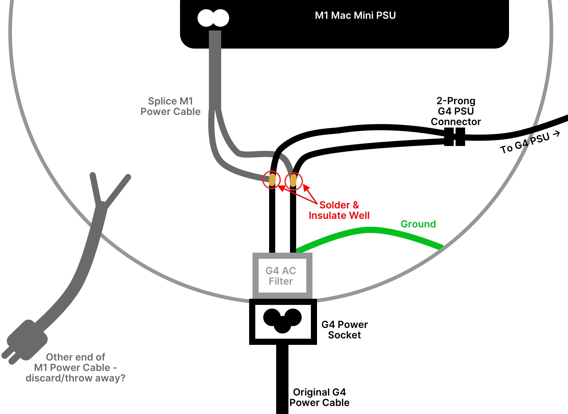

@gagigu I'm a little confused on how you wired the original G4 power cable to the M1 Mac Mini's PSU...is this basically it? Just a simple splice of the wires?
