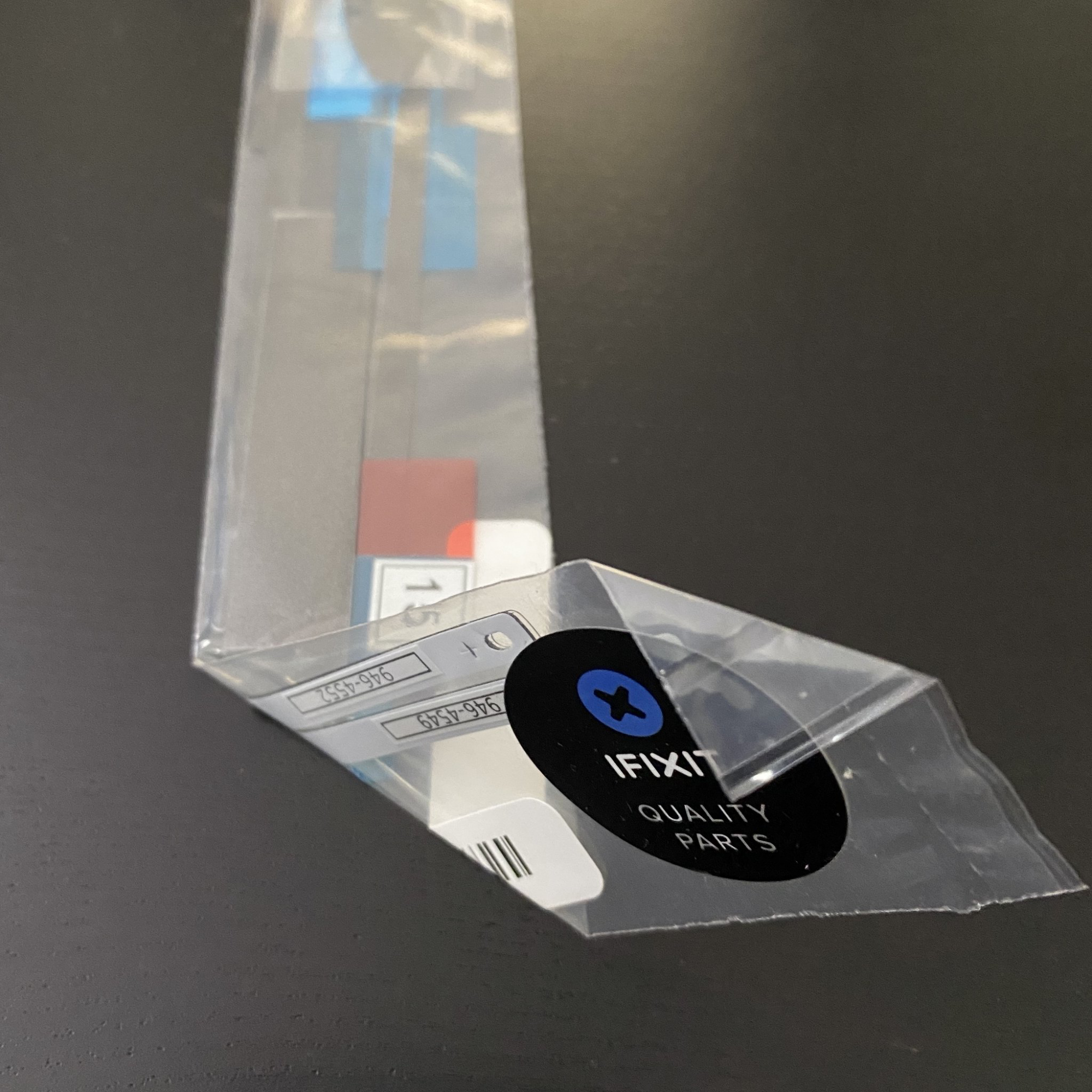

The adhesive strips arrived today and 2 of them are bent. Will that be bad for reattaching the screen? I'd hate to dust the heck out of the interior, then not be able to secure the screen back on, due to the bent strips. I sent iFitIt a message on Twitter asking them earlier today, but imagine I'll get a quicker reply in here.

Be careful using those ifixit adhesive strips. Someone in another forum used the ifixit strips and the screen fell off. Make sure the strips are in good condition and if they're not, ask ifixit to send you another set.
It should be fine. Just make sure you press it down evenly when you put it on the housing. Also make sure you’ve removed any small pieces of the old adhesive that you don’t get when you get the bulk of it. If you want to be really cautious you can also leave the screen pointed upward overnight.

I used them when replacing the HDD to anSSD in my 2013 21 iMac, no problems at all. iFixIt is my source of choice when looking for spare parts of tools for my Apple stuff. No worries, even the slight bending does not cause problems. After taking off the protection it is easy to fix them straight and plain.
Once the stickers are applied, they're thin and supple enough that any bends incurred during transport will not matter. Mine were fine, and my iMac has been perfectly fine for the past twelve months (since I applied them)

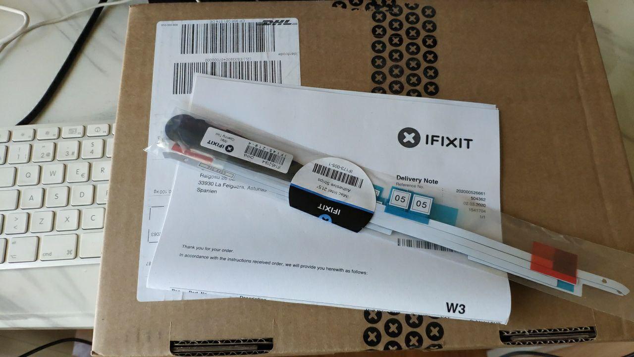

I'm still waiting for mine to arrive. It was supposed to be delivered yesterday but still nothing
Just received
They looks pretty nice, still not sure if there's foam on them but I'm confident that quality is very good

I think these had what you're talking about. Don't think I'd trust strips without it.
