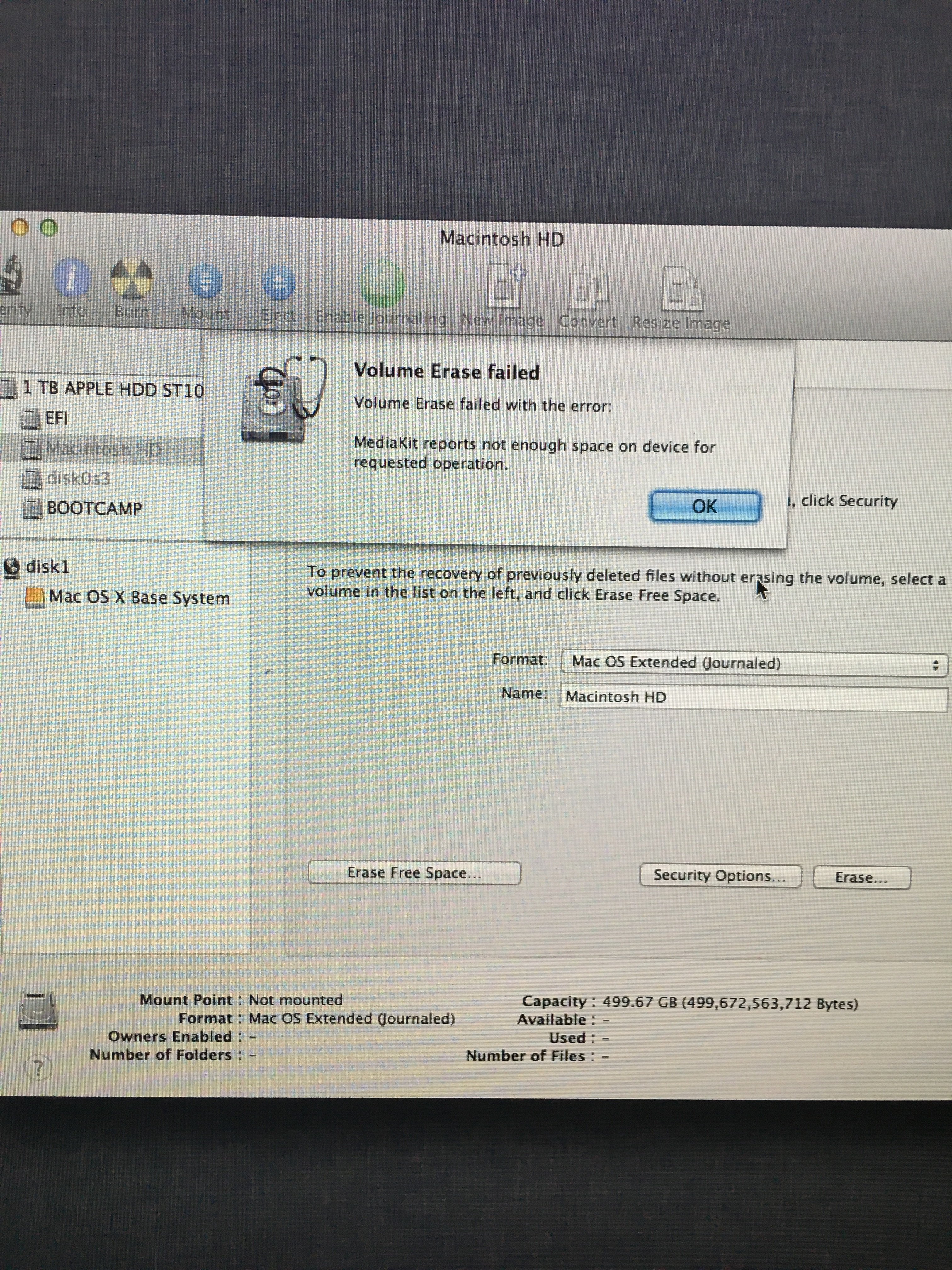

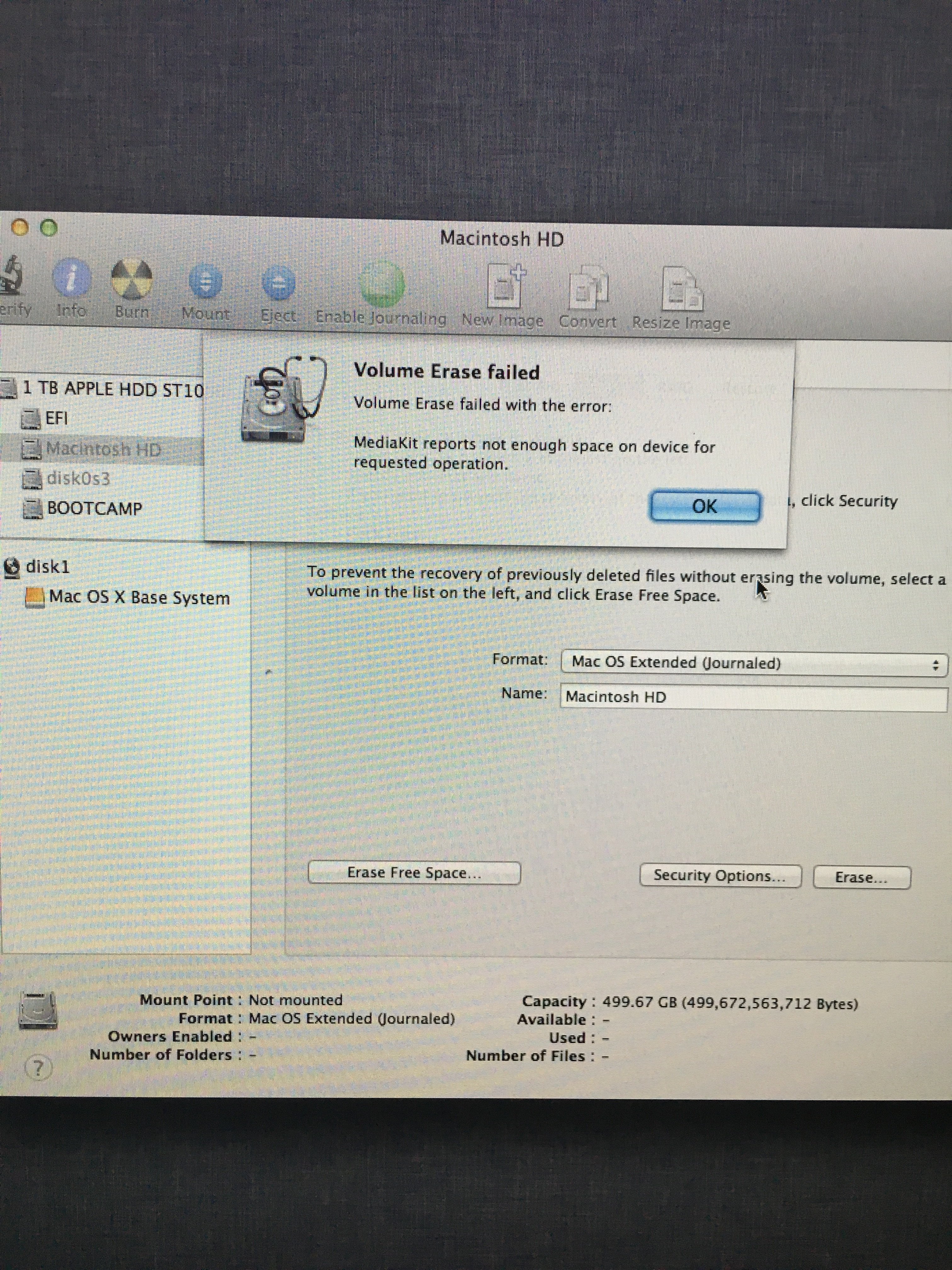

Hello, i try your solution but when i delete the hdd, it gives me this error.
That looks like it's booted into a 10.8 or 10.9 recovery partition. Did you do CMD+ALT+R on startup?
If you did, try CMD+R on startup instead and attempt the erase again. If the Macintosh HD volume is greyed out, right-click it, select Unlock, then enter your user password. And then try to erase.

Both are not working. 🙁
[doublepost=1490280173][/doublepost]
both are not working 🙁
Can you take a photograph? Is it the same error?
I'ts the same at the top img error. Before when my hdd is still fine, i delete something inside disk utility, i forgot it now. After deleting that extra partitions that i forgot, i got this issue 🙁

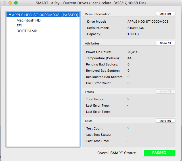

Hmm OK. But you still have your macOS partition right (as in you can boot into the OS)? If so, login and run SMART Utility: https://cloudfront.volitans-software.com/smartutility323.zip
If that passes, that will at least isolate that the problem isn't related to a failing hard-drive.

Thanks, here is the image when i open smart utility.

Thanks, After opening smart utility, I got this result.
Jolly good, the hard-drive is OK so no worries there. Unsure why there's an EFI partition listed in there, though... that's certainly not right. It shouldn't be visible.
Honestly I think it may be best to go the nuclear option. May I have a second opinion @Weaselboy? Best to completely wipe through Internet Recovery on this occasion and start again, unless you have any other ideas? I'm a little lost. 😕

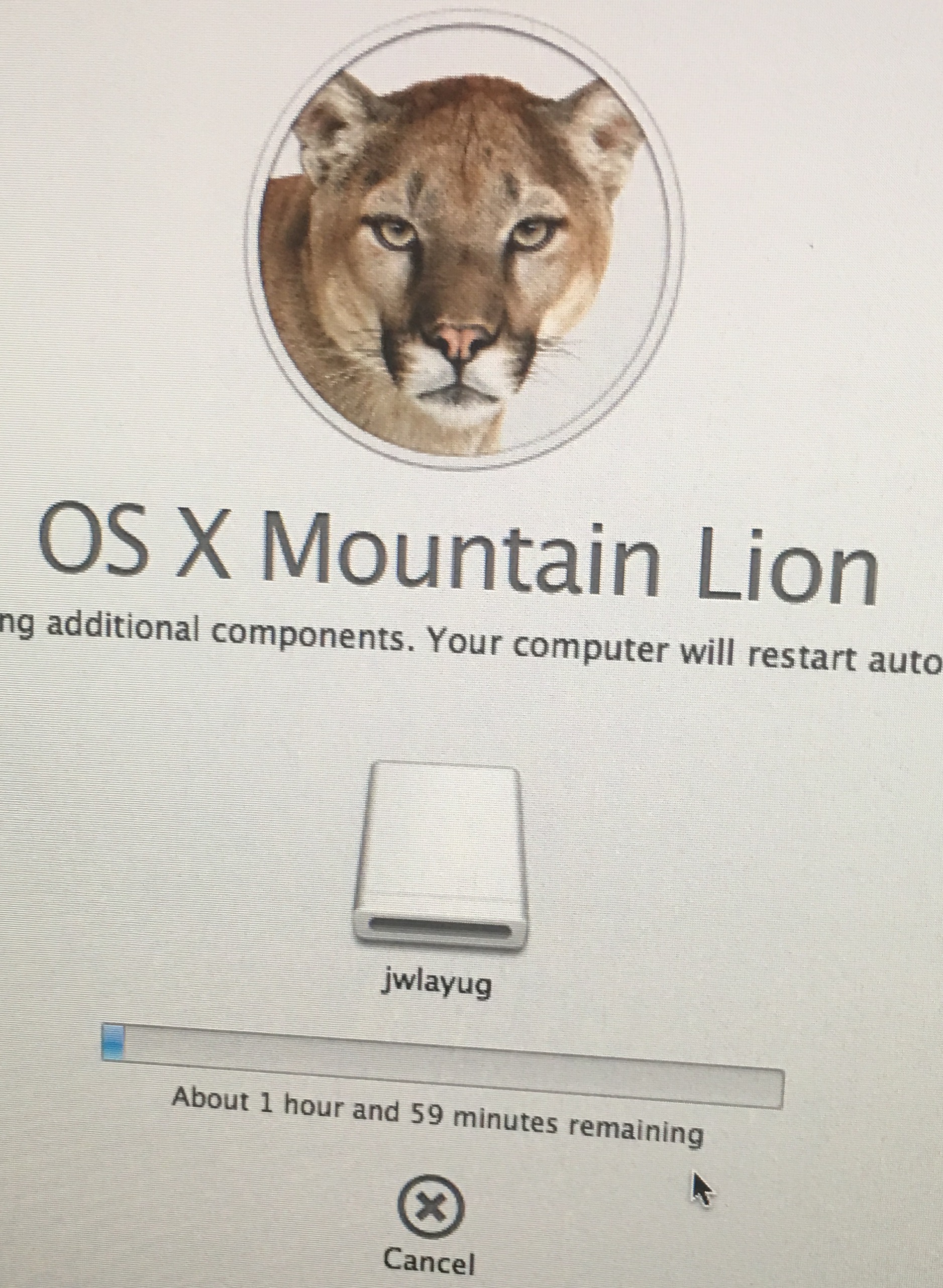

[doublepost=1490284860][/doublepost]I'm installing osx inside my flash drive. Can someone give me the next step?

"I'm installing osx inside my flash drive. Can someone give me the next step?"
From the looks of the pic, you'll have to wait about an hour and 59 minutes...
