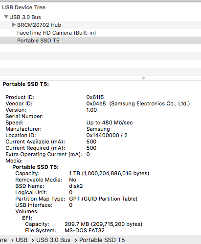

Due to slowness I've recently attempted to boot from an external SSD (Samsung T5) using USB 3.0 rather than running off the slow hard drive. I've followed some instructions to duplicate my data to the SSD. And it booted fine to the new drive and things seem to be running quicker.
Here's the problem: I ran Black Magic to test speeds before and after. Before the change I was getting read and write speeds of approximately 140 MB/s. After the change I'm getting around 38-40 MB/s. I checked and confirmed that the USB is running off the USB 3.0 bus and in the System Report, it says the drive max speed should be 480 MB/s.

If you're seeing the maximum speed is 480, that's megabits not megabytes, so your drive is connected as a USB 2.0 device rather than USB 3.0, so the slow speed is about right for USB 2.0.
A device connected as USB 3.0 would show that it's connected at 5Gb/sec (that's gigabits) and then the speed would be substantially faster. Do you have the SSD connected directly to your computer?

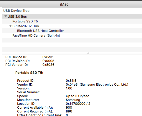

I was able to figure it out. I unplugged all usb devices - someone on another thread said that if the bus reads a 2.0 device first it affects the rest of the ports. I also reset the PRAM/NVRAM.
Thanks for your help!
Before:
After:

The problem happened again after a reboot. PRAM didn't solve it this time.
Well, after another SMC and PRAM reset it turned to 5Gb/s again.
