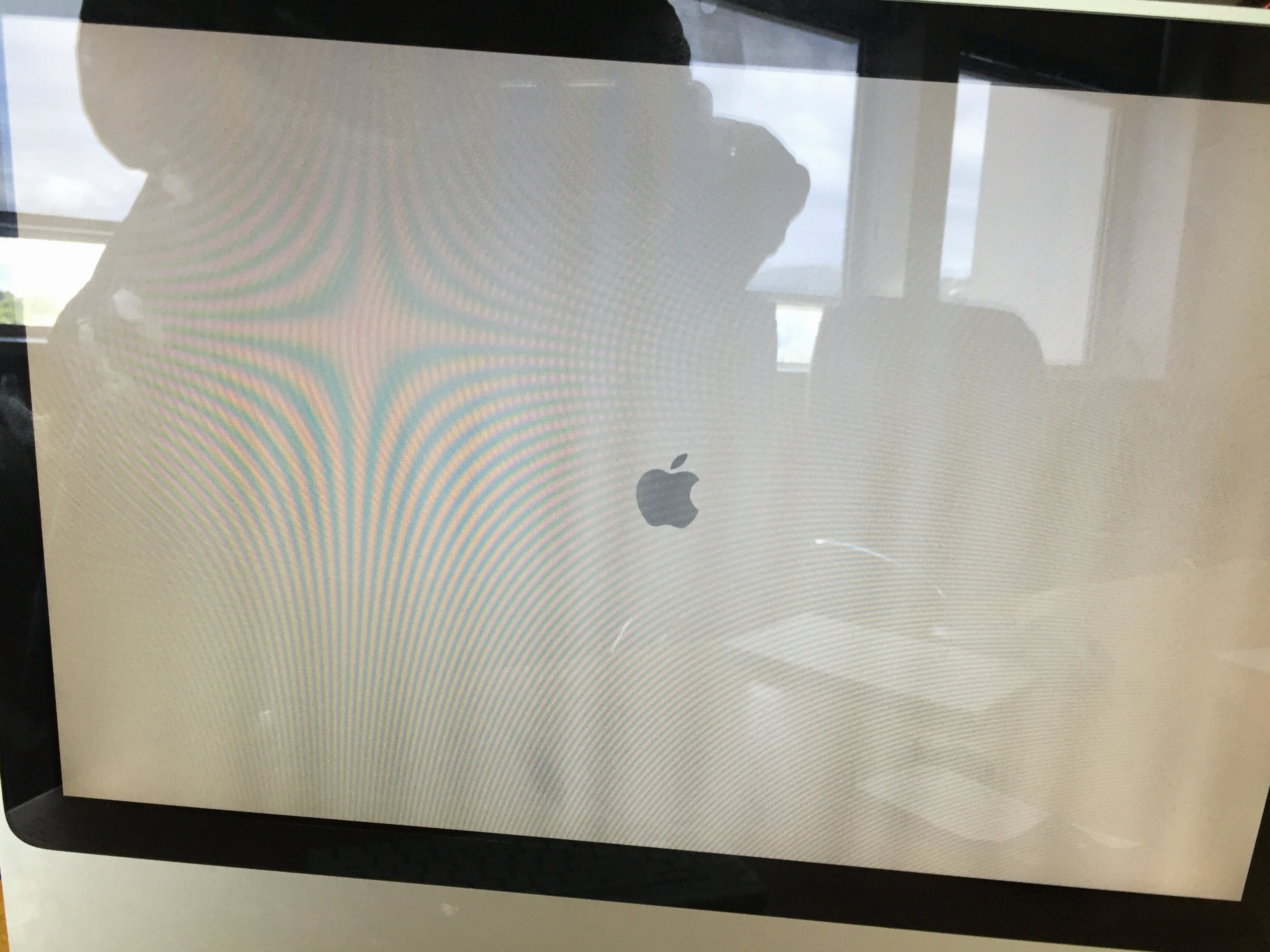

I have 2 iMacs here- Mid 2007 and Late 2008: the late 2008 model had while lines down it indicating to me it has a broken LCD? Is it possible to use to the LCD from the 2007 iMac and install it into the 2008 iMac?

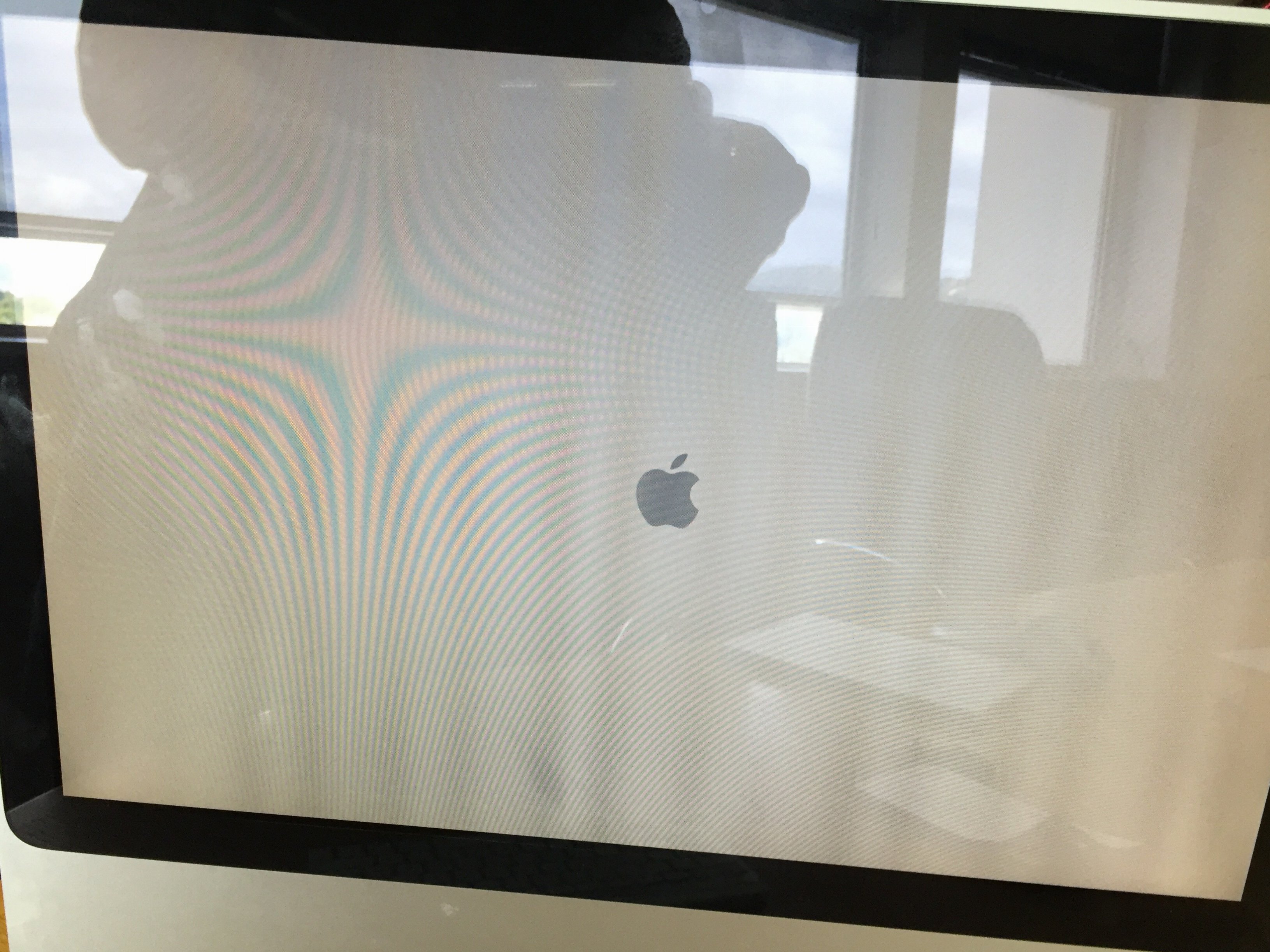

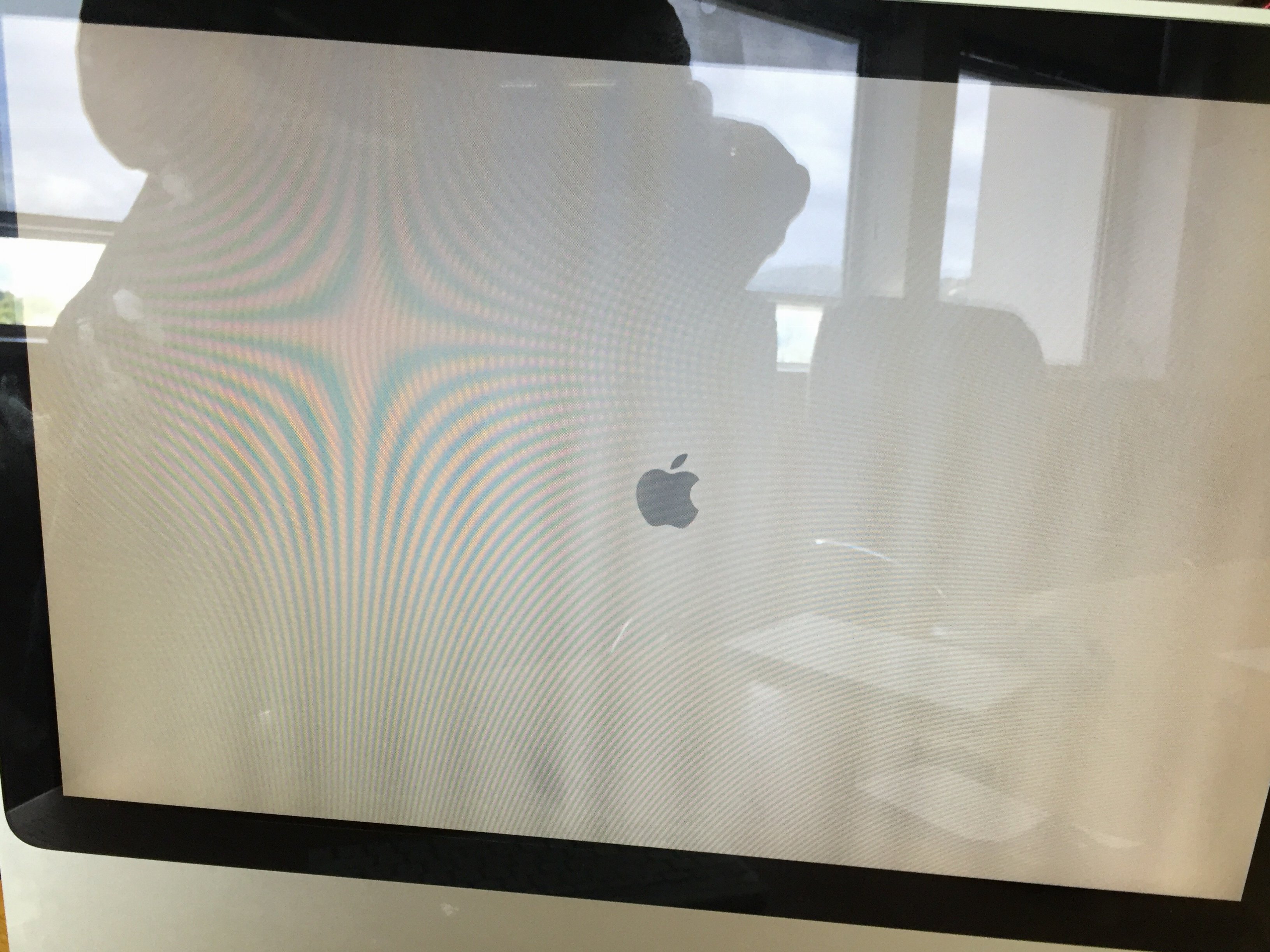

Hi there, they are both 20 inch screens, please see image attached to have a look at what you guys think! Thanks heaps

The glass distorted the image some but if you are talking about the dark faded lines going vertical than that's the display.
So in this particular image, is it the wider dark/light alternating bands that go straight up and down, or the curving, narrower bands that seem to decrease in width?
I'm guessing from your original description and bizzie's post, you mean the straight up and down bands.
In any case, I'm afraid I can't tell whether the LCD screen or the graphics card is more likely to be the problem. I haven't encountered or read about any LCD failures, so I'm not sure how they would show up.
