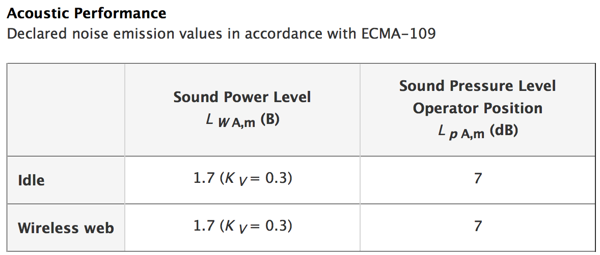

Apple specs the M1 iMac as producing 7 dB at both idle and under light operation (wireless web surfing) from a "typical operator position" (see screenshot at bottom). 7 dB is really quiet (acceptable noise floor for a recording studio is 20-30 dB). The figure is not meaningful without knowing the "typical operator postion", which they don't specify, but since it's got a display we can guess it's no further than ~24". Given that, the thing should be really quiet under light load.
Alas, and in practice, the only way for you to know if there's a problem with your unit is to find a way to compare it to a second one.
