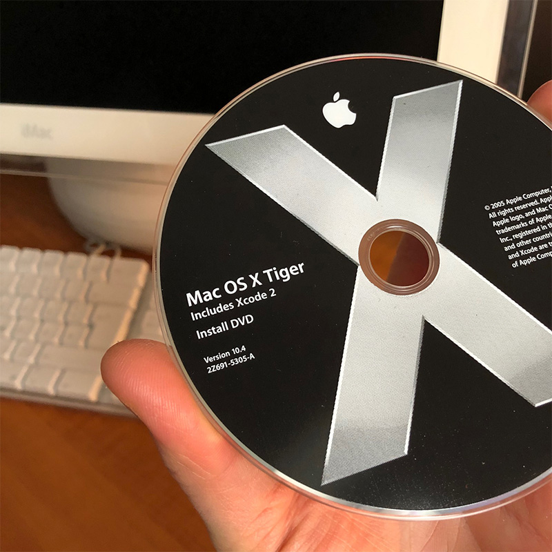

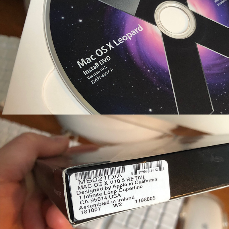

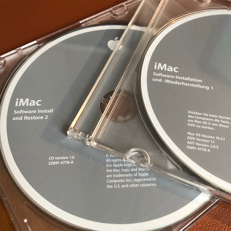

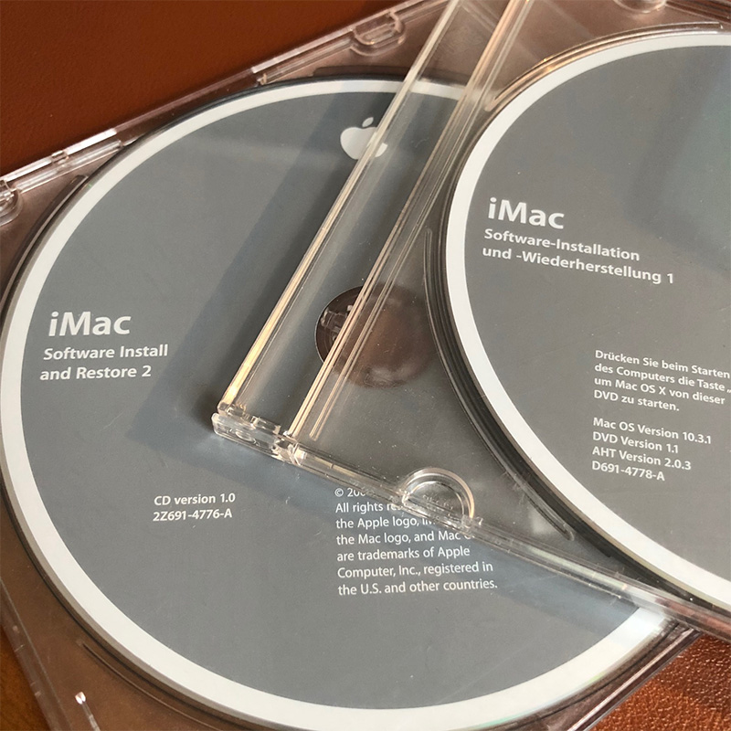

One last question regarding OS installation:

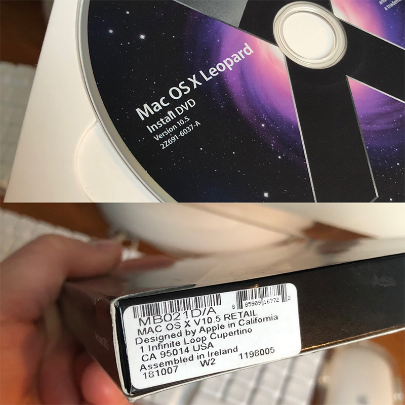

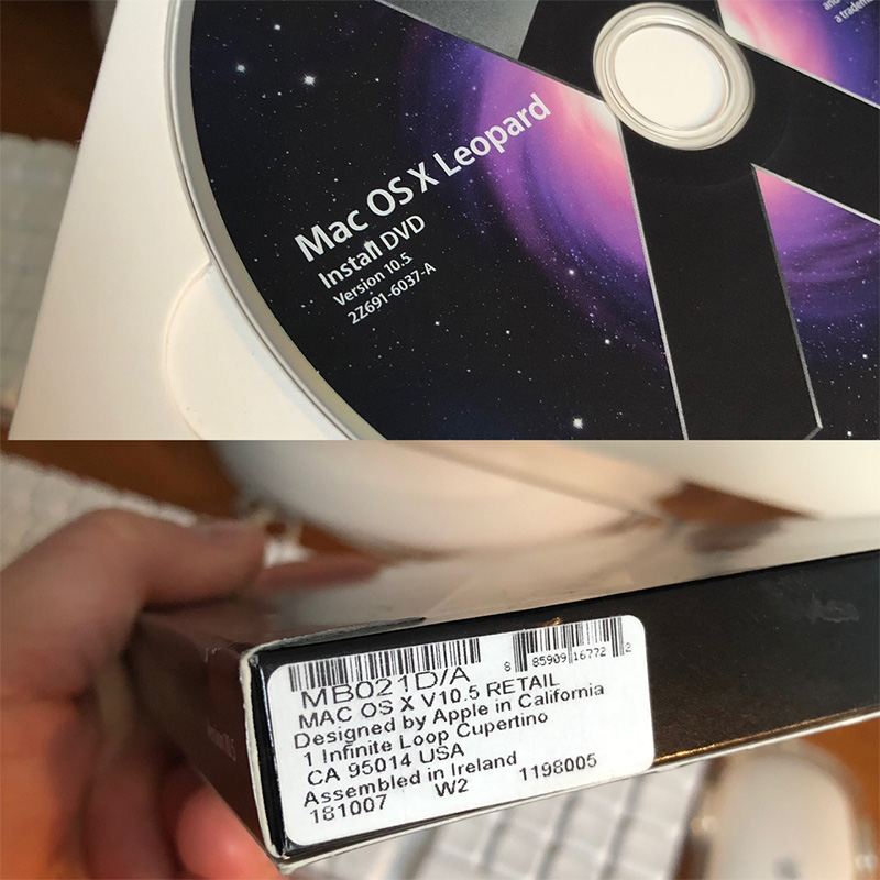

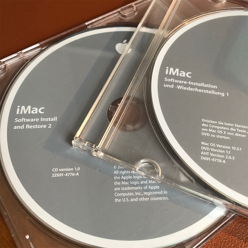

  • The original OS of the iMac was 10.3.1 > I have the original DVDs.
  • Then later on it was being updated with OS 10.5.8 Leopard. I have the original install DVD.
    I want to install the 10.5.8 Leopard on the new SSD.
  • Anything to be aware of with that?
  • Can I simply boot/install 10.5.8 from the new SSD after implemented?
  • Or do I have to install 10.5.8 on the new SSD before via Firewire etc.?
  • Or do I have to install the original 10.3.1 first and then upgrade that with the 10.5.8 DVD?

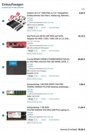

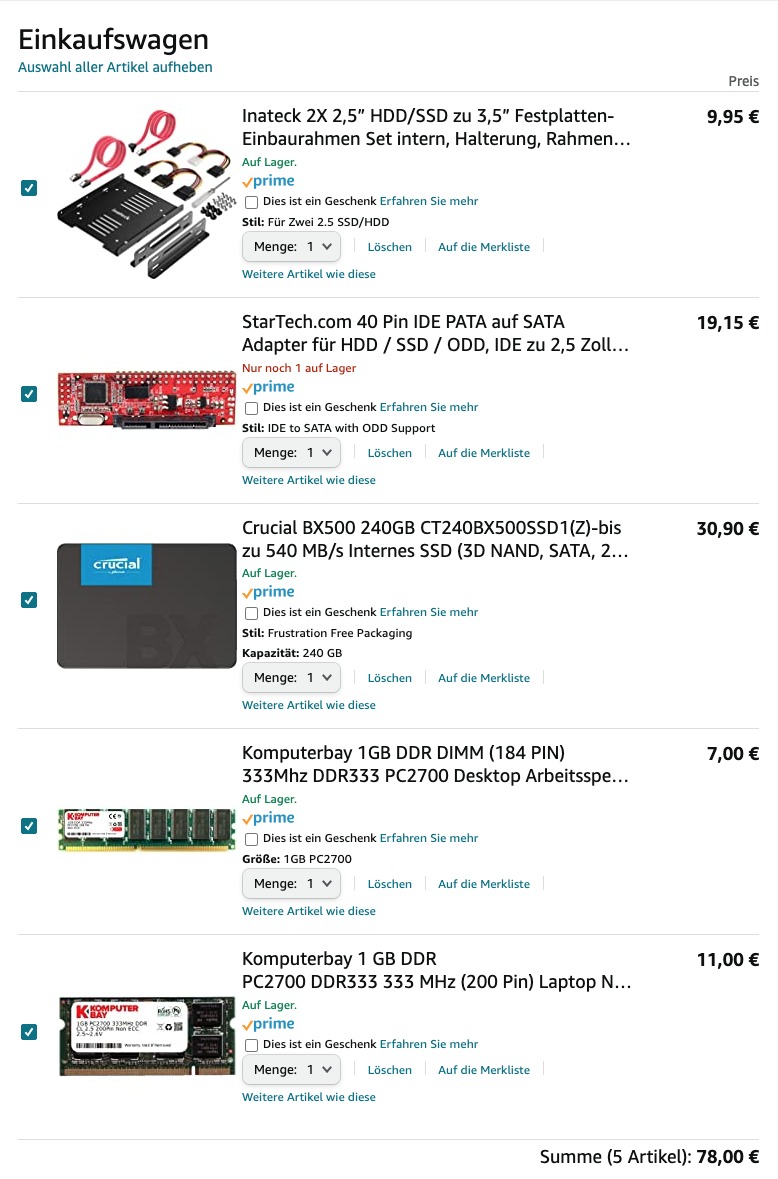

Wohooo!!! ;-) I've ordered now SSD, mounting adapter, IDE/SATA adapter and RAM modules at Amazon and will let you know how it's going in the next days. 😉
