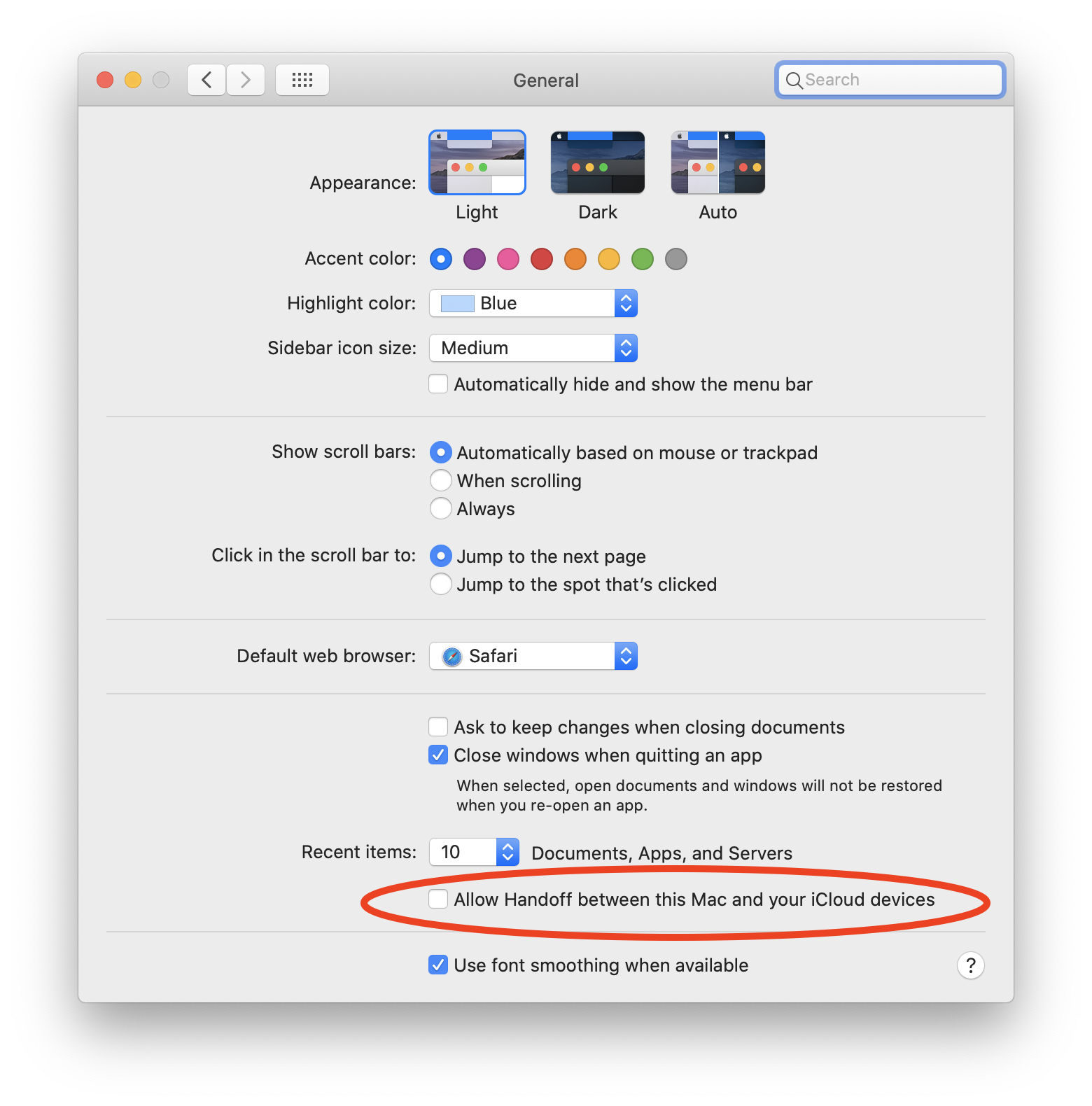

Reading on several other sites that disabling Handoff in Sys Prefs then restart actually fixed all of their bluetooth issues and most of not all of their audio issues.
Going to try this on the iMac Pro tomorrow and make several FaceTime w/ Airpods Pro calls as this combo of Bluetooth and audio will 100% cause glitches.

Disabled Handoff in System Preferences, restarted the iMac Pro and ...
2 Hours in this morning and no Bluetooth mouse glitches / hangs / etc .... yet.
Also no glitchy Bluetooth audio yet. I have kept a single AirPod Pro in my left ear with YouTube playing in Chrome.
This normal would drop audio at minimum 1-3 times per 10 minute video. So far, zero audio drops.
I have not tried FaceTime or internal audio yet, I plan on trying that later this afternoon.

Hoping this helps others that may be struggling with this annoyance.

I have experienced a sinlge little "hiccup" with audio over the last week. With around 6 hours a day with the airpods in connected to the imac pro. Prior to disabling handoff, I would get 5-6 issues per hour easily, either with the mouses "skipping a beat" or a small pause in audio when watching a video, phone call or Facetime call.
Now these issues have essentially all disappeared, for me.
Everything else left the same and no changes in daily behavior, just disabling Handoff.

Someone mentioned above disabling Handoff. After doing that I have not had the issue for about 2 weeks so far. Not convinced this is the solution, but so far seems to be working.
