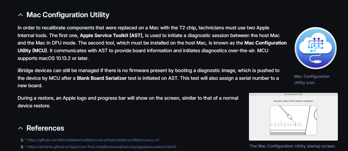

Yes, and apperently you also need AST (Apple Service Toolkit) for this:
https://theapplewiki.com/wiki/T8012#T2_Recovery_USB_Device_ID

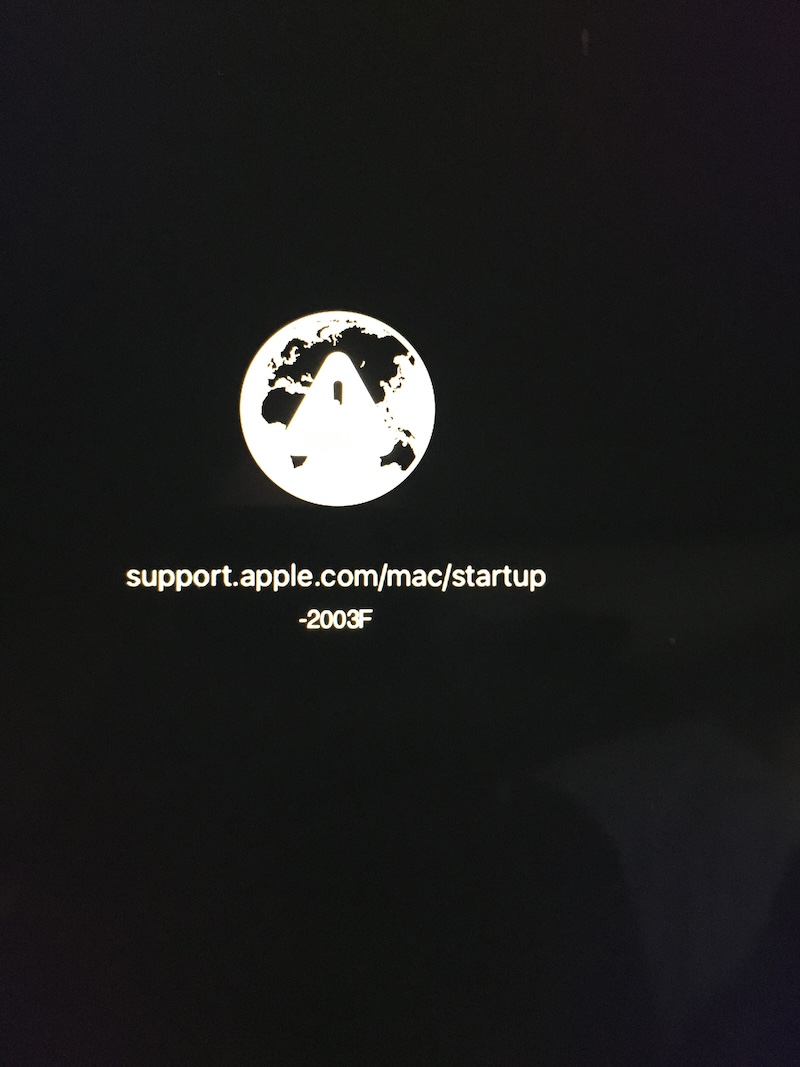

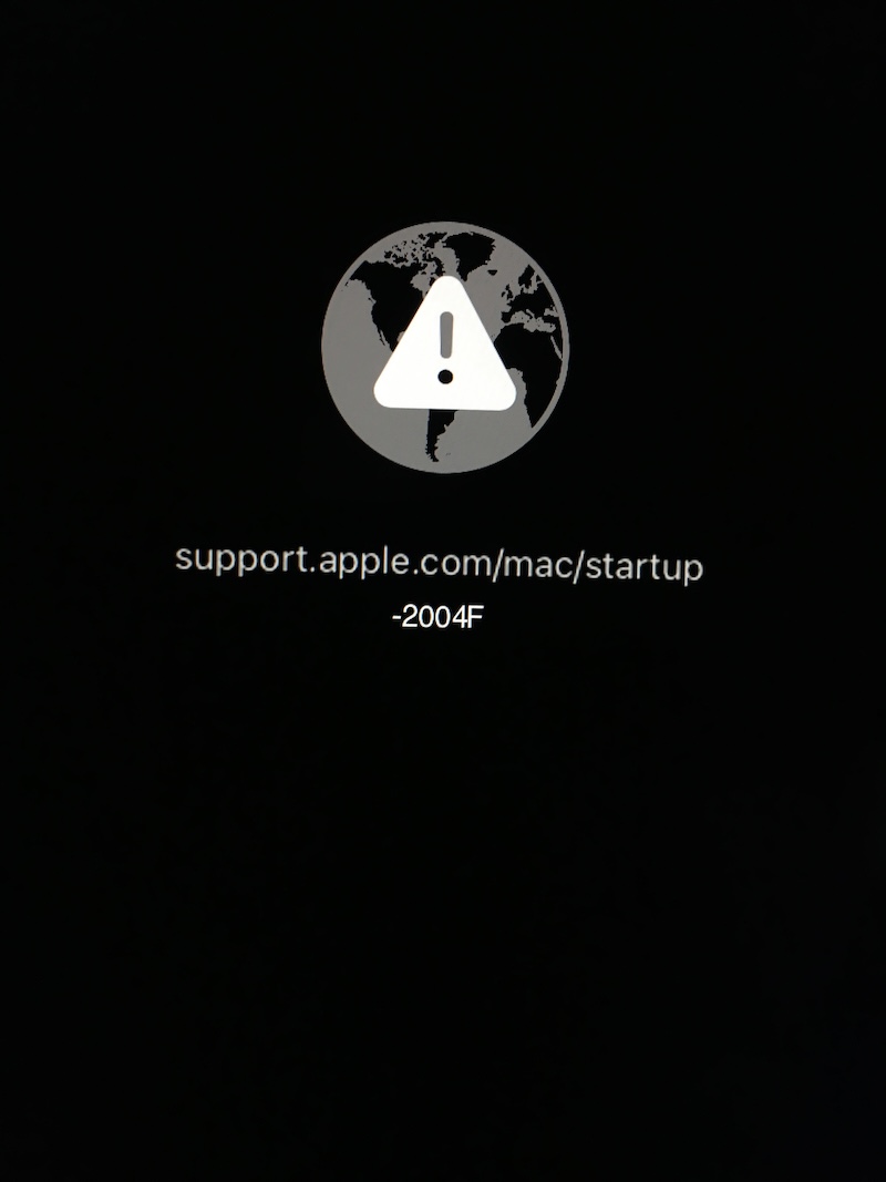

A search for error -2003F/-2004F comes up with this:
"The most common cause of... error -2003f is an unstable internet connection. The error message is usually accompanied by an image of a globe with an exclamation point icon over it, indicating a problem with the connection. That unstable connection is likely to be at your end. So, it could be a problem with your Mac’s Wi-Fi, your router, or your broadband provider. It’s less likely to be a problem with Apple’s servers.
...with an ethernet socket, connect that to your router...
That should be a more stable connection than Wi-Fi.
Reset NVRAM..."
Apple has a support document that deals with errors 2002 and 2005, which both refer to the same networking problem, but with USB connectivity rather than WiFi.

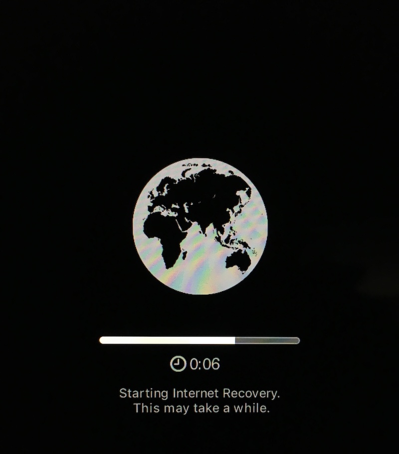

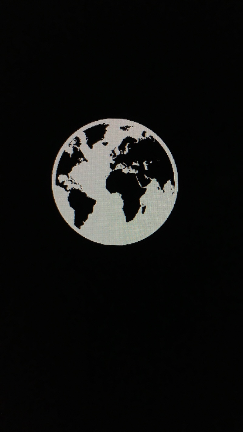

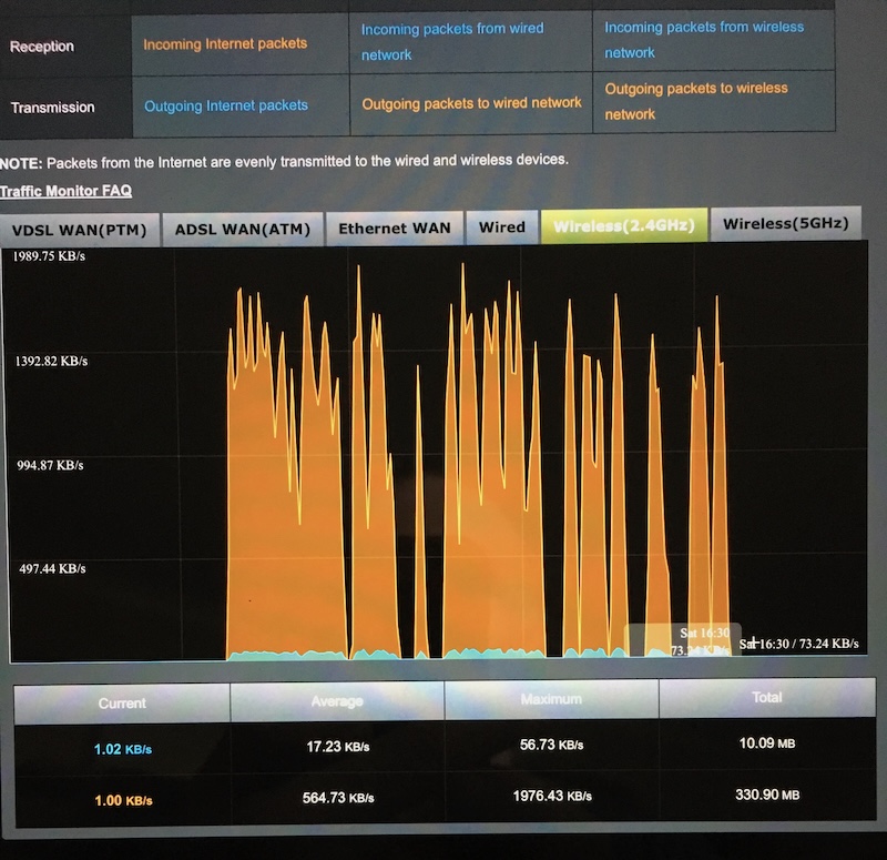

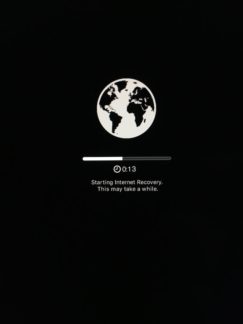

I have continued experimenting. Using ethernet, I looked at the router, and saw that it was basically idle.
And there was only the spinning globe.
Command-R
With wi-fi I get a progress bar. But it has timed out and given errors a lot of times. Also got a -2005F error.
Soooo close 🤣

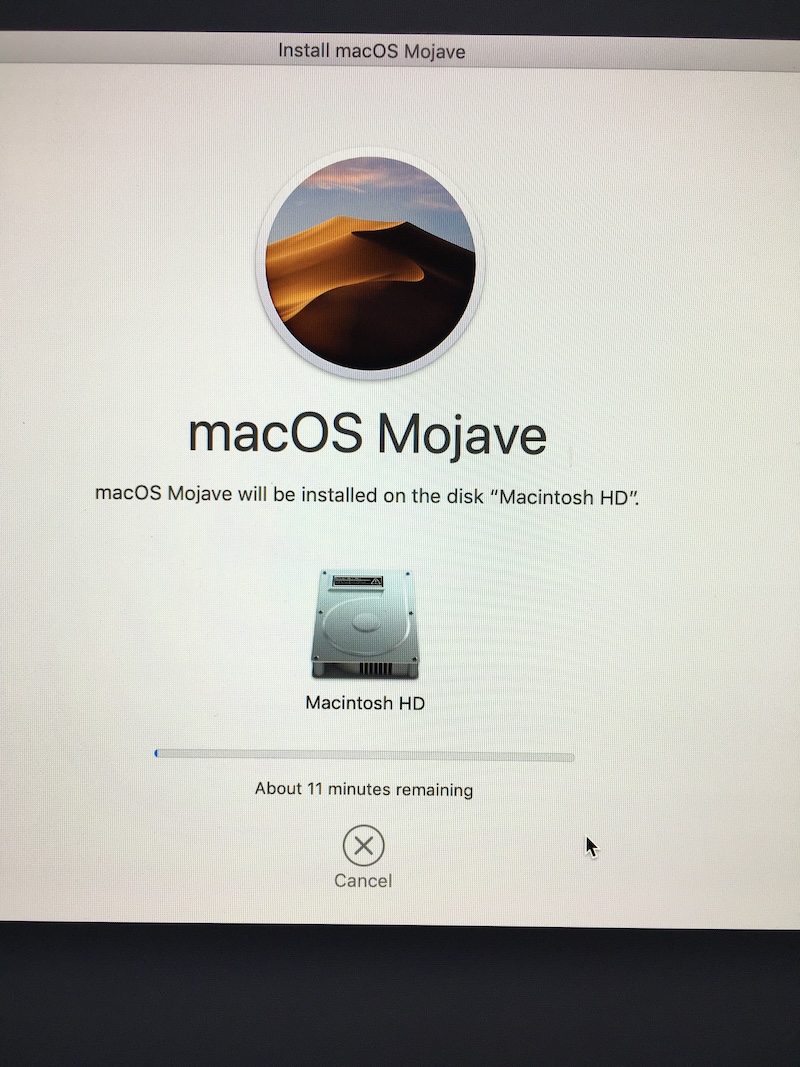

I did end up trying Shift-Option-Command-R multiple times. Figured I might as well try that, if it fails anyway. And I prefer an older macOS version.

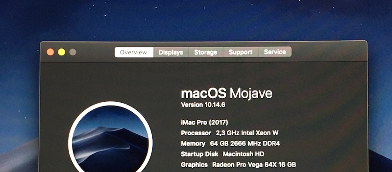

At last success. After having restarted the process multiple times, for the past 12 hours.
I can't believe it! In the process of installing macOS Mojave right now 🥰
If you try this, and can't make the Internet Recovery. Keep at it. Restart and try again, and again, and again

This machine had 18-core, 64 GB memory, 2TB storage, and Vega 64. But it felt to hot in the exhaust, compared to my standard iMac Pro.

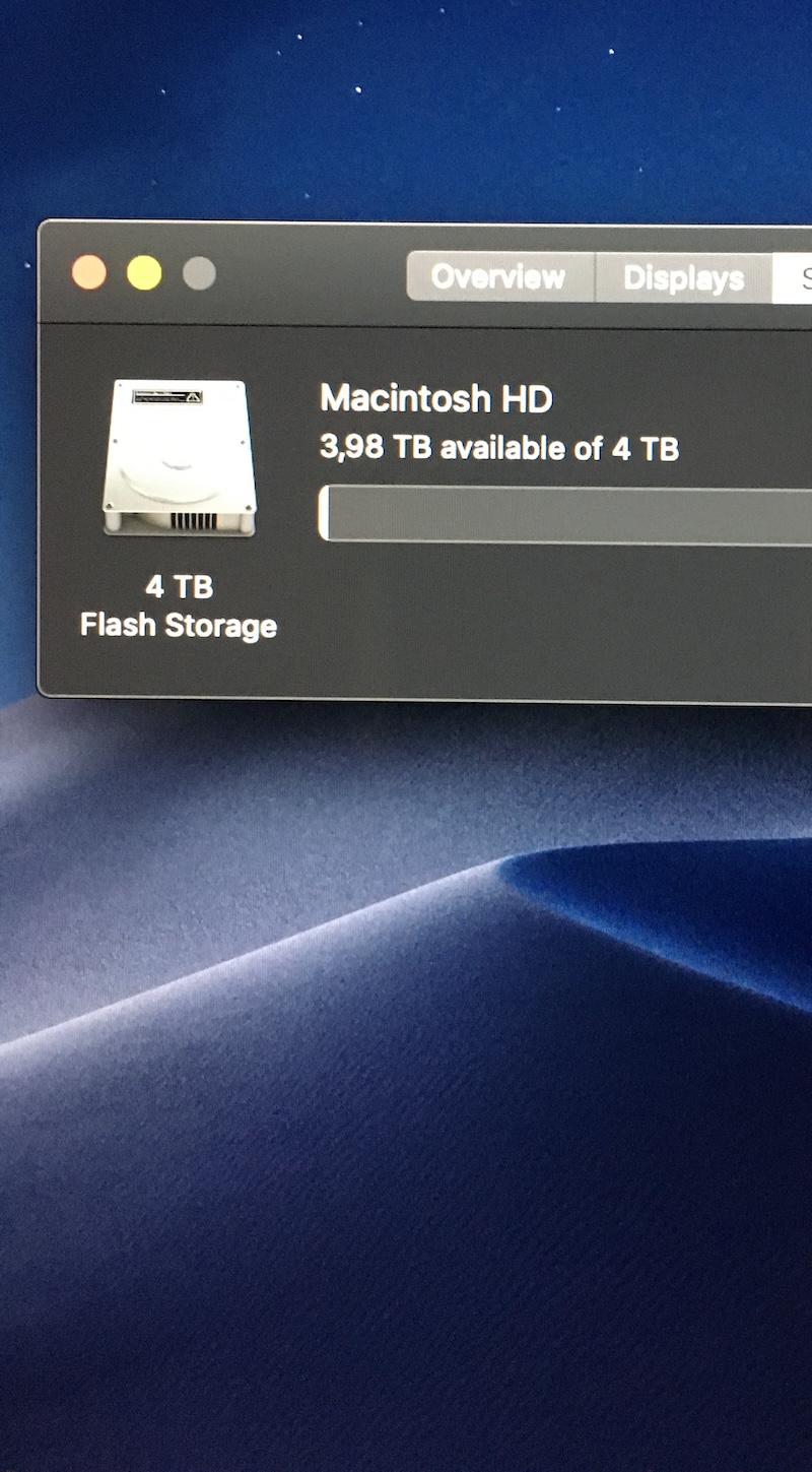

So I decided I should open it up. Remove any dust, and apply new cooling paste on the CPU and GPU. And upgrade the SSDs while I was at it.
It now runs cool, seems the temperature is normal when I check with my hand.
It has been quite a challenge. And I doubted this would end well. But it did !
