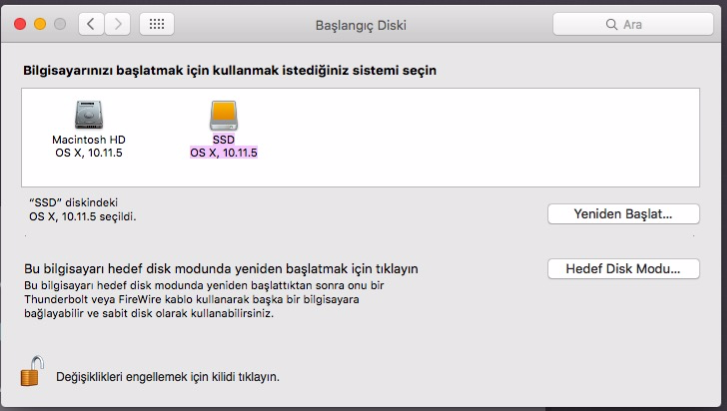

To the right of those two, is there ever a third startup option?

OK, thanks … so we should think about possible causes for the Mac sometimes behaving as if an OS that was previously valid (for startup) is no longer valid.
Is FileVault 2 enabled for one or both of the disks?
