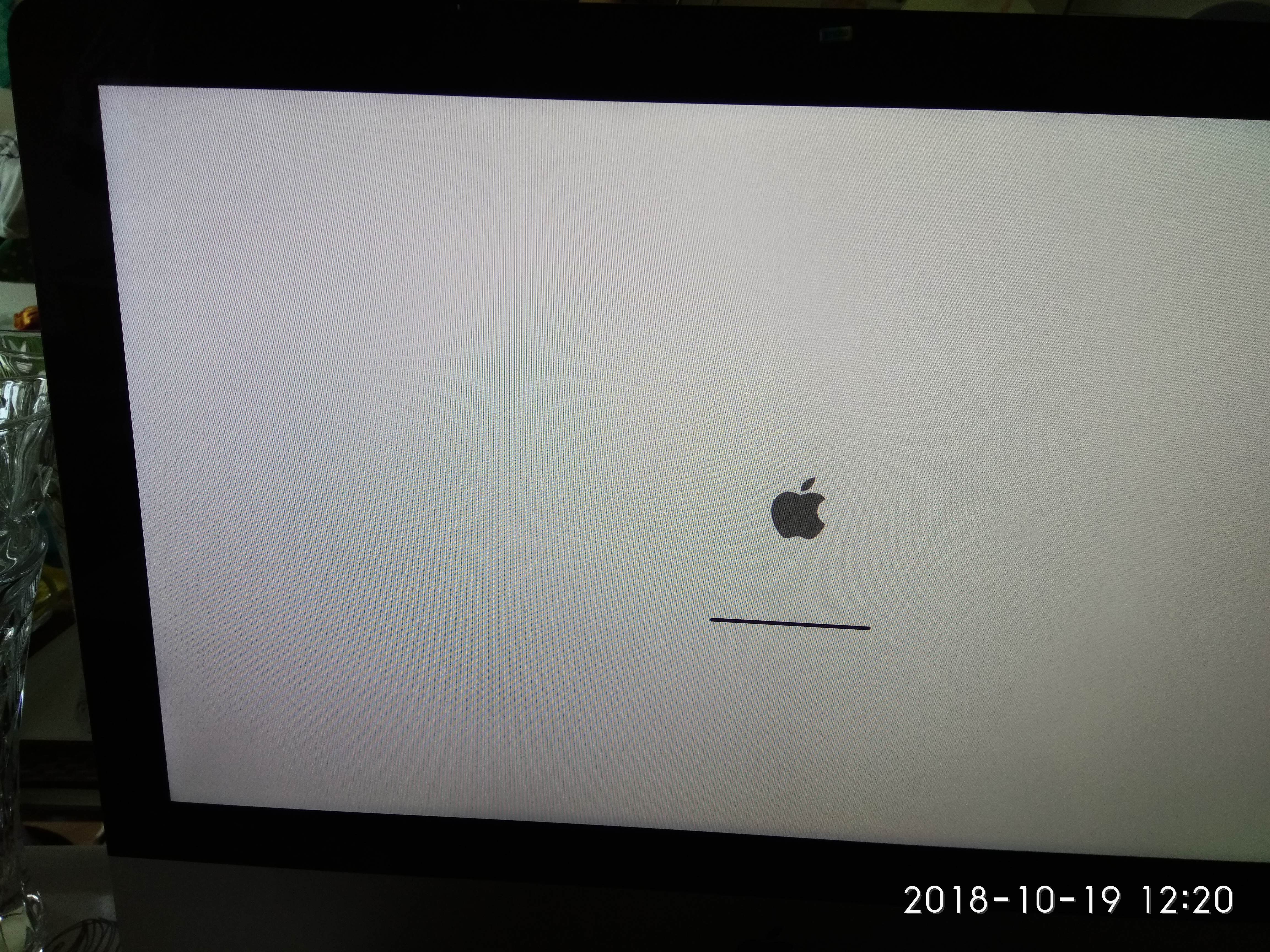

My iMac (2011 mid ) high serria stuck in Apple loading bar in 100% progress. It cannot log into login menu.
I did :
1. Cannot enter recovery and cannot enter disk utility by cmd+r
2. Can enter internet recovery but also stuck after download from internet completed.
3. Reset SMC
4. RESET PRAM...cmd+option+p+r .
5. CREATE USB BOOTABLE DRIVE AND PRESS (OPTION KEY ) TO SELECT USB DRIVE but stuck in Apple loading bar again.

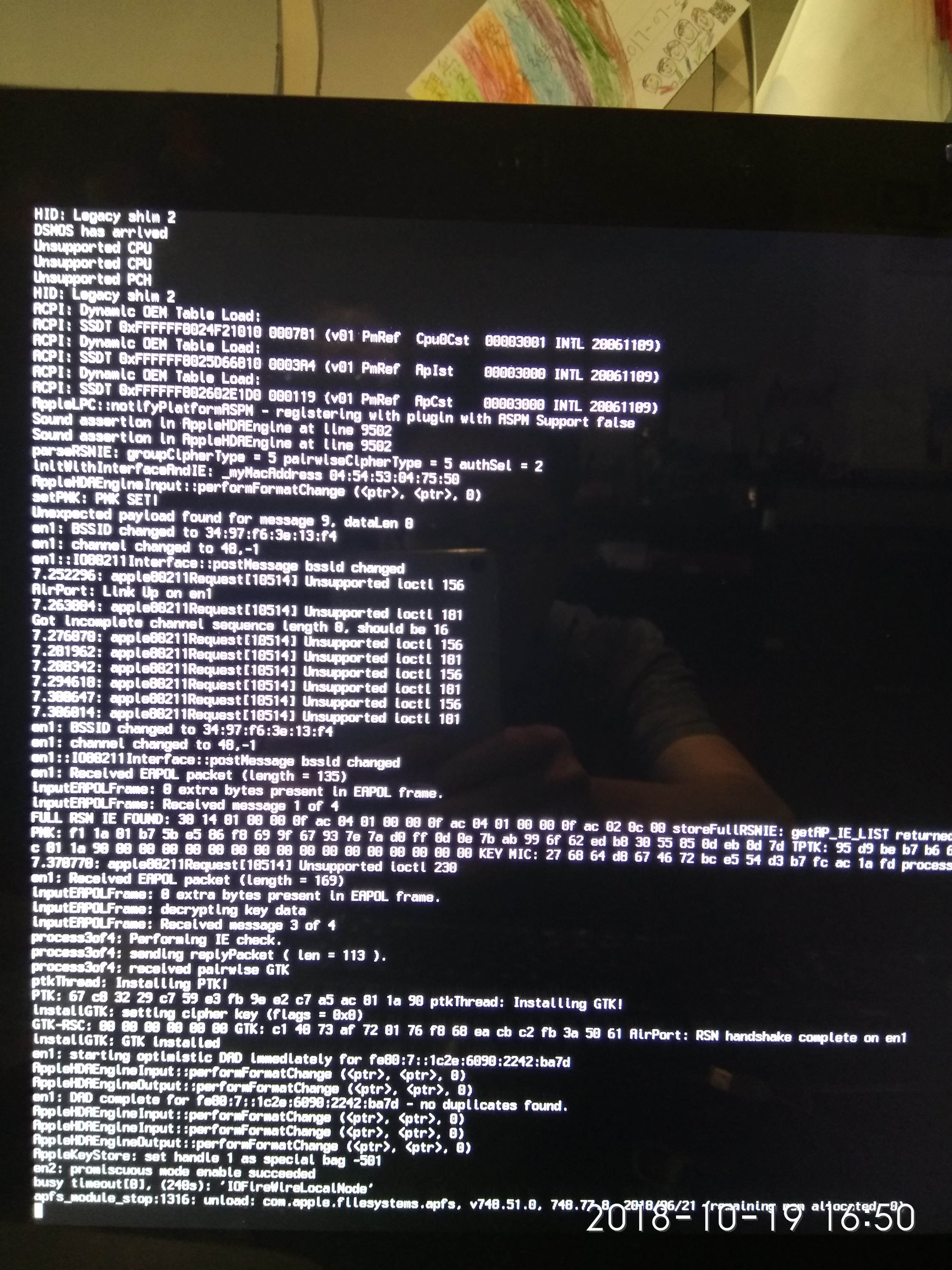

Then, I use cmd+v to verbose mode and see the log with screenshot provided.
Friends, what can I further do ?
Thanks....

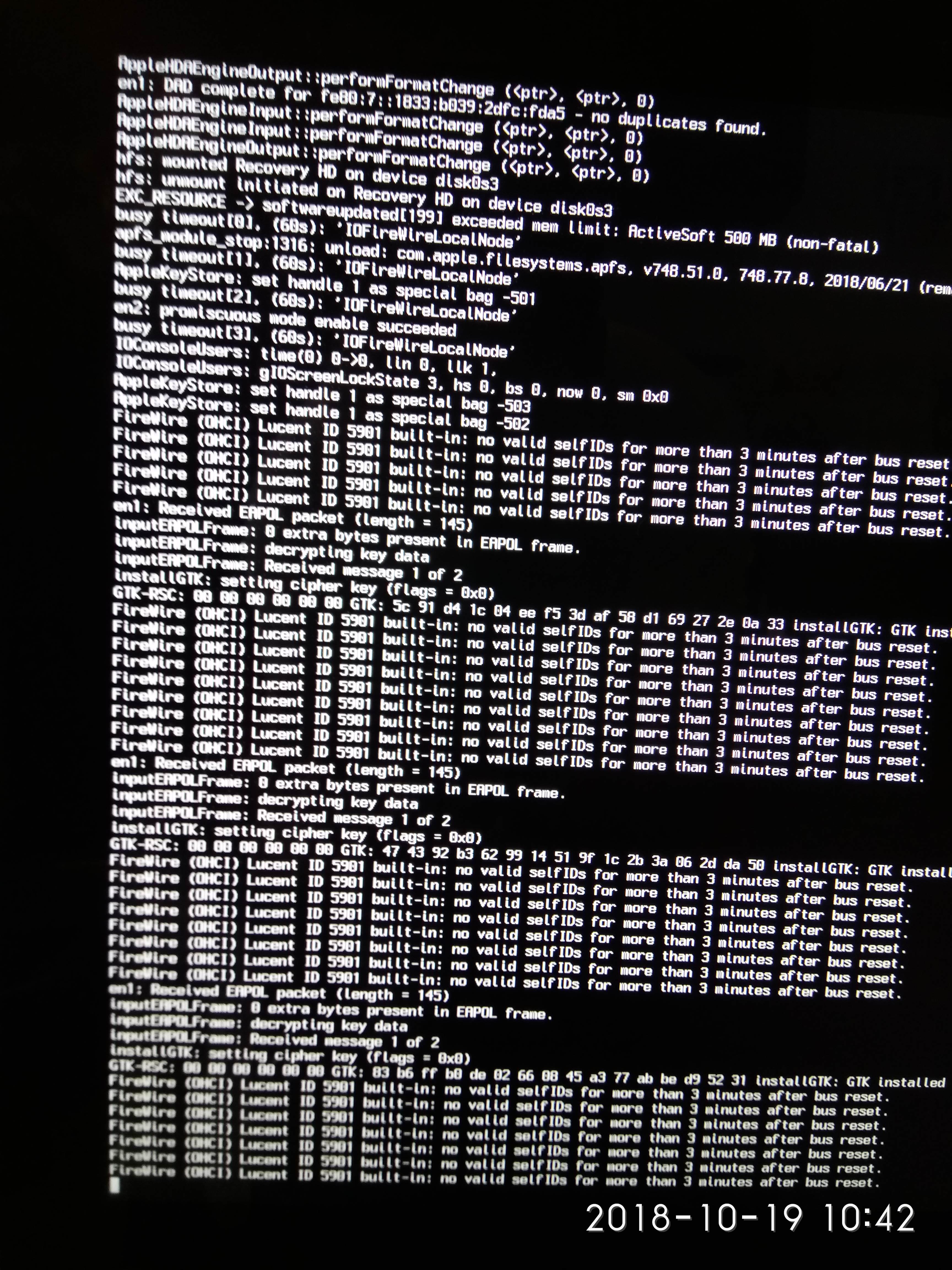

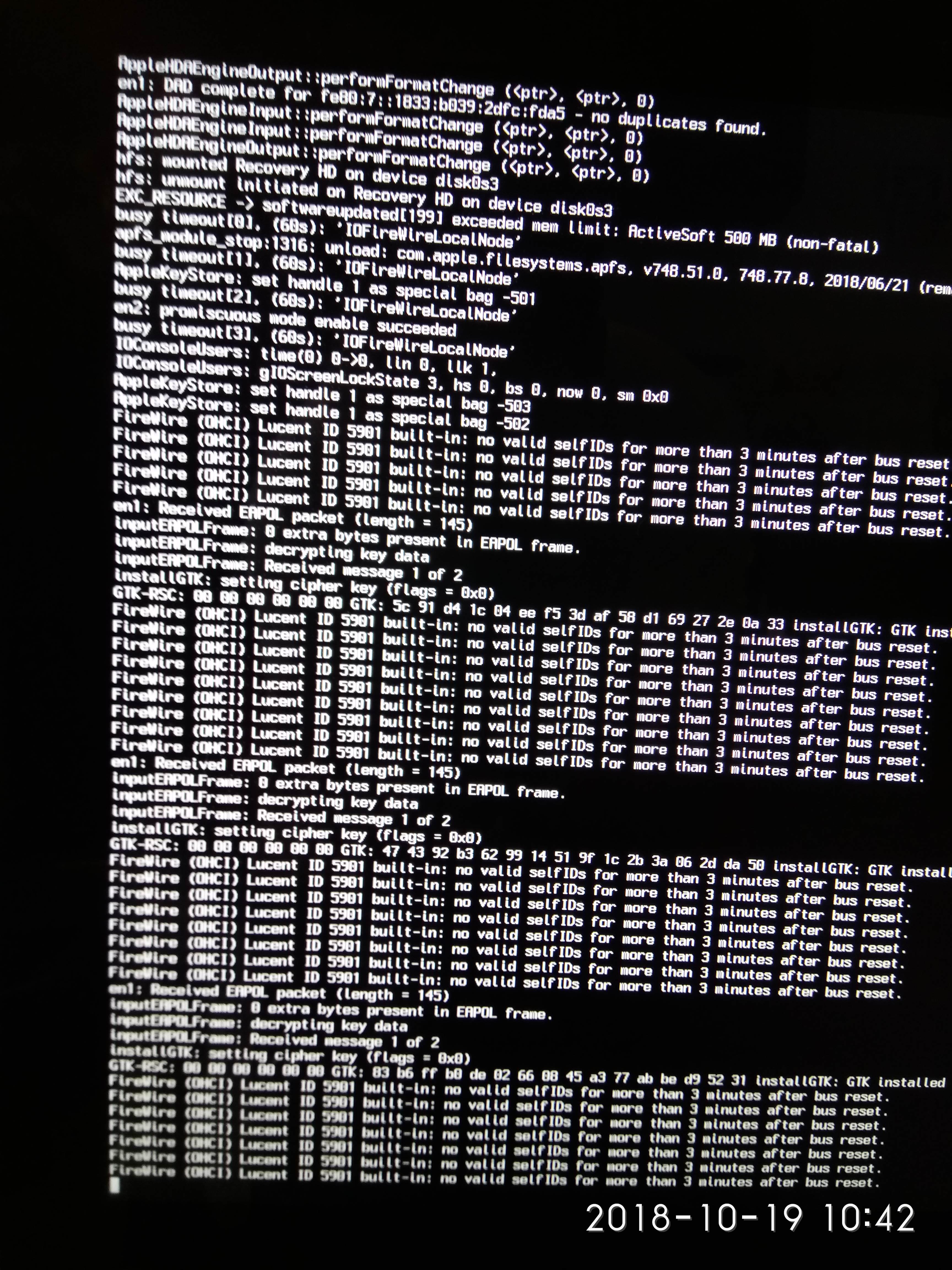

Thanks...more info...
The verbose screen log was changed after reset multiple reboot.

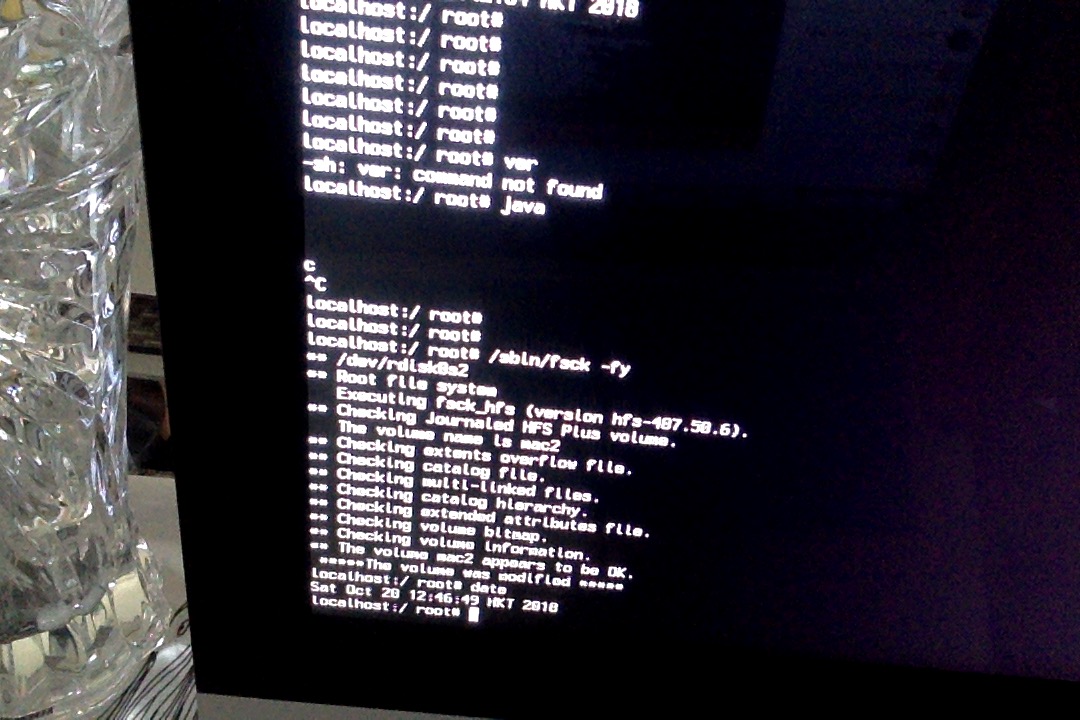

I think it's not the battery problem because i can enter the single-mode (cmd+s) and check the system date. it's correct.[see screenshot]...
