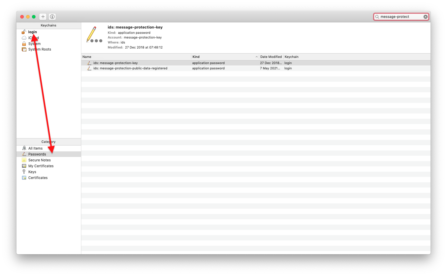

@Omega Mac Success not guaranteed but try the following:
  1. Launch Keychain Access
  2. Search for message-protect entries under the login keychain and delete them.
  3. Try logging into Messages again.
Thank you very much for this possible solution. It is not one I have come across.

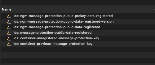

Oks, so what I have found is "container-message-protection-key", looks to be the same thing, so shall I delete?
@maverick28 - Hmm deleted that one, then logged back into iMessages, there are however
more on my system, all are iCloud, see attached image - perhaps I should delete the lot?
Yep still no idea how to fix this.

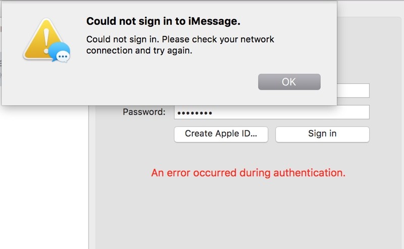

Just a couple of days ago everything worked fine on my Mavericks machine.
Today I discovered that I cannot send messagaes (red exclamation mark next to them) neither can I receive messages.
I tried to sign out and now I can't sign in. On the phone everything is working fine.
Oops, sorry to post it in Catalina thread, was misguided with the thread title.
Mine is working in Mavericks, just checked by sending a test message to myself. Have you 2F authentication enabled for your account? If yes, then have you put the verification code to your account password's ending? If you have and still no dice, perhaps, it's iMessage server outage in your region. File the report to Apple under the "iCloud" section of their product feedback site and rate your satisfaction low.

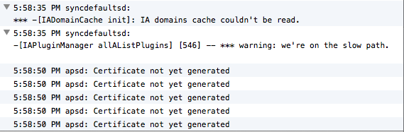

Here's a message from Console if this is of any help
