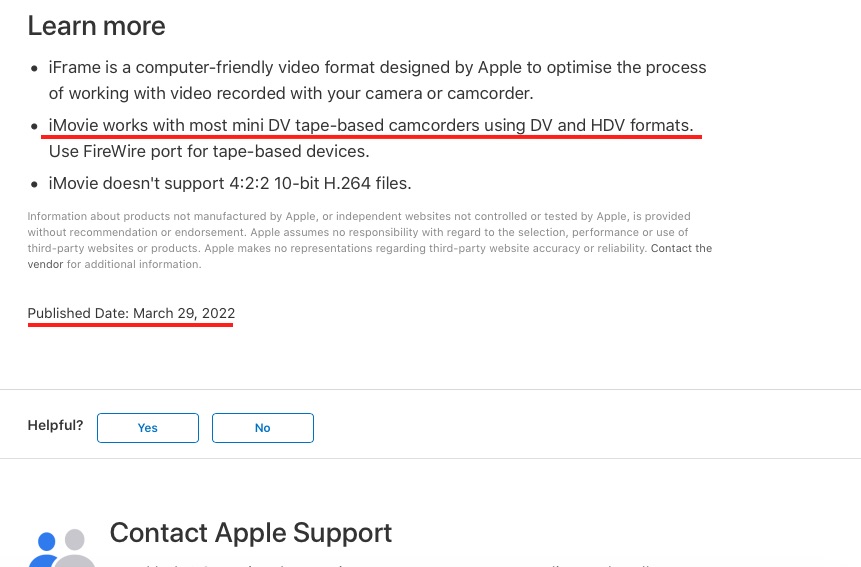

I have filed bug a report with Apple. It appears that none of the Apple software and other products where input from an external camera is an option would be affected. Lifeflix as an example and they must be concerned and hopefully will add to the noise. I am attaching a document someone sent me and as it is recent I am hoping it is an indication that Apple intends to continue support? I really appreciate your help on this issue which is very important to me.

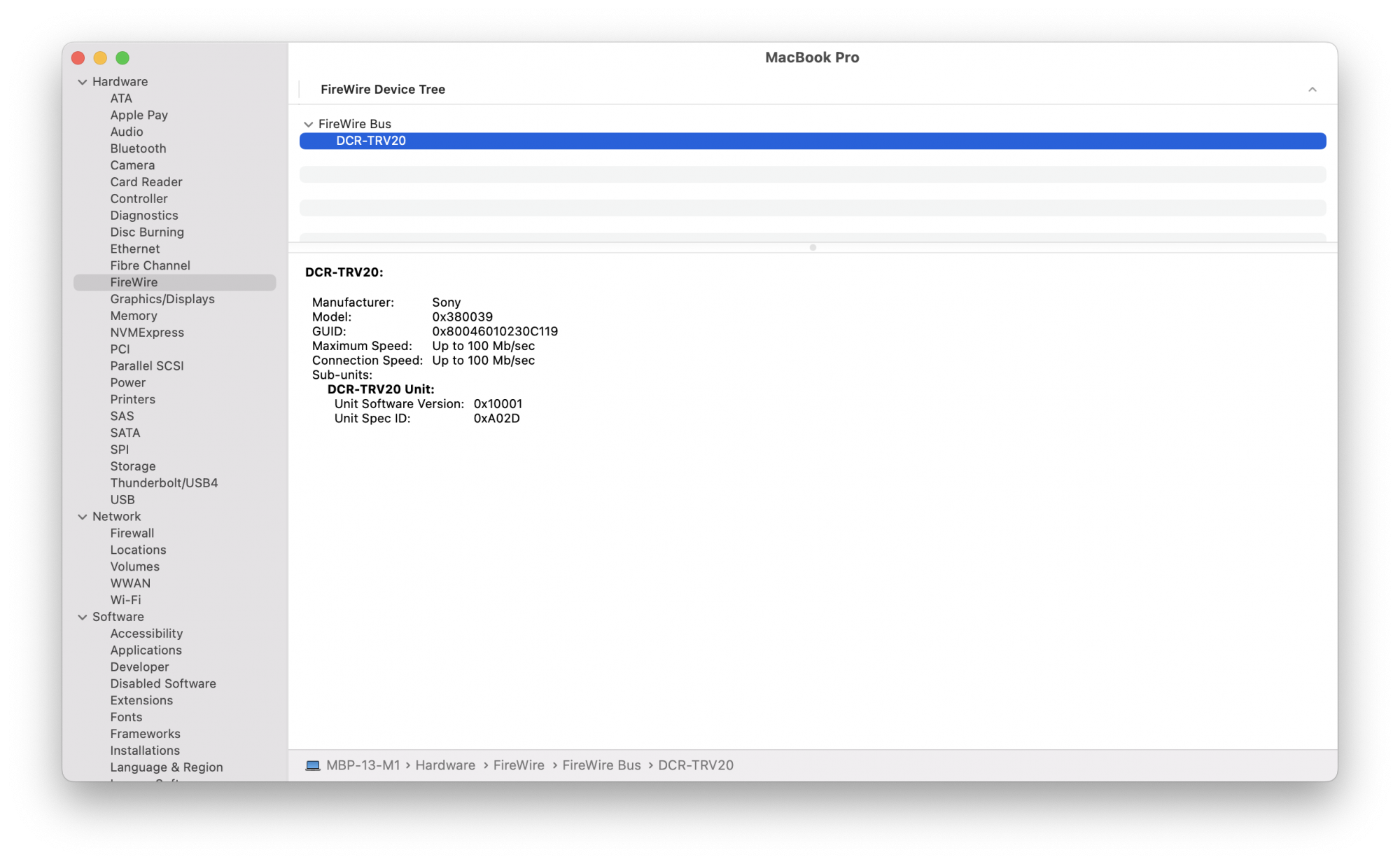

No and No. As mentioned, the device only shows up in the System Profiler as in the screenshot below, but no apps can access it. This is on an M1 MacBook Pro running 12.3.1.
