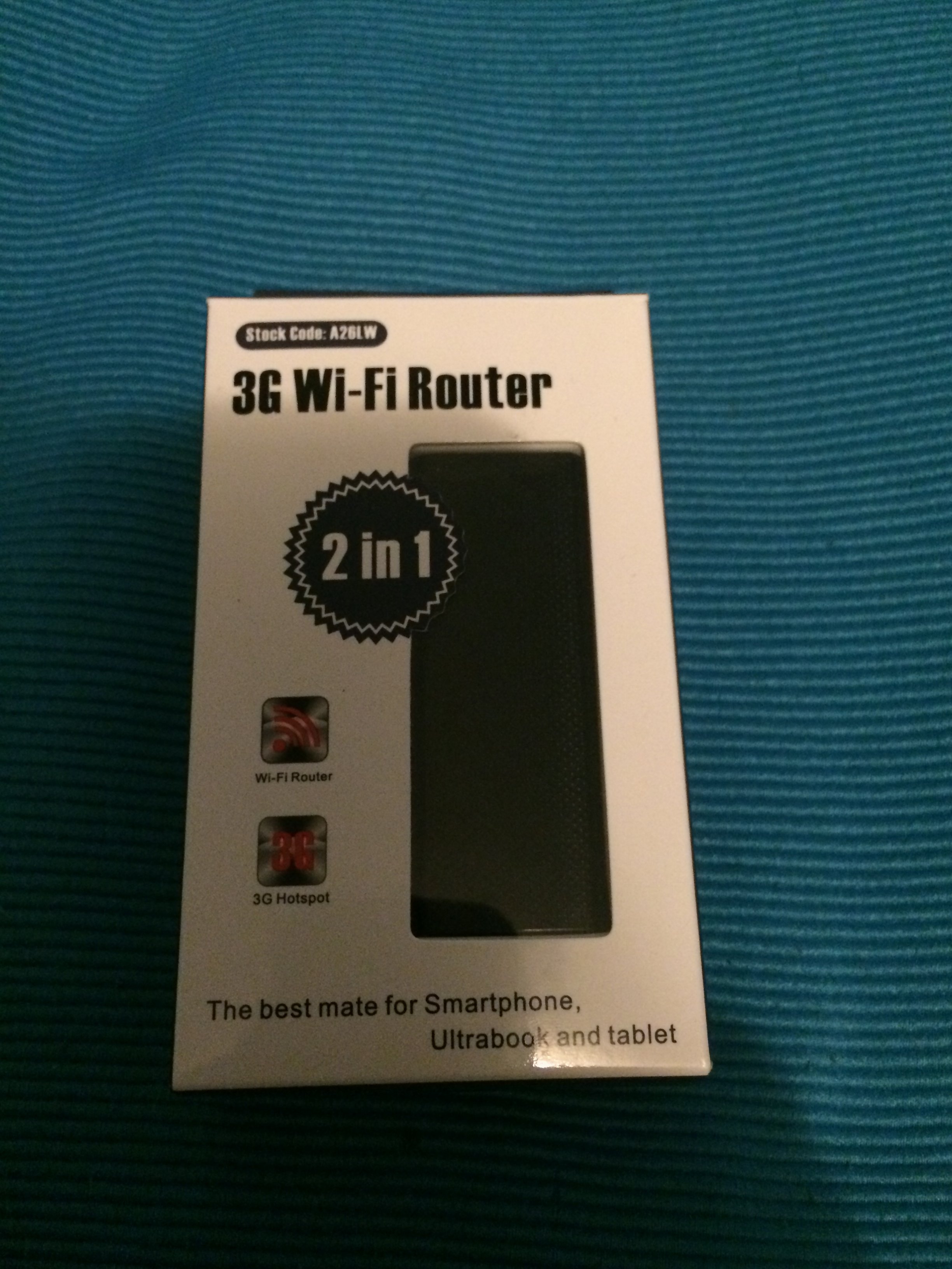

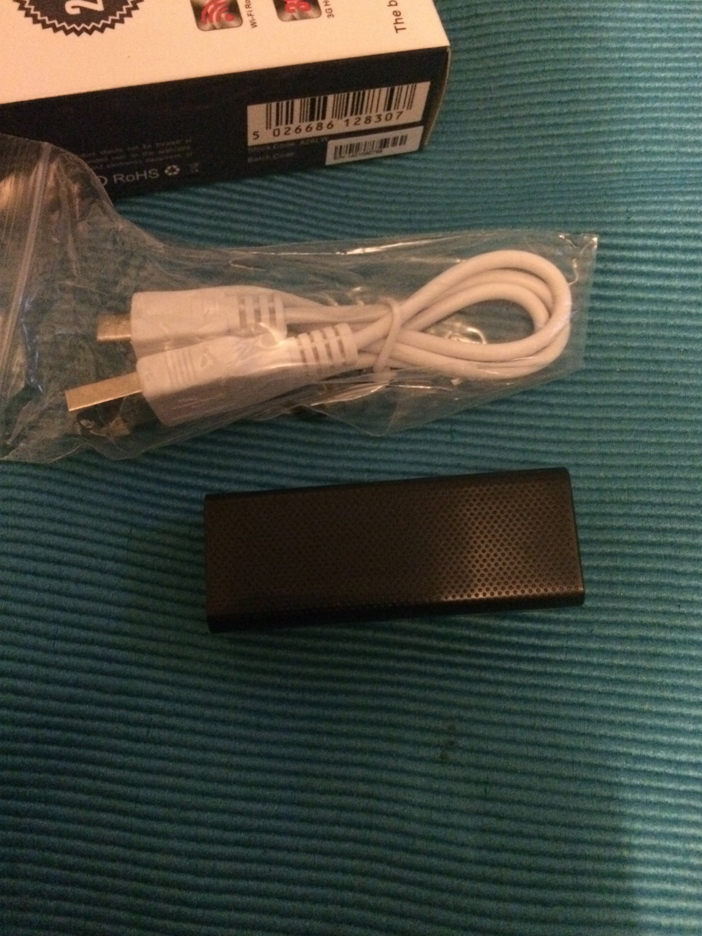

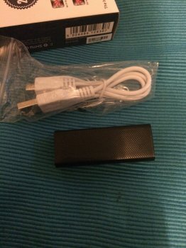

They don't exist for WLAN cards. Your two options are mini PCIe to PCIe or something like the item below, which is a portable 3G/WiFi router. Tiny thing about 2cm x 6cm and weighs nothing.
The advantage of the PCIe solution is native AirPort WiFi. The advantage of the latter is that it is OS independent and will be seen as a LAN connection by Leopard. Both are cheap solutions. Personally, I would go the PCIe route as I did in mine and save the router option for older machines that run OS9 if you need a network connection for that.
