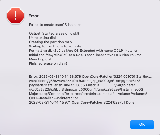

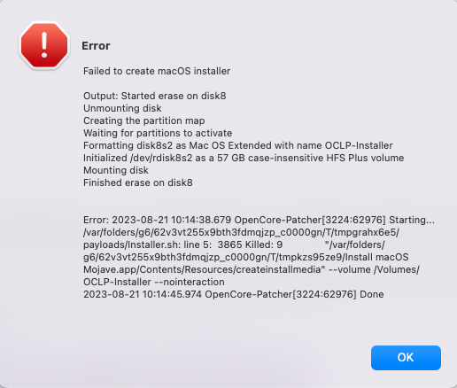

I managed to download a Mojave installer, but OCLP aborts creating an installer, resulting in this error:

OCLP is designed to work with Big Sur or later, not Mojave.

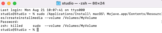

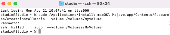

That's strange. When I use the exact same code, I get an error: "zsh: killed"
Where did you get your Mojave installer from? Maybe mine is broken somehow. I used the macOS Mojave Patcher Tool from dosdude1.
I used iTerm2 (a Terminal like app) to run the code. Come to think of it, I have seen that "zsh: killed" error message but can't remember where or why. I connect the target USB via an Anker adapter connected to the MBA via USB-C.
Can you search for some info on that error message?
I downloaded both HS and Mojave installers using MDS.
According to the OpenCore install guide it is because I'm on a Mac, that does not support Mojave.
Note for users on Apple Silicon installing macOS older than Big Sur: If the createinstallmedia fails with zsh: killed or Killed: 9 then it's most likely an issue with the installer's code signature.
Since MDS is a payed application I will hold off until I know it will really solve my problem.

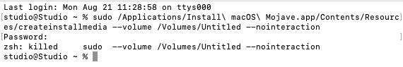

Alright, I downloaded OSX using the trial version of MDS. The terminal command still won't work: "zsh: killed". So it was not a broken installer or anything. MDS also offers an option to create a bootable installer, but that fails as well.
So I don't know what it is that you do, but there must be something else involved, cause the whole internet says, it is not possible to create an bootable installer drive for an unsupported OS on an Apple Silicon machine (as far as my research goes).
I have made one High Sierra USB install disk using the command shown previously, it boots a MBP fine, installs HS fine too. Where are you located? I am in Japan, so if you ever get over here, drop me a line and I will pass a HS USB over to you.
How about using OCLP to make a Big Sur USB installer. Can be done all in the app, just need a 16GB USB formated as GUID HFS+ and named Untitled.

Copying boot files...
Install media now available at "/Volumes/Install macOS Mojave"
Eneco
macrumors regular
Jul 1, 2018
142
23
Thanks for all your suggestions and help. I really appreciate it.
In the end I managed to track someone down with an old Mac and was able to create a bootable USB drive and install OSX Mojave on the Mac Pro. So everything is fine now.
Again, thank you very much for all your input.
