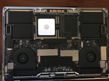

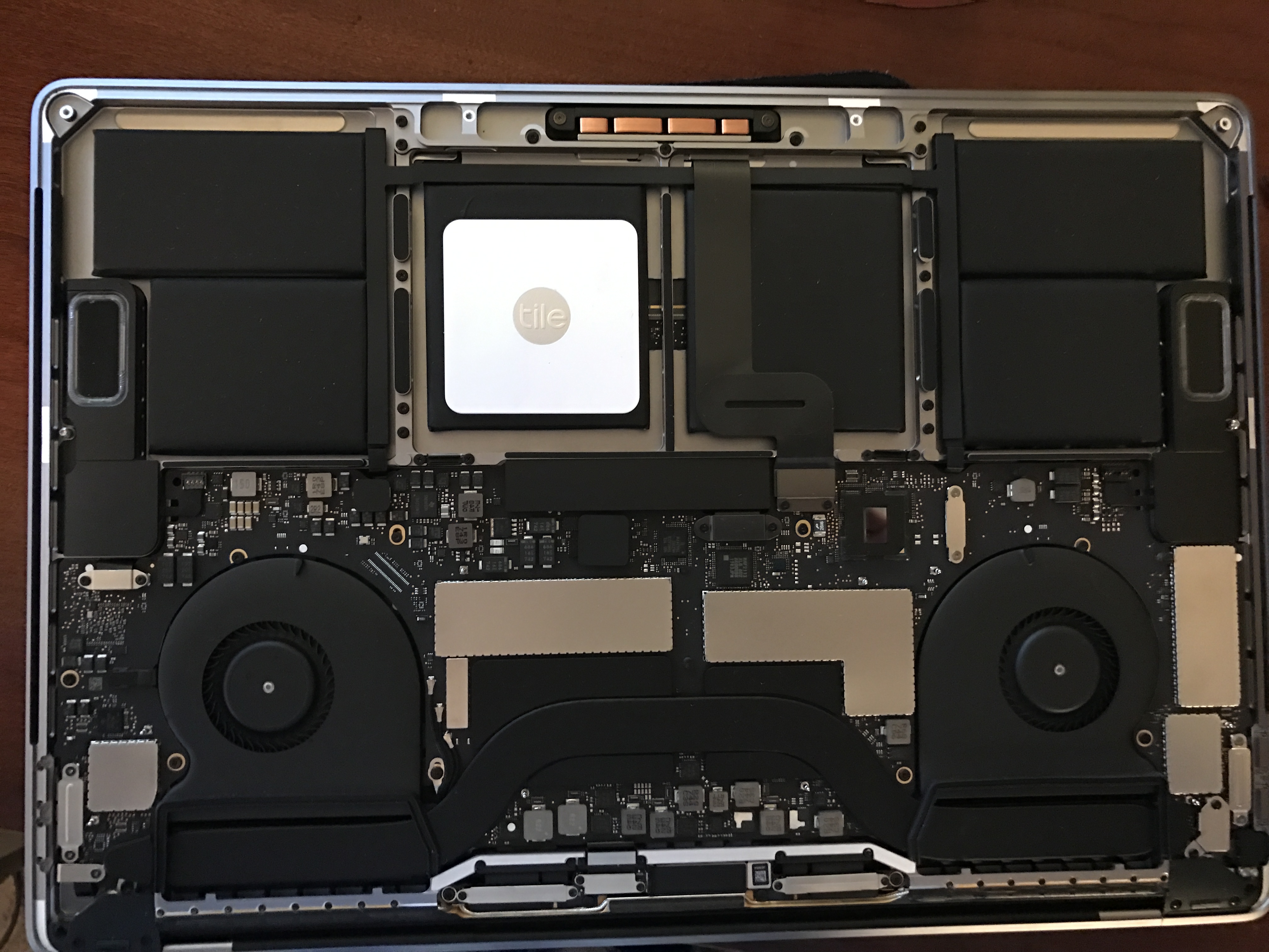

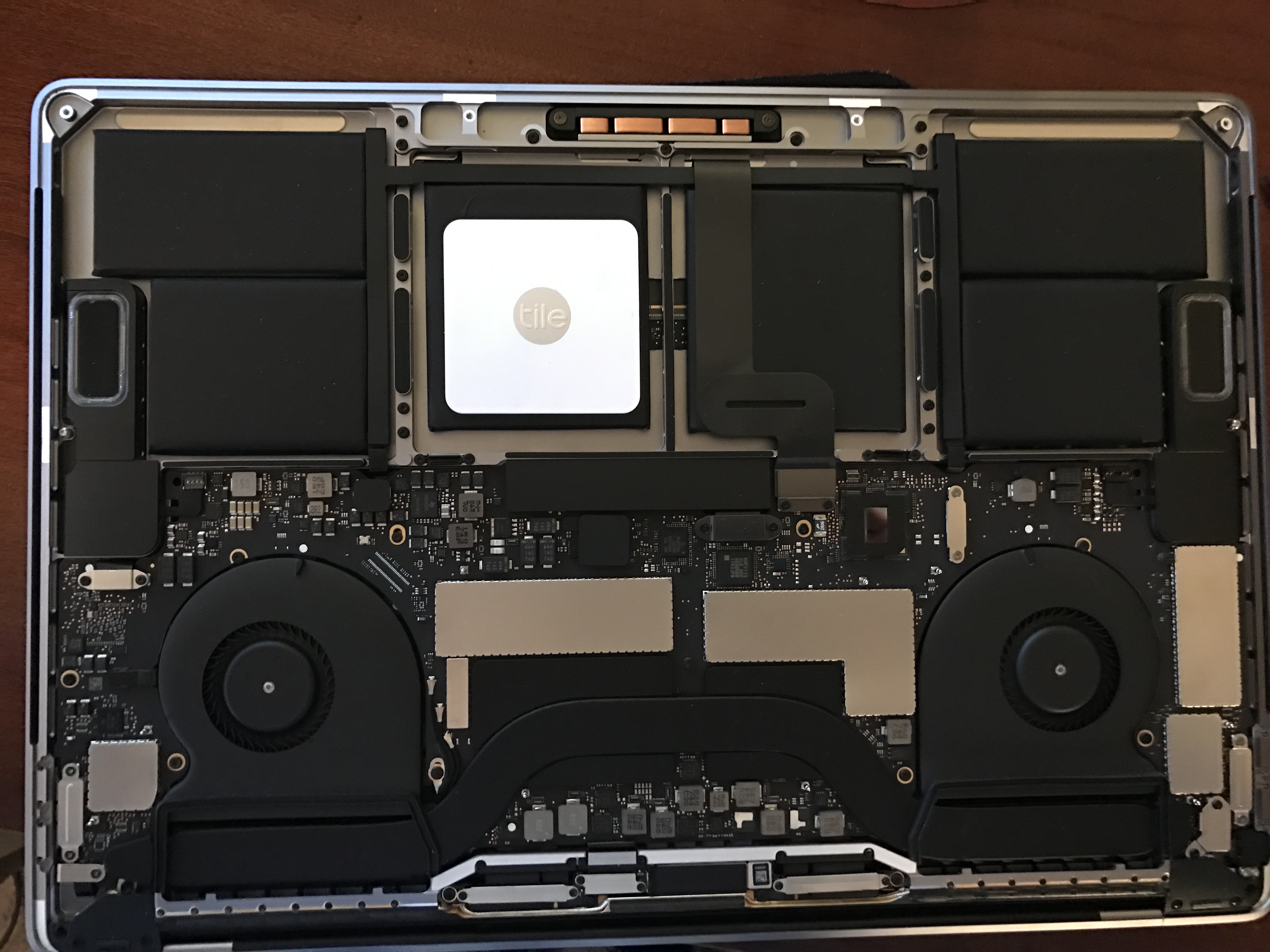

It fits. I installed it - so far it's working like a charm.
As a note, I will let you know if it affects signaling of any kind.
Is that one of the batteries to which you attached it?
Does it attach with some kind of adhesive?
Looks ok, but I'm wondering -- if there is an adhesive used -- could it "react" with the outer surface of the battery, and break it down? (could be an unwarranted concern)

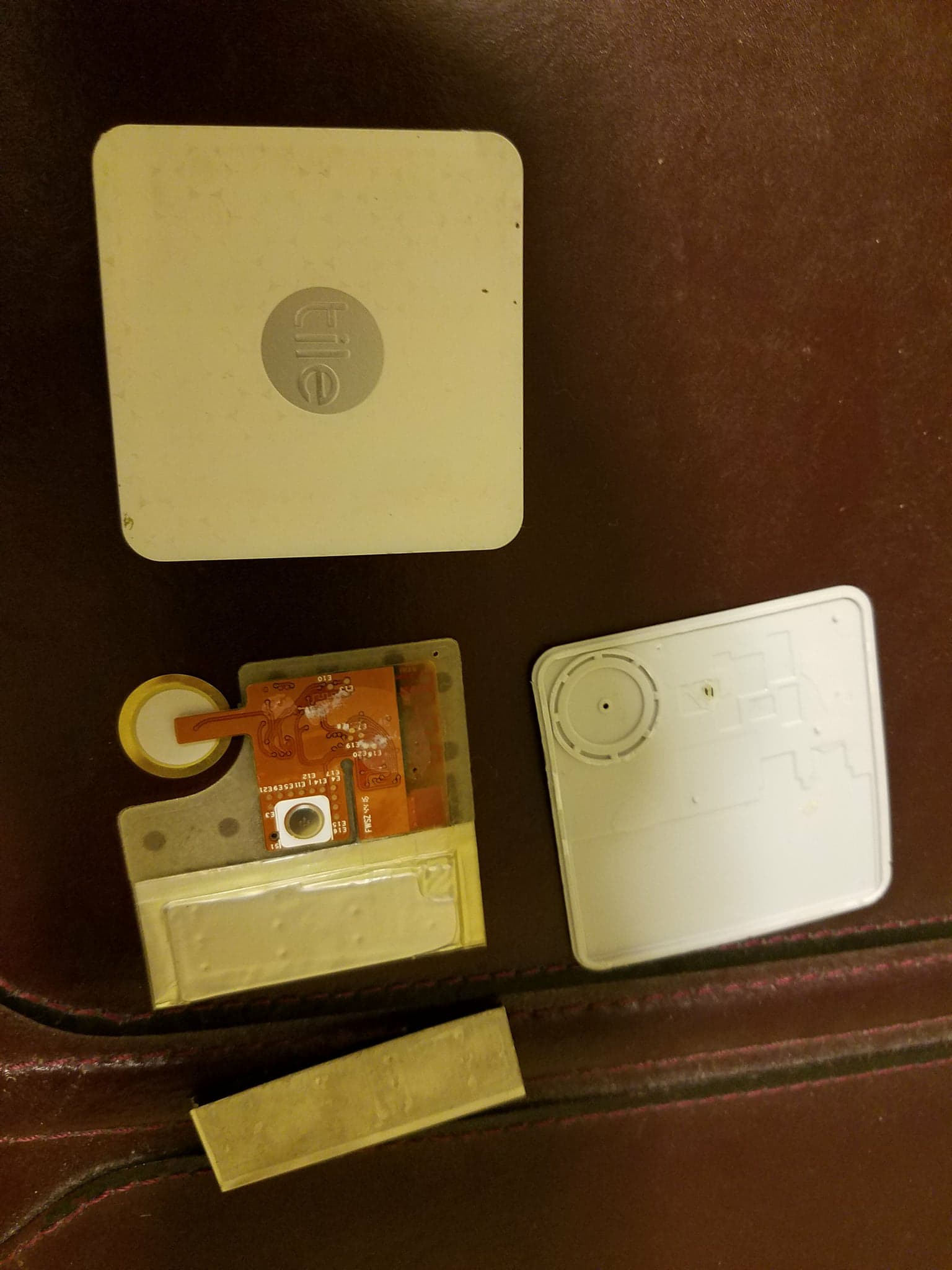

I think its a great idea. bluetooth interference: NO. Try using 5 different devices all connected to bluetooth next to each other. Works fine, doesnt it? my digital calipers say its only 0.09 inches thick. Would be clever to house it close enough on the right or left to get the sound to travel though the holes for the speaker (if needed in the final step of locating)
Further more I may even open my old tile slim that I need to replace b4 installing it to see if it could take up less room. no need for the plastic cover. I plan on talking to a few more computer science friends b4 opening it up.

its ridiculously small now, and it still works!
