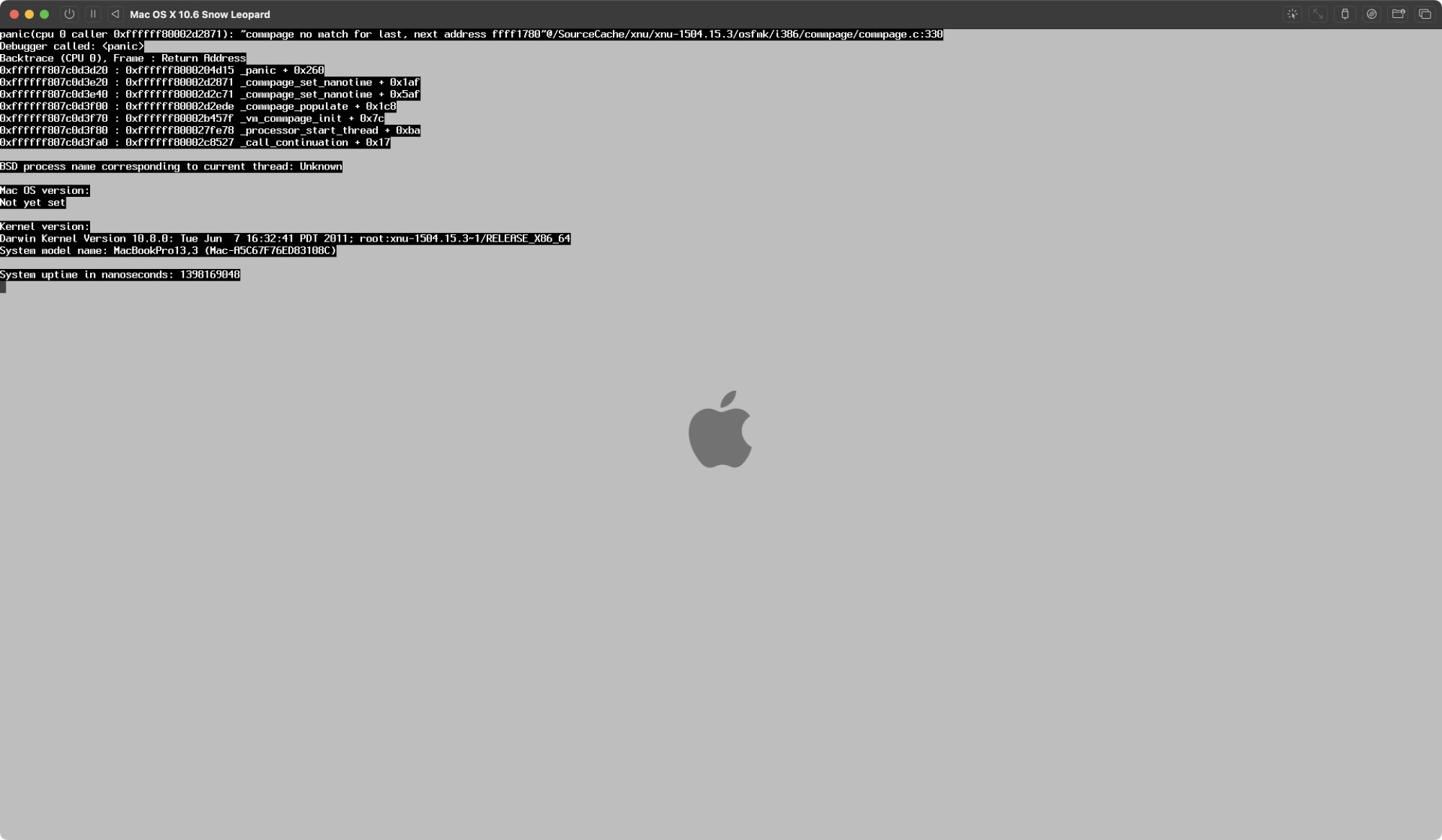

royalgraphx noted that "all I really need to explain is that for some reason the various KP's that users experience when attempting to first boot or install Mac OS X Snow Leopard on M-Series Macs such as the Commpage or Installer KP are results of some weird TCG/32-Bit emulation errors." and "Leads me to believe that the installer uses various older parts for 32-Bit cryptography while installing, and the commpage error mainly being the CPU being weird, as in, how it appears to the guest machine".
So, basically a fresh install for get around an issue with the Snow Leopard Installer, "It does not have any sort of username or anything, its literally right after install and reboot, so... basically I have to share this macintosh_preinstalled.img to you guys on Apple Silicon Macs, just in case you do not have an x86_64 machine available to you."
I can get that to boot just fine in QEMU, using royalgraphx's instructions at that beloved link, it's only having issues when bringing that into UTM. I'm thinking it's something to do with emulation on the Apple Silicon Macs. I'm not sure if anyone has gotten Snow Leopard to run in UTM on Apple Silicon, but this seems to be the closest I've seen.

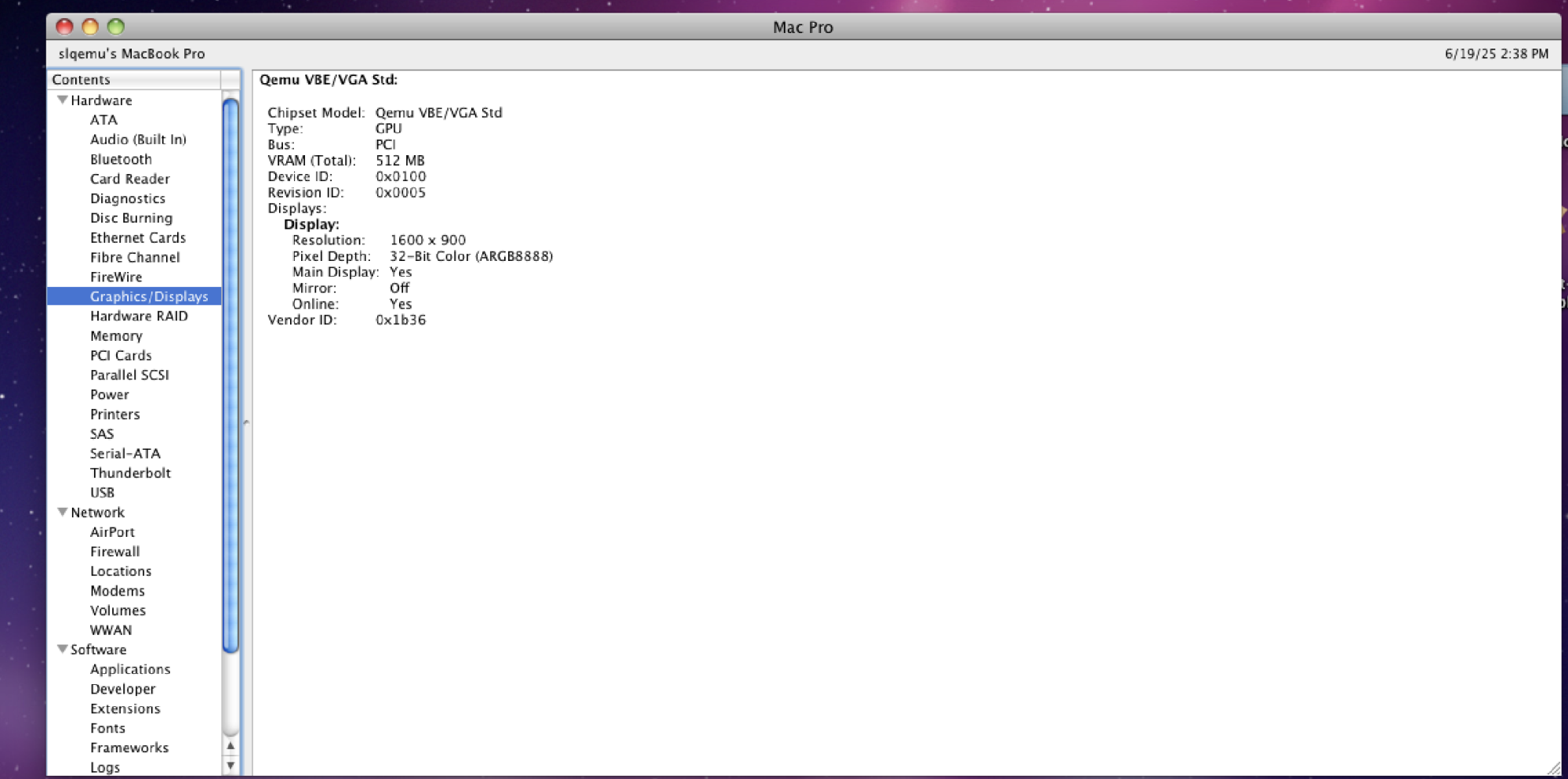

For Snow Leopard it will give you the same acceleration as in UTM. For Mavericks it gives me 256MB VRAM by replacing:
Code:
-vga none
with
Code:
-device VGA,vgamem_mb=256

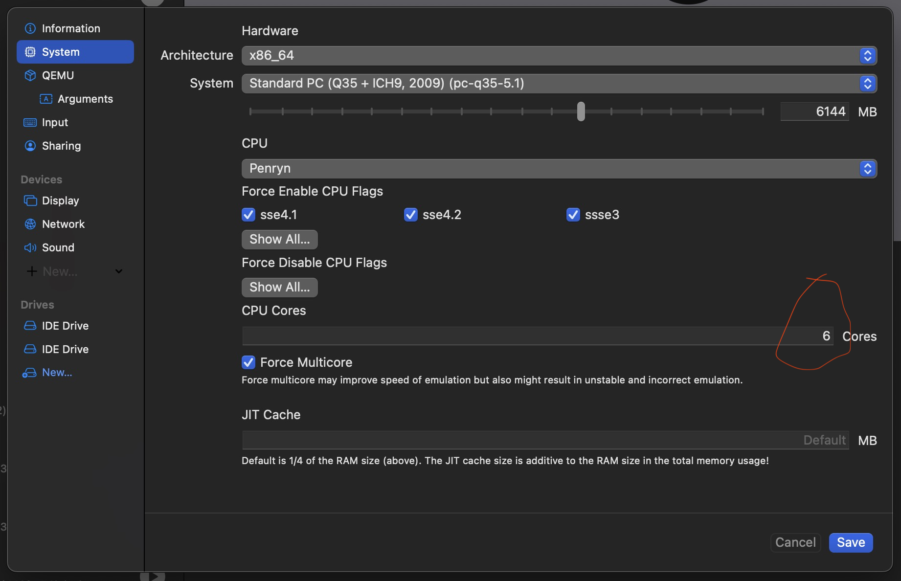

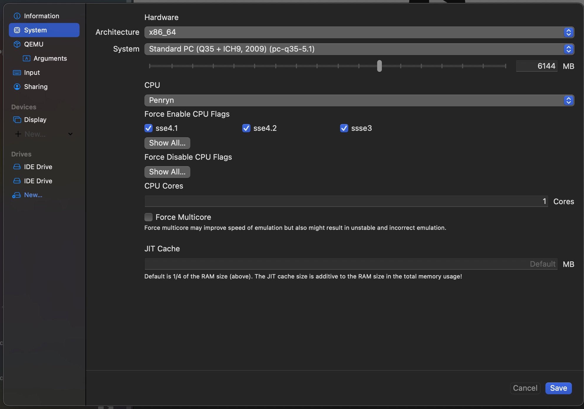

Don't use more than 1 CPU for SL to avoid random crashes. Attached is the config file for the UTM.
  • config.plist.zip
