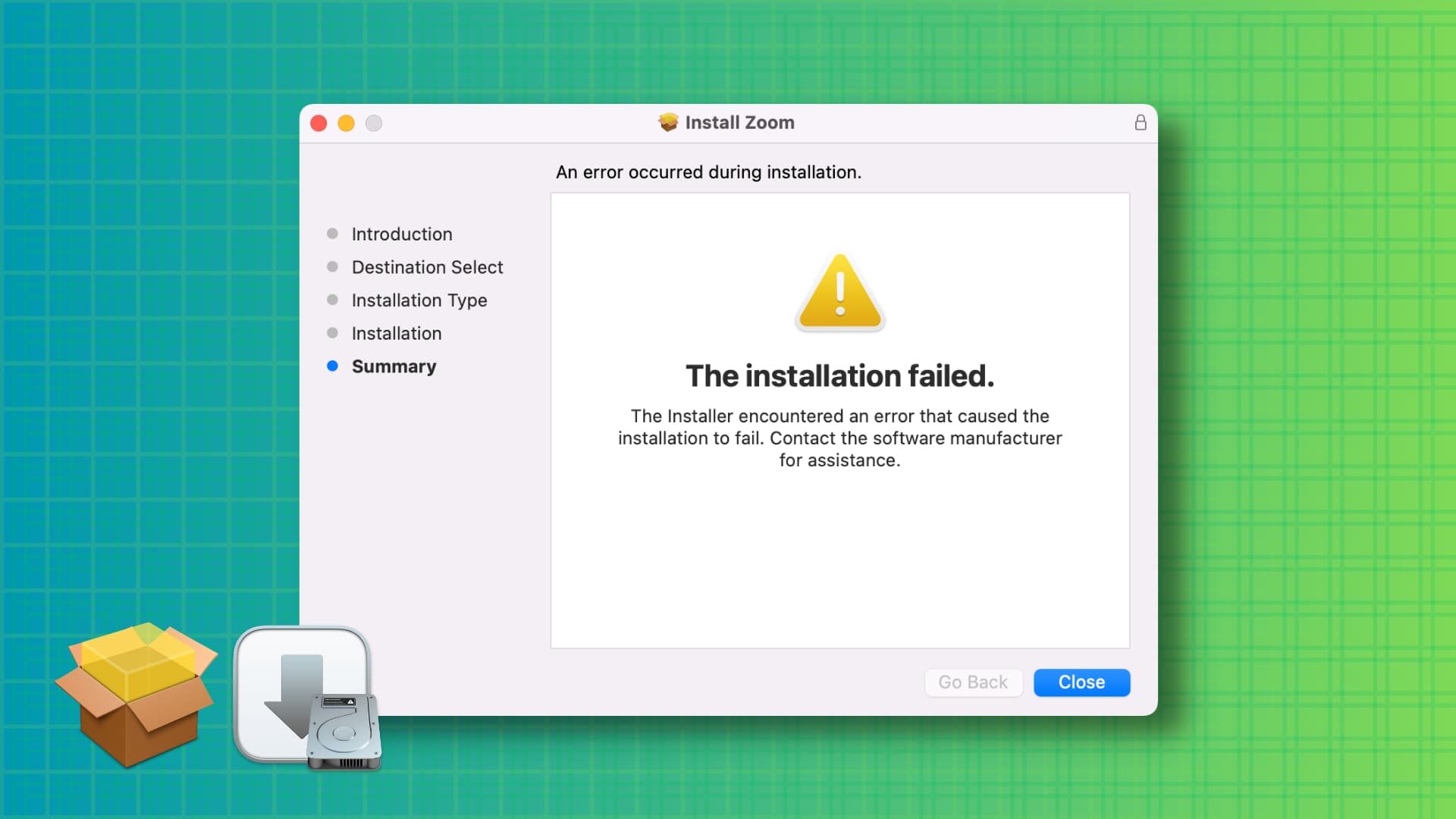

I had the zoom pkg file downloaded, and moved to Application folder before double-clicking for installation. This time, it worked. I want to share with Mac users here and hope it helps.
This works. Thanks! But Apple needs to fix this. We shouldn't have to have a workaround to install software.

Hi All, returning to this issue as I have just started sharing the same problem. Anyone found a permanent solution? I chatted with an Apple support person today and they suggested that a VPN or third party software could be causing the problem? I don’t believe that tbh….Meanwhile I’ve just been doing the Full Disk Access thing, but even that didn’t work for one particular pkg installation earlier today….I suspect a return to Monterey may be on the horizon…..

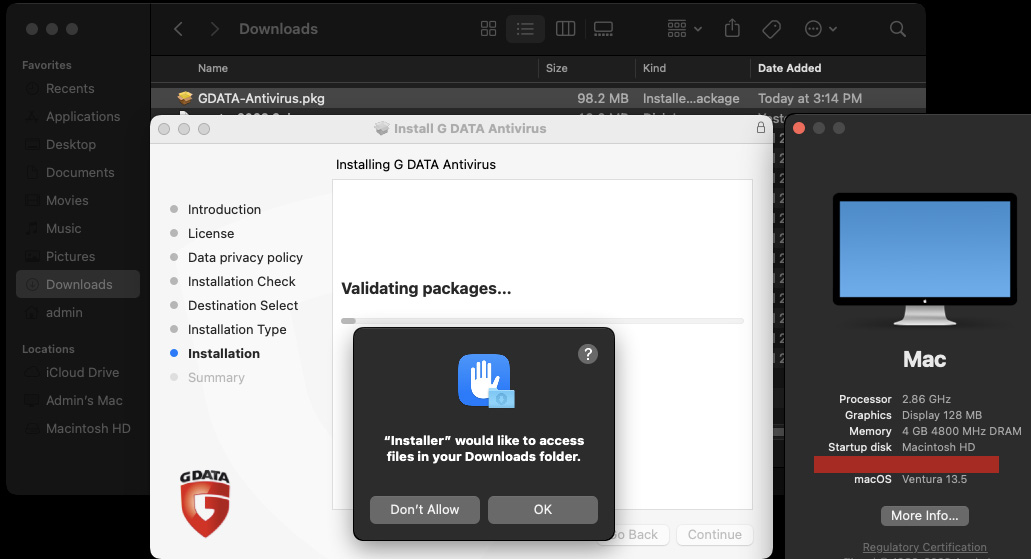

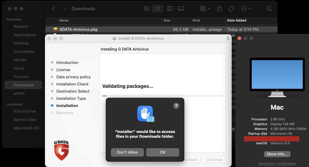

Erm..no. It’s an Apple issue because it affects EACH AND EVERY dmg/pkg app installation.
Coincidentally, I’ve just installed GDATA-Antivirus.pkg in Ventura 13.5. During installation, the installer asked for permission to access the folder from where it was installed <“Installer” would like to access files in your Downloads folder.> and the installation was successful.
So, good installers behave properly. ;-)
