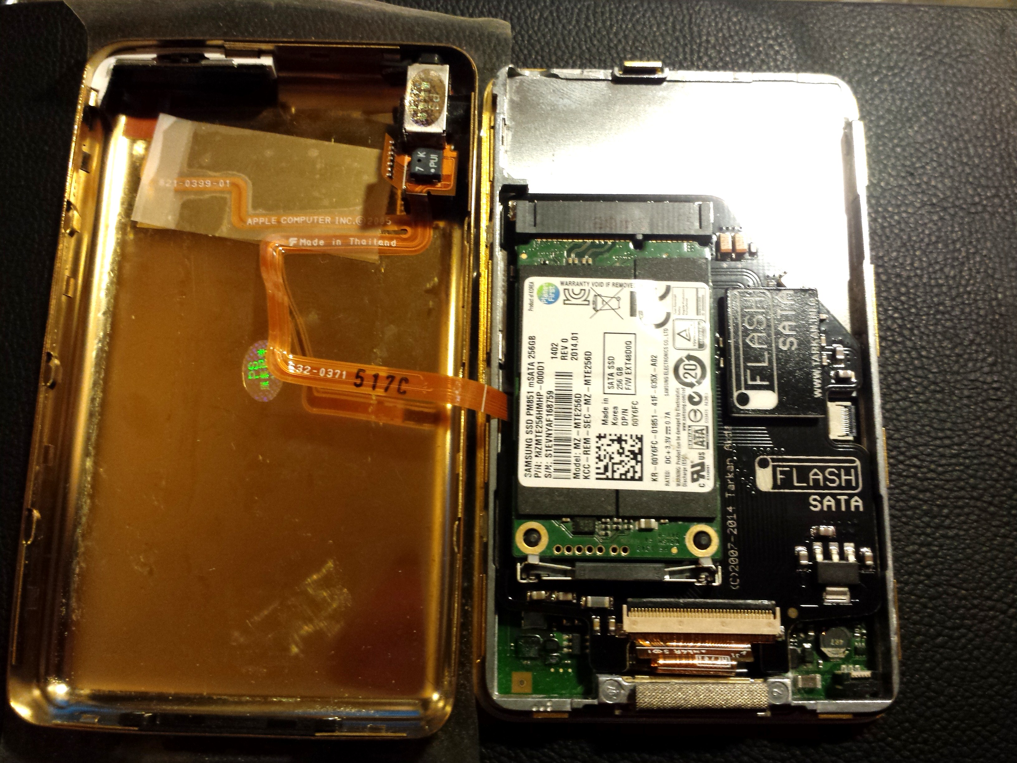

Check out the pics. I gotta get my butt to bed so I'll get
online later after work and explain and/or try to answer
any questions/comments you may have....
Have a great day, ttyl, J

Ahhh, ok, I'm still a fast learner :)
here you go for anybody interested.
Hit me up with any questions you may have.
I'd be more than happy to help you out if you'd like.

Just got the mSata drive in.
