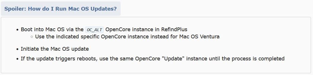

MyBootMgr Guide:
To be fair though, this was added not so long ago.

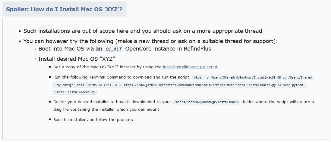

EDIT
This has been there for ages though:
Needs some updating but would have done
