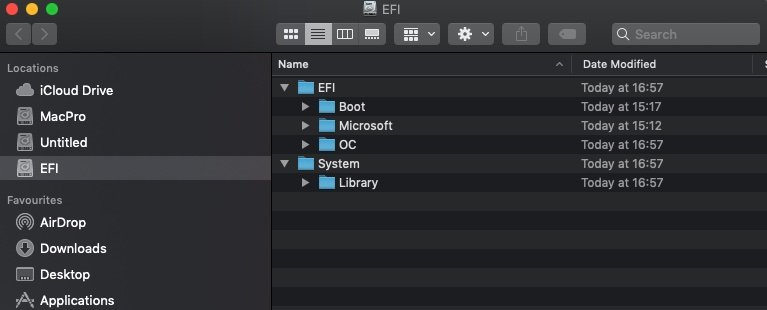

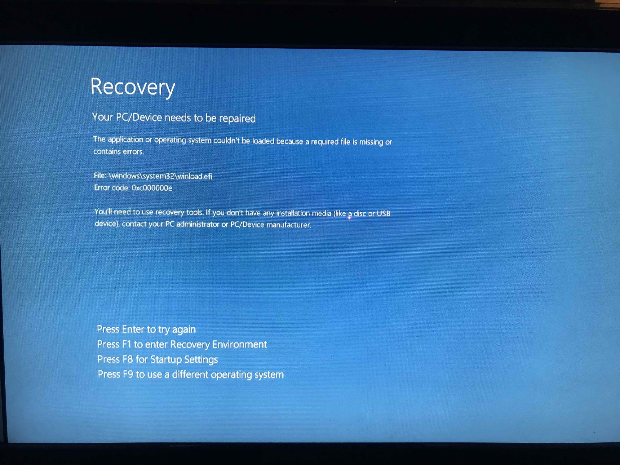

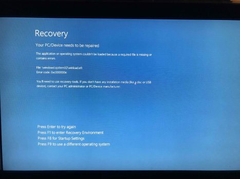

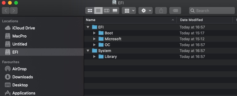

And here is my 09.03 update.
(Pictures in attachments are ordered by time and course of action, below)
(I can add more pictures of the whole process if necessary)
Well 09.03.
In the moment I managed to advance in my installation process (step 4) I wanted to say “Don’t ask how I did it”, but here it comes…
I tried with both (Monterey and Mojave) drives. And here’s what worked for me:
Before install:
I made deep NVRAM reset (not related to following procedures, I just checked that its working. But I don't know does this have anything to do with my successful installation.)
1. I installed OCLP on Mojaves ESP.
2. Rebooted: selected EFI(OCLP’s bootloader) > NTFS(windows 11 USB drive made with Rufus)
3. Got the blue screen with message(I can share the pic, not going to write all that message out here):
“Your PC/Device needs to be repaired” and error message
File: \windows\sustem32\winload.efi
Error code: 0xc000000e
Press Enter to try again
Press F1 to enter Recovery Environment
Press F8 for Startup Settings
Press F9 to use a different operating system
4. I pressed fn + F9

- Does my ESP’s have the contents they have to have? (Mojave ESP; Windows drive ESP; Monterey ESP)
- What do I have to do to connect Monterey in Bay 1(ESP contents, Can I delete Mojave’s ESP finally, Do I have to have ESP partition for the Windows drive(Microsoft folder location)?

3. "Your PC/Device needs to be repaired" Mojave - OCLP result.jpg

  • 3. "Your PC:Device needs to be repaired" Mojave - OCLP result.jpg
