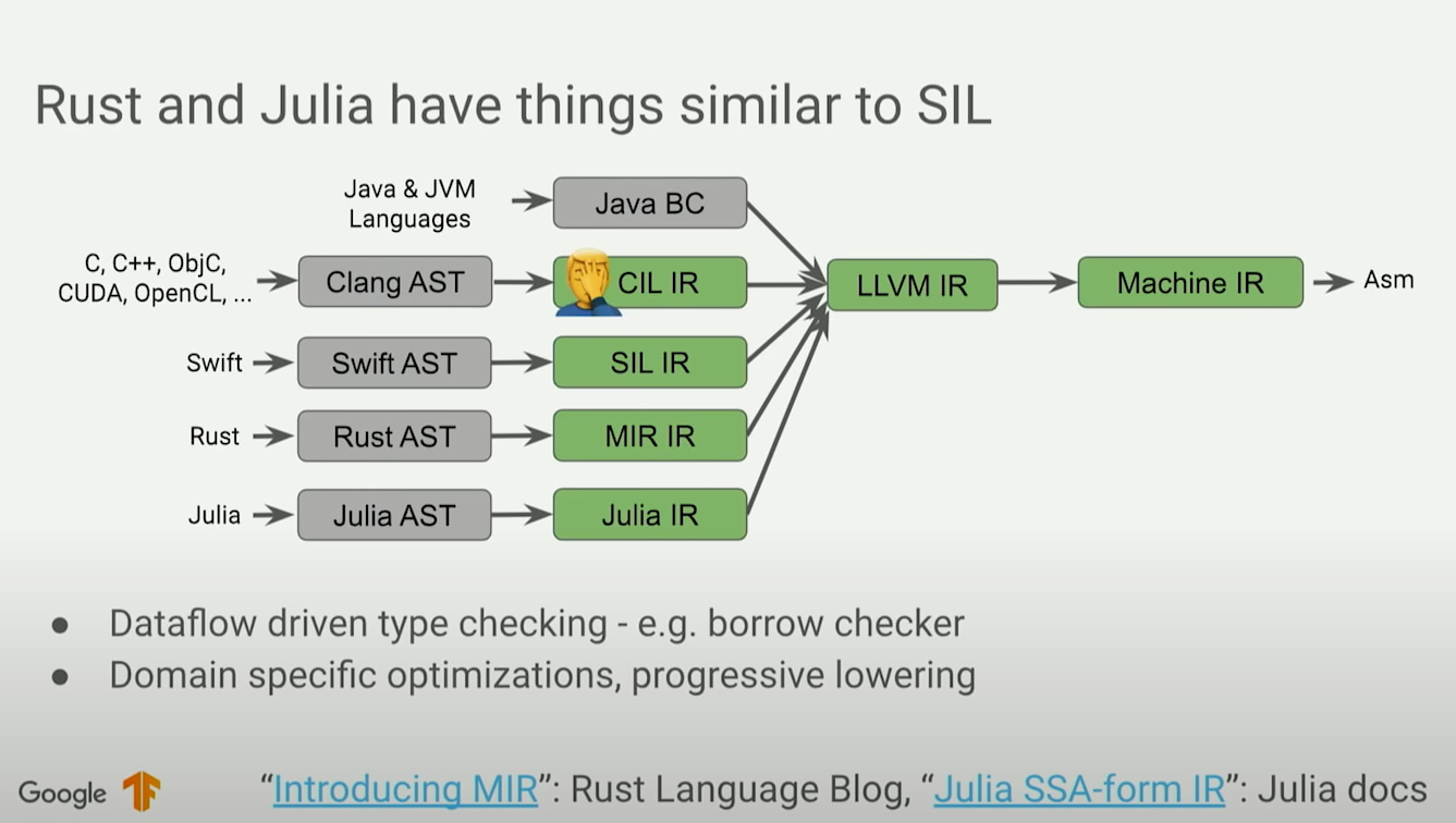

If you write your code in correct C/C+/Rust without relying on any platform assumptions your code should run pretty much anywhere.
LLVM helps to do that and has become a "standard".
Source:
Explanation of LLVM in the first five minutes.
But, LLVM is getting bloated https://www.npopov.com/2020/05/10/Make-LLVM-fast-again.html
So, programming languages are looking for new alternatives. https://jason-williams.co.uk/a-possible-new-backend-for-rust
