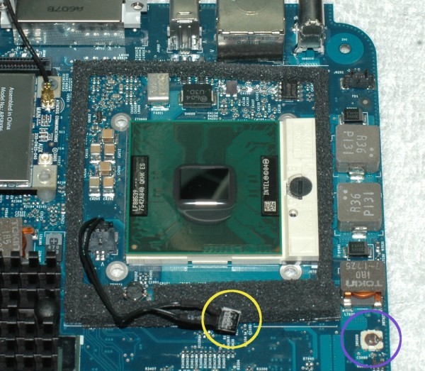

After reseating cables again and again, resetting the SMC and PRAM, swapping sticks, etc., I happened to notice a picture on a Mac mini take-apart guide. (I was using the guide to help me take apart the Mini. It seems there is a hardware button to "reset PRAM" (according to the site, it resets BIOS). It is circled in violet in the picture. Push this button ONCE, and all your problems should be solved. I know about the keyboard shortcut, and tried it multiple times before opening up the mini (it's a pain to use the putty knife).
If anyone wants to read the guide, it's at http://hdtv.o0o.it/mini/
