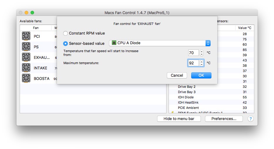

For the intake and exhaust. We can consider something like this.
Since we know the boost fan will keep the CPU cool. So, both intake and exhaust only need to assist the boost fan when the CPU is really warm. e.g. approaching 70C (assume CPU max at around 70-75C from the above fan setting).
So the above setting simply make intake / exhaust fan spin up ~100RPM per 1C (when CPU reach 70C). And that should eventually stabilise somewhere <1000RPM and the CPU <75C.

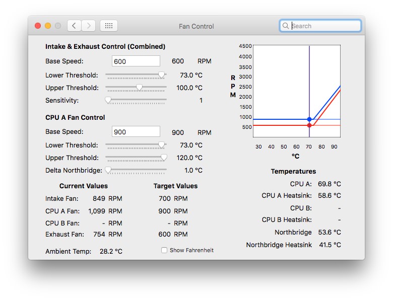

For your reference, my own fan profile is like this. The lower threshold is 8C higher than what I suggested to you. And that's for my W3690, which has a Tcase max about 10C lower than your X5680. So, even though I can't test those value. I believe my suggestion already put you on the safe side.

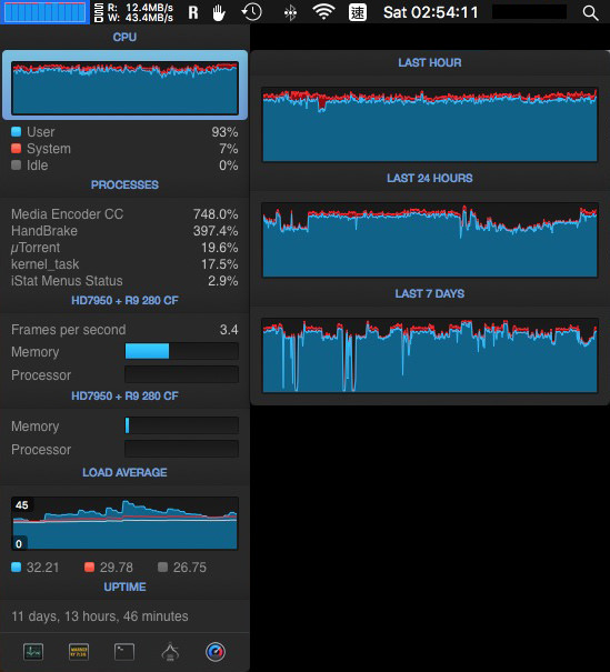

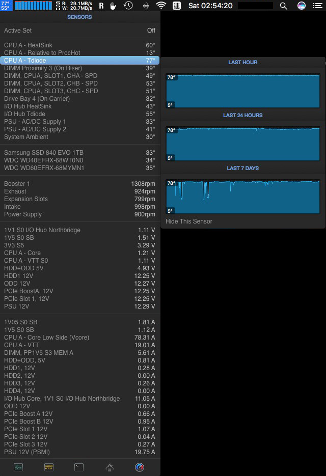

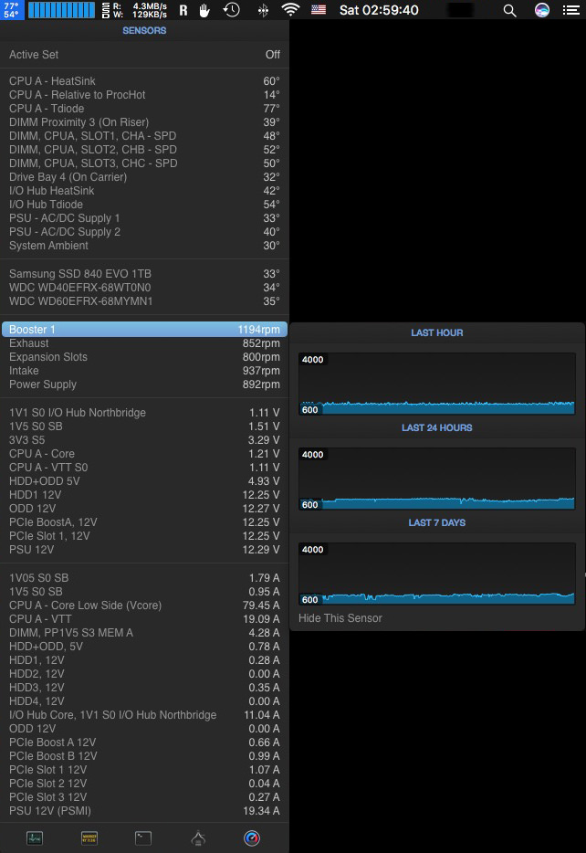

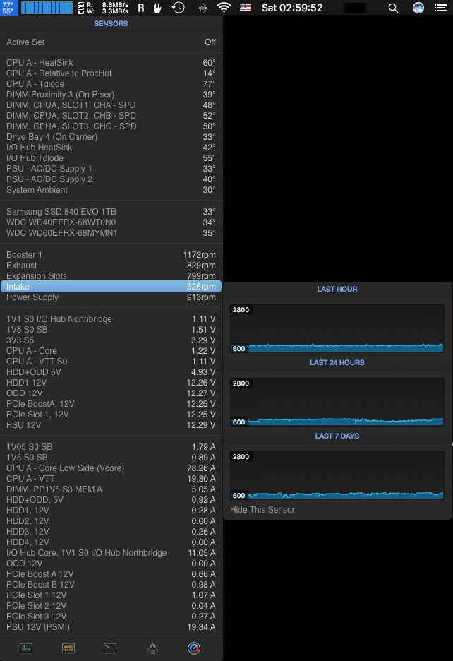

For my fan setting and my usage. Even though I keep the CPU >90% usage most of the time. It can clearly keep the CPU at 78C or below, with the boost fan speed usually stabilised at ~1300, and all other fans a bit below 1000.
24:7 CPU loading.jpg
24:7 CPU loading Temperature.jpg
24:7 CPU loading Intake.jpg
24:7 CPU loading Booster.jpg
