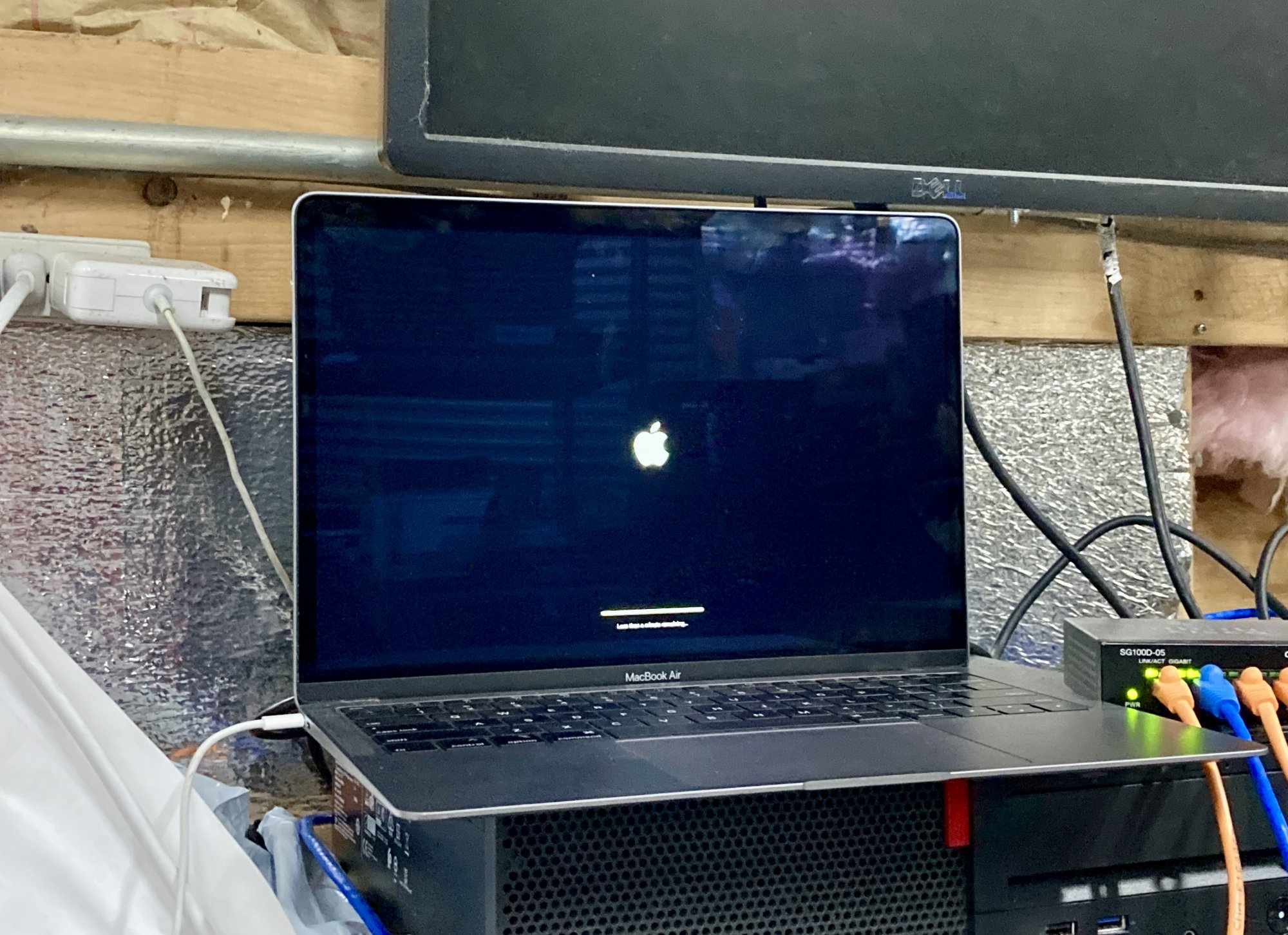

Maybe I'll take one of these problematic Airs and use it on my secure home Internet, and see if that works. Then once it's reset and ready, I can bring it back into work to be logged and ready for resell. I've done it before.
I tried. So far, I've only had luck with getting one all wiped, re-installed and ready for resell, since I have to use Internet Recovery to install the MacOS on a T2 chip-equipped Mac to check if it's still managed, change the security settings to enable booting from an external drive, then wipe the drive and re-install the MacOS (i.e. the highest version it'll support). The other three I've been working on, I've had no luck with getting Internet Recovery to load onto them, Wi-Fi or Ethernet. I wonder if it has something to do with the drive not being initialized, and/or the battery apparently being dead (the one that worked still has a good battery).

I was able to get another to load the Internet Recovery Mode and start installing the MacOS. Since this one has a 512 GB SSD, I may consider using this one as a work computer, for running the latest version of Apple Configurator 2 and any future reviving and restoring of Macs with T2 chips, now that my 2015 Retina 15" MacBook Pro can't run the latest Apple Configurator and doesn't have Thunderbolt 3. (For now I have to bring my M1 MacBook Air into work for this.) But the first attempt at this, it hung at "Less than a minute remaining..." while the status bar was nearly halfway through. This second attempt after resetting the NVRAM and SMC and rebooting the Air, I started the second part of the install a little over and hour from posting this, and the bar went all the way to the end, but it's still seeming to hang there. I'm gonna let it sit this way through most of my shift to see what happens next. If it's not done anything before I punch out, I will reset the NVRAM and SMC, and reboot the Air again and see if that does anything overnight.
Well, it turns out this particular MacBook Air had a bad battery! I took it home and swapped the battery, and that brought its' performance and speed back to normal, and now I use it as a work computer!

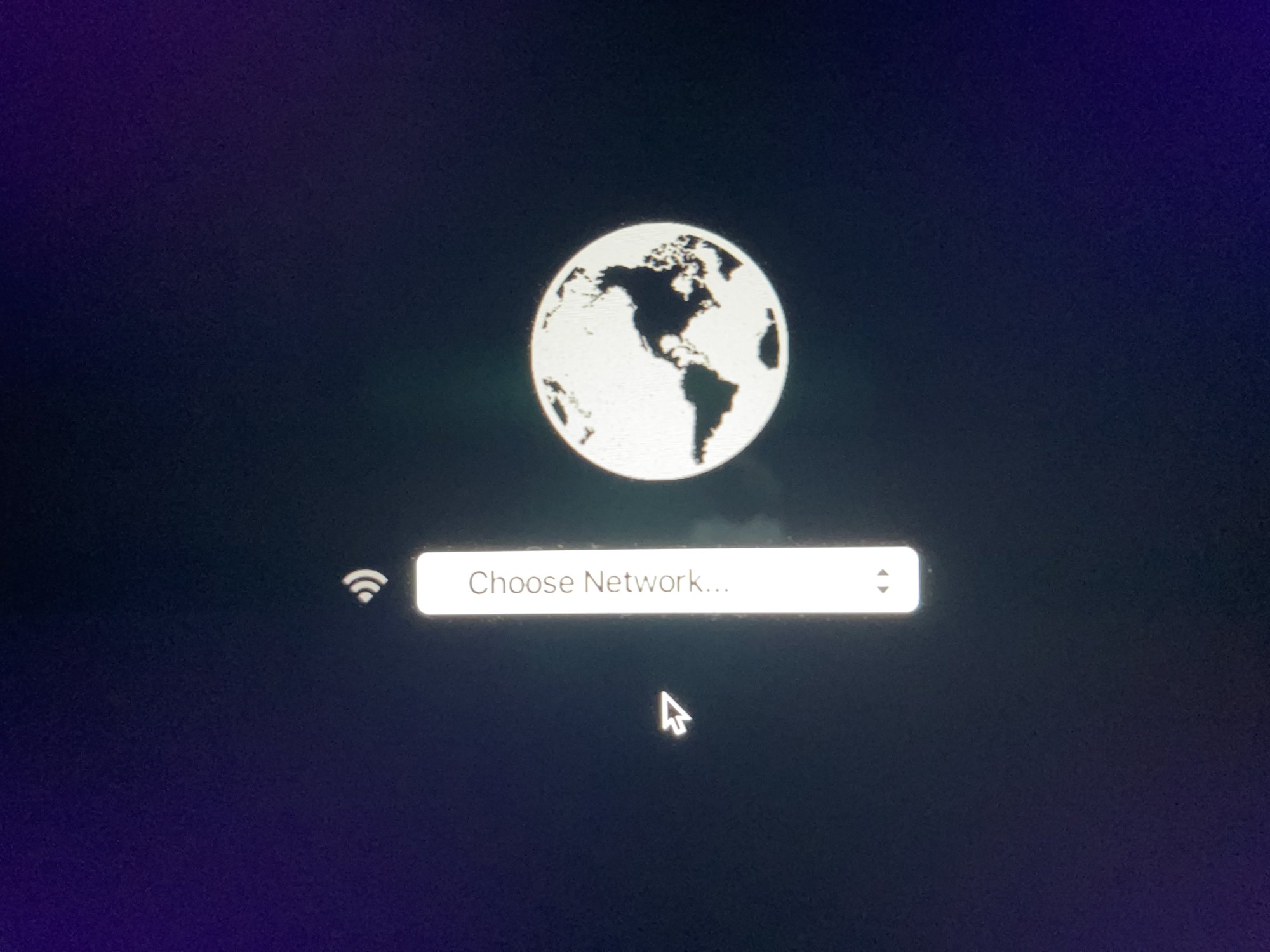

My question is pure curiosity.

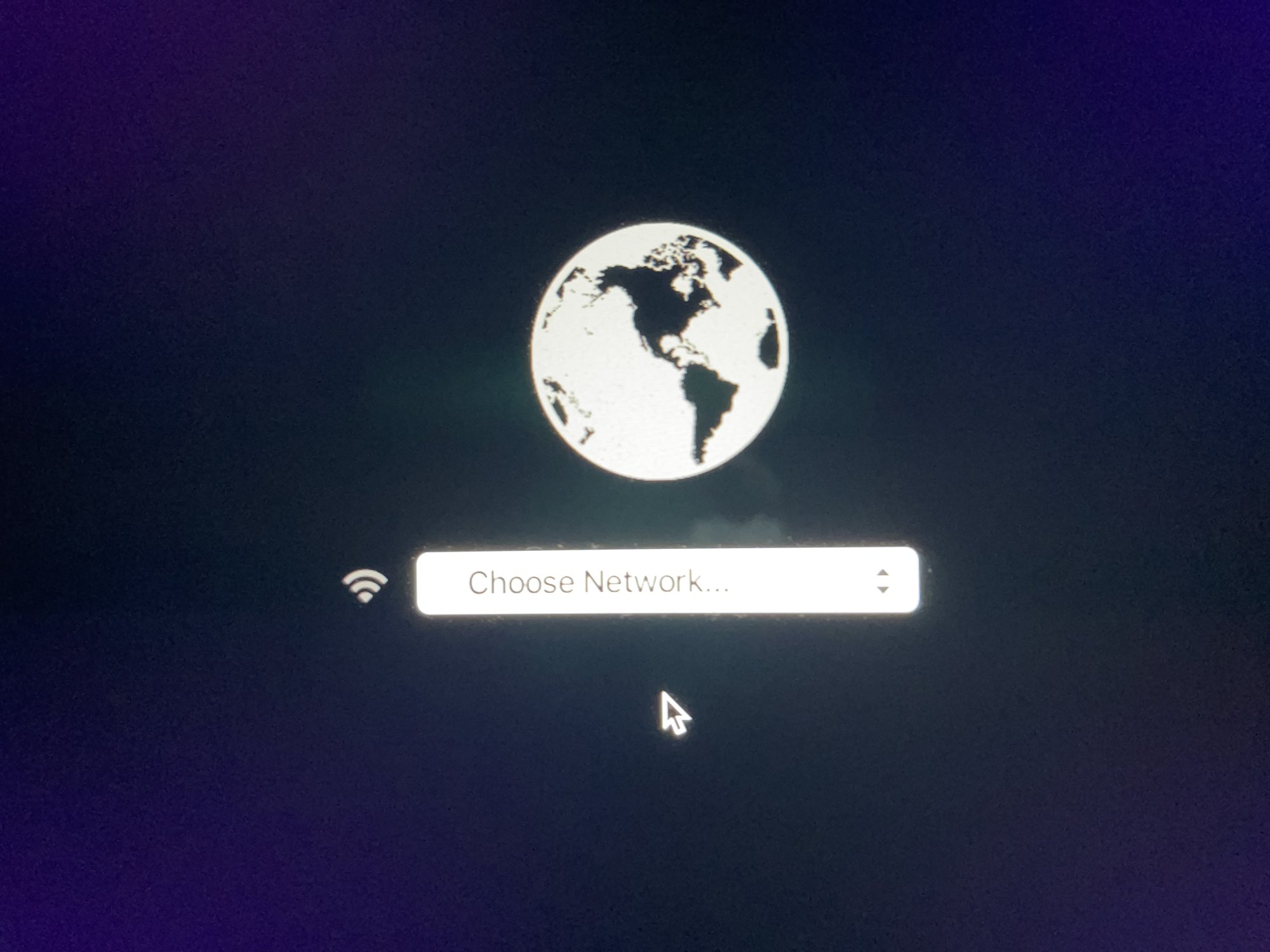

All key combinations were disregarded by the iMac so it booted directly to the recovery volume of the internal disk.
But at the screen of selecting network, both your mouse and keyboard are still working, ist that correct?

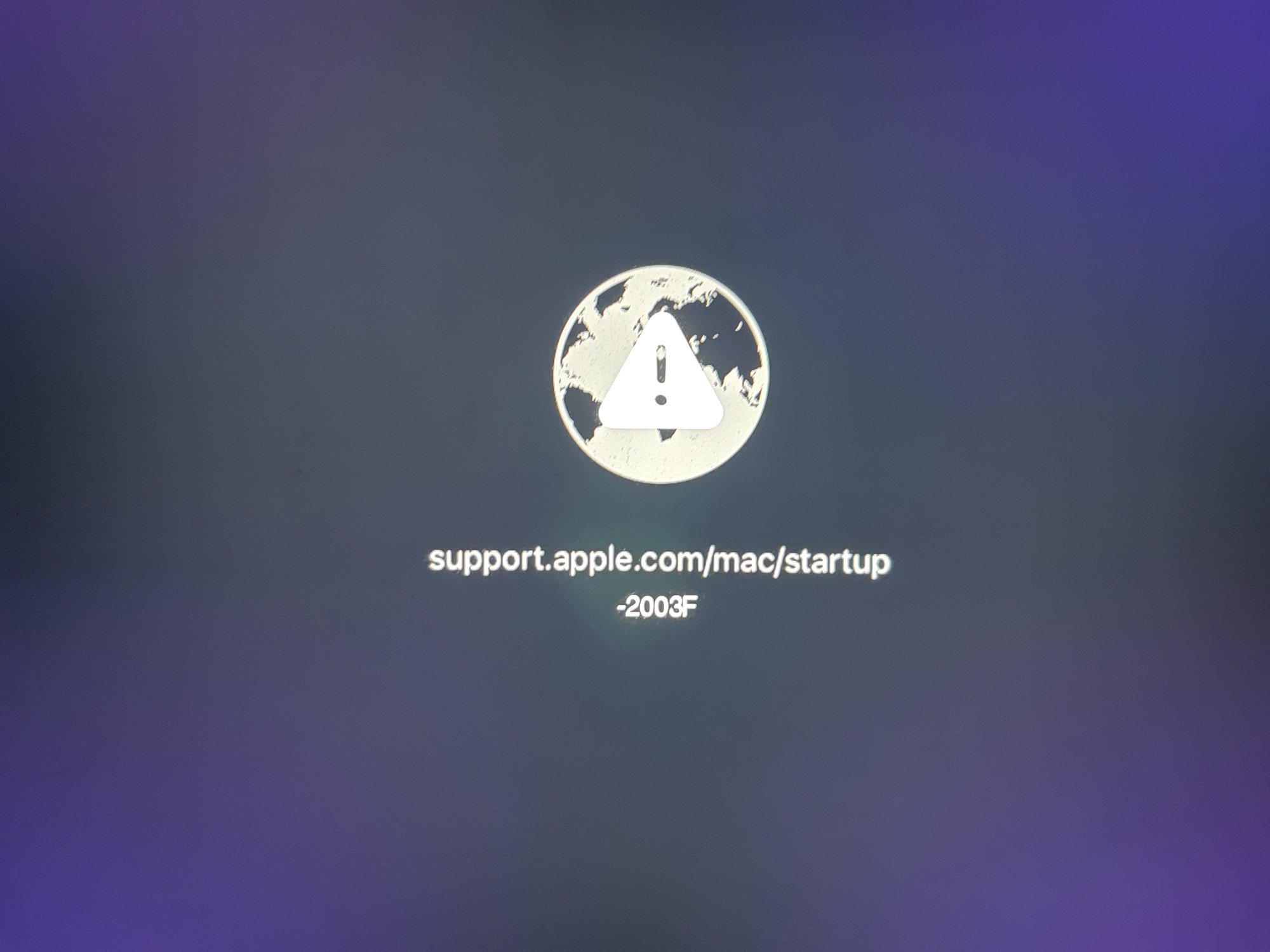

Now, all of the error codes in your description points into 1 type: Internet Connection errors.
2003f, 2002f, 2100f and 1008f

Grant Bennet-Alder said:
In Internet Recovery, these low negative thousands error messages indicate that your provided Wi-Fi Network is inadequate in some fashion, and cannot be used (for this purpose) in its current state.
Common problems include:
Hidden Network-name
required use of a proxy server to get Internet access
required use of a login page to get Internet access
Use of a login server or certificate to get Internet access
Use of PPPoE in the Mac to get Internet access (typically only applies to DSL)
Use of Fixed IP address rather than good old DHCP
Variance of the time by more than five minutes
Failure of Router to provide workable DNS server addresses, or providing 0.0.0.0 [may produce -2002f]
The higher the number, the more obscure the problem.

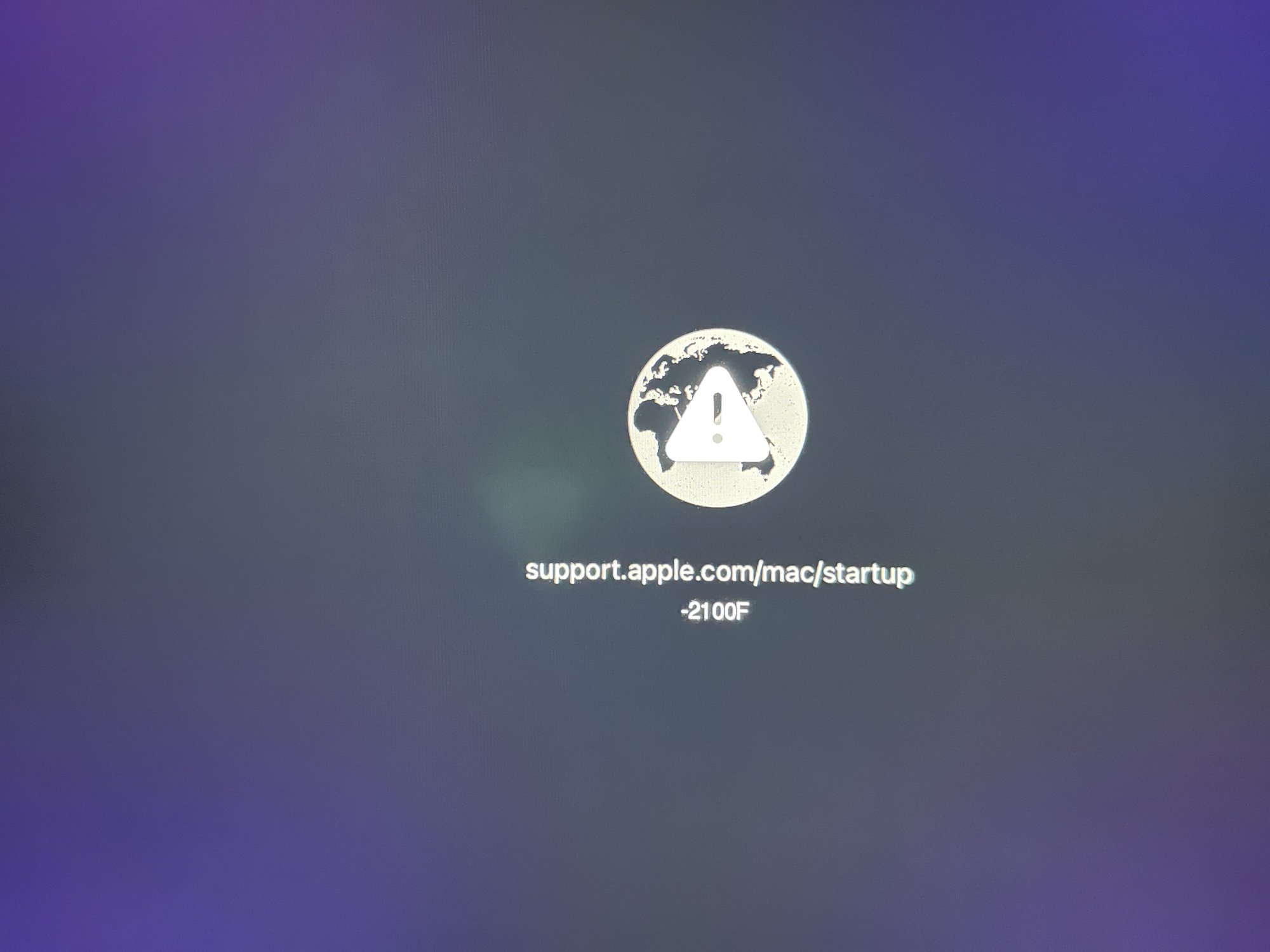

Nasreddine_boumahdi
macrumors newbie
Jul 3, 2024
1
Cliff's Notes edit for people that don't like words:
iMac Pro 2017 27" (I know that is redundant) was running Monterey OS fully updated.

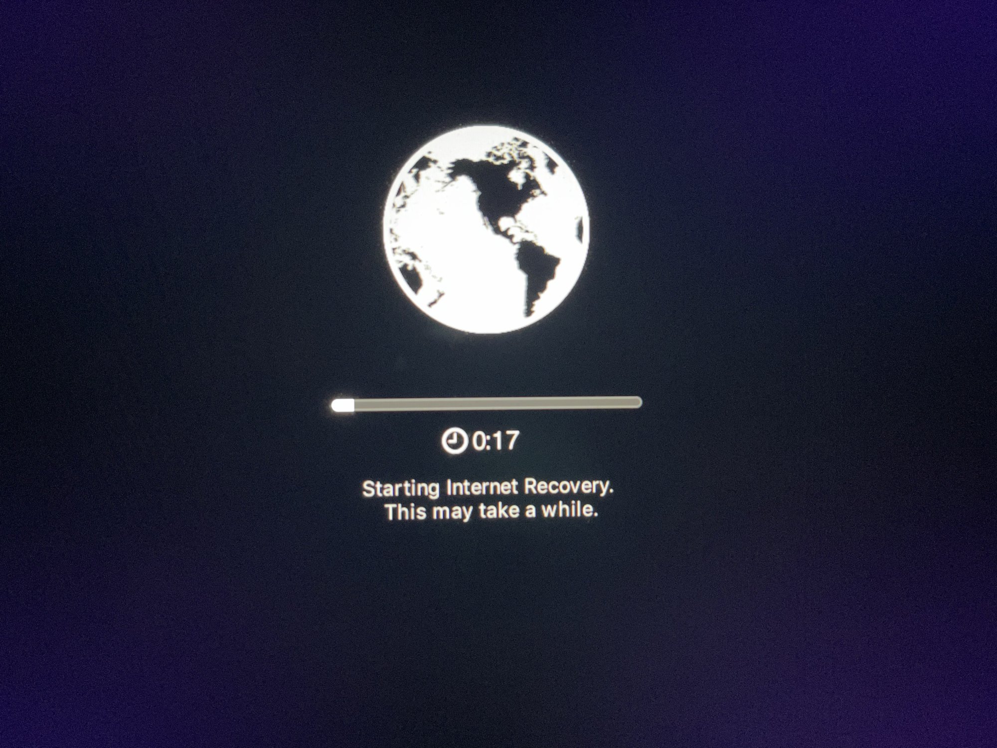

Stuck in Internet Recovery mode, PERIOD, nothing else, I get white apple on black screen, then spinning globe.
Tried all keyboard commands on MULTIPLE keyboards WIRED and WIRELESS
Tried Wifi keep getting error 2100F
Tried ETHERNET direct keep getting error 2003F

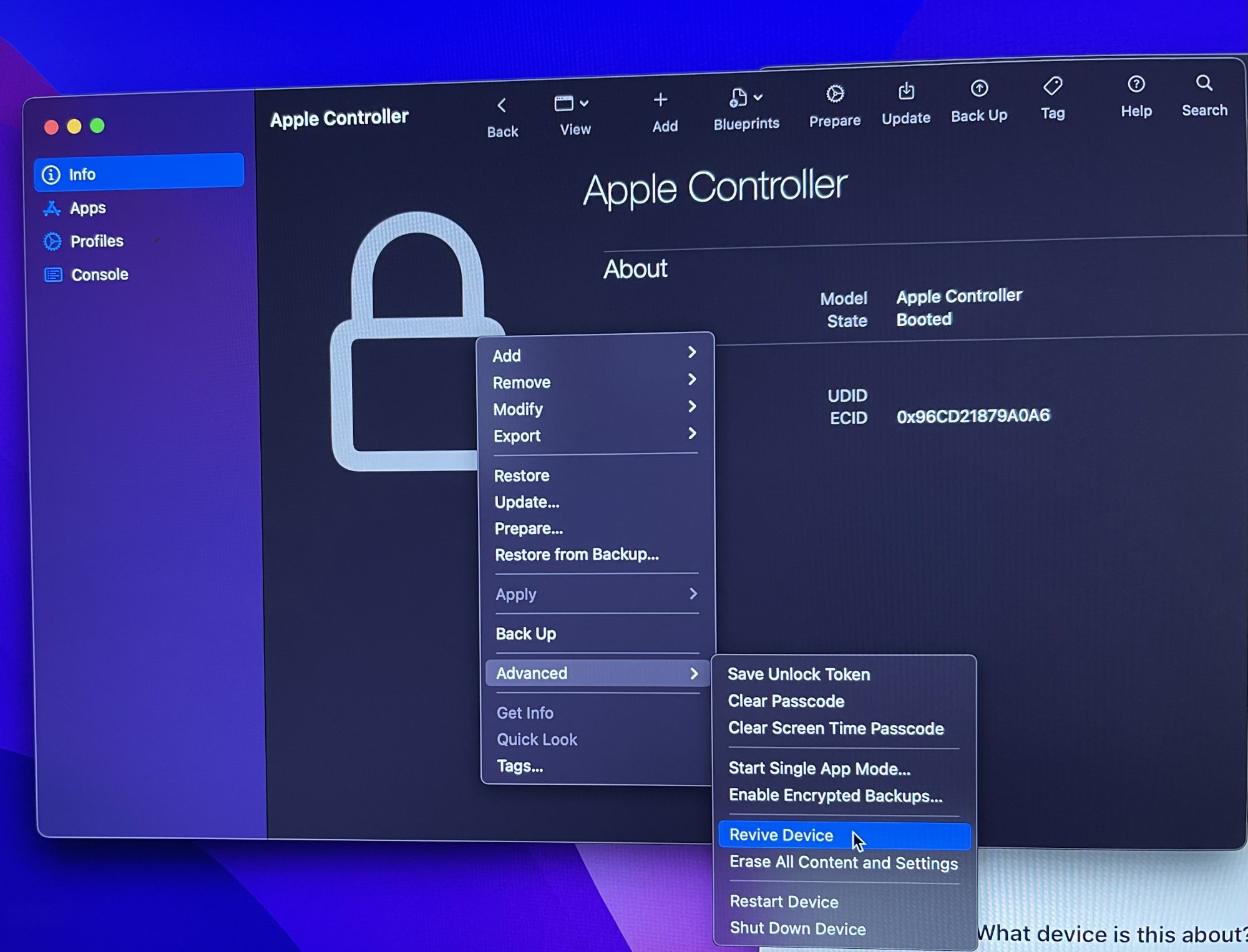

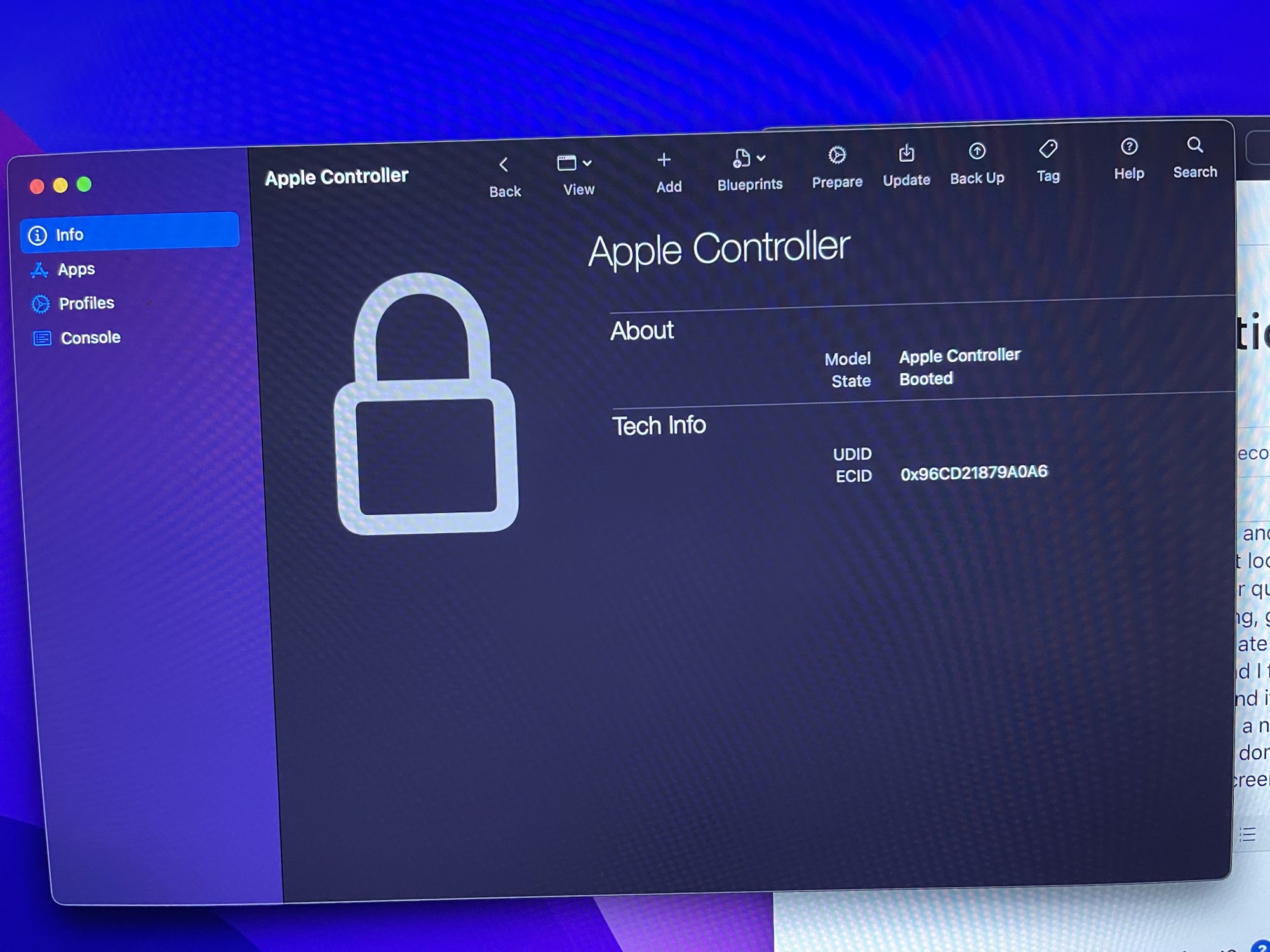

Used SECOND GOOD iMac with apple configurator 2 application, doesn't register first iMac properly and WON'T let me do a remote restore.
I created a Monterey USB bootable install drive, but I CAN'T get the iMac to give me an option, I get nothing but the internet recovery just like the title says.
Original words:
I have an iMac Pro, I was getting ready to sell it, read about best way to wipe SSD before doing a clean installation of Monterey, I turned on file vault, then changed password to a long random mess. I then erased the drive and started to use recovery for the clean install. At this point it went to internet recovery, I tried wireless, had error 2100F after 25 minutes or so. When I restarted the computer, it went directly into internet recovery mode. I tried restarting and using command R with no luck on the Bluetooth keyboard, I then plugged the cable in directly, command R did nothing. It would always boot directly into internet recovery mode, I tried another keyboard, nothing, I held the power button, nothing changes, it boots back to the same place. I unplugged it, no change, I ran an Ethernet cable, then got error 2003F. I then tried another iMac using Apple Configurator 2, it shows something, but won’t allow me to restore. I can’t even get the option to boot from an external drive. Just internet recovery mode. Any suggestions?
Below is the only screen that will "boot" after a restart, I can only force restart with power button or unplugging.

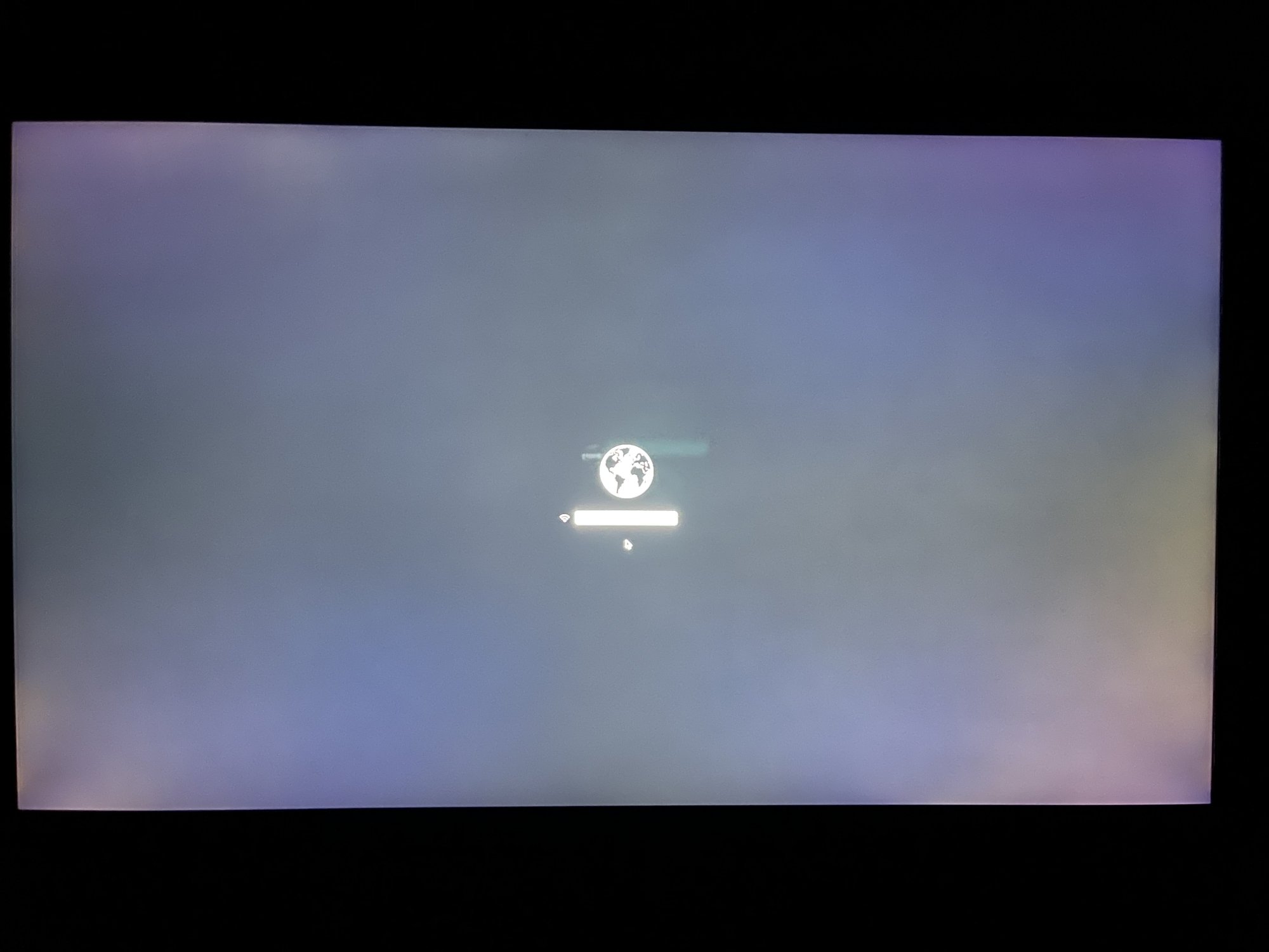

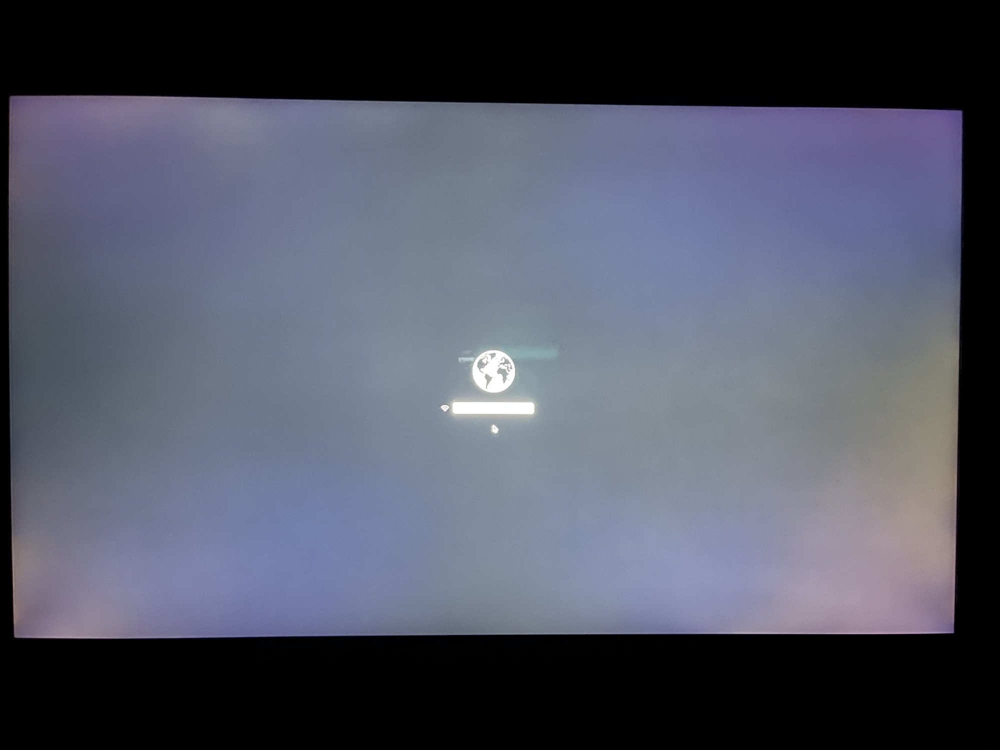

Below you see that the iMac still responds, I can type in a password for Wifi or manually enter the network.

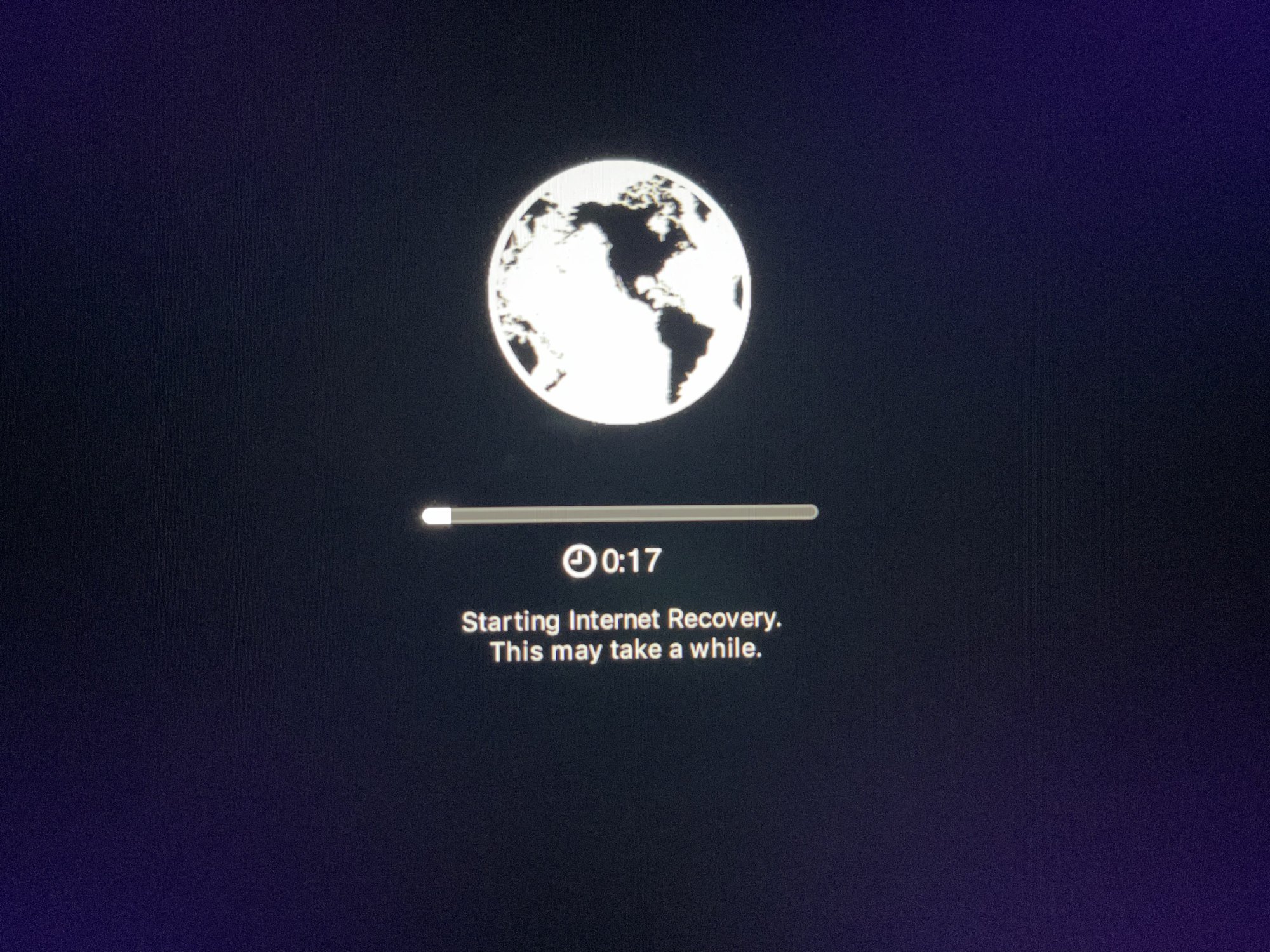

Below you can see that is is trying to do something.

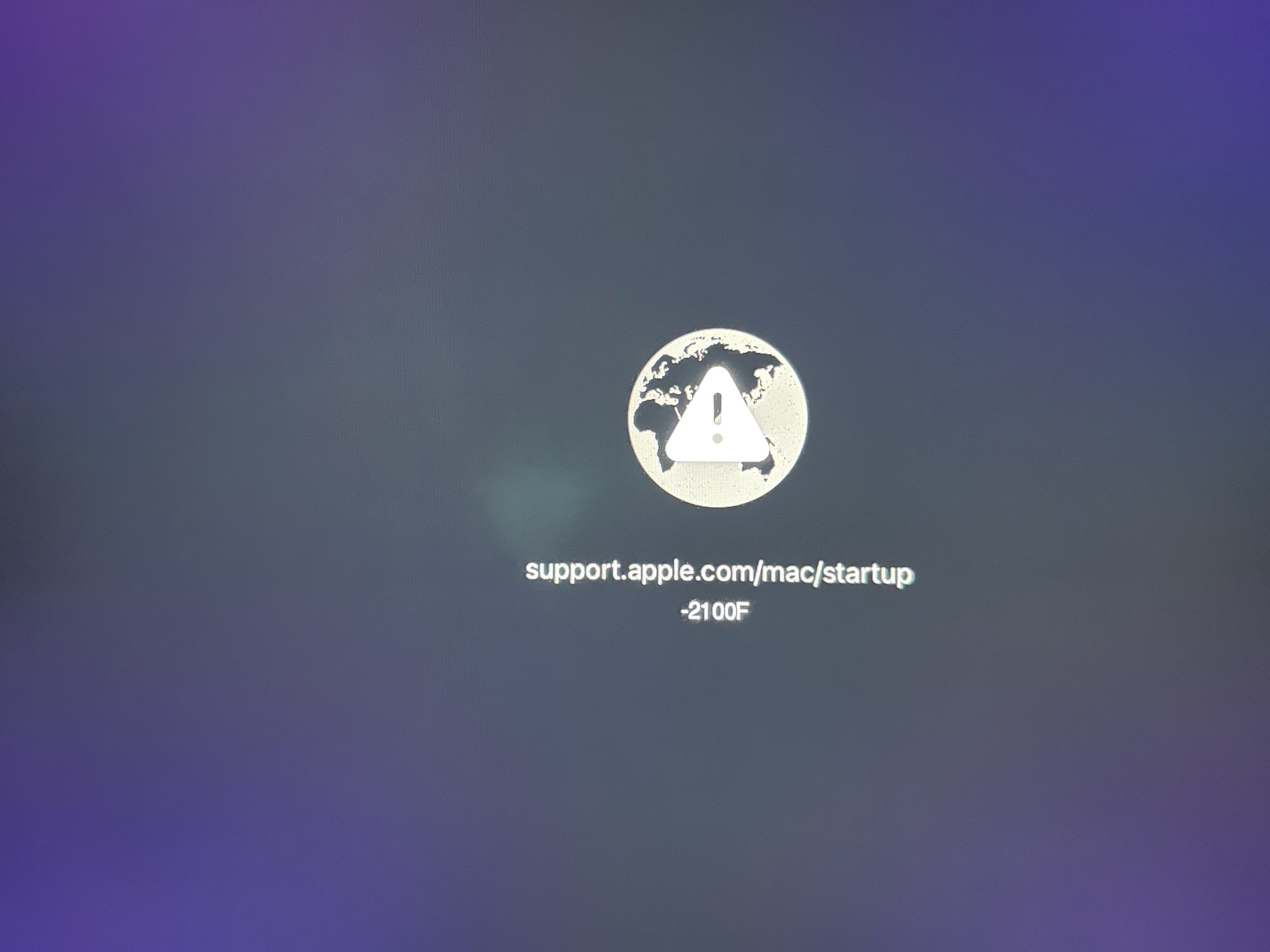

Below is the error message I get after 20 minutes or so using WiFi.

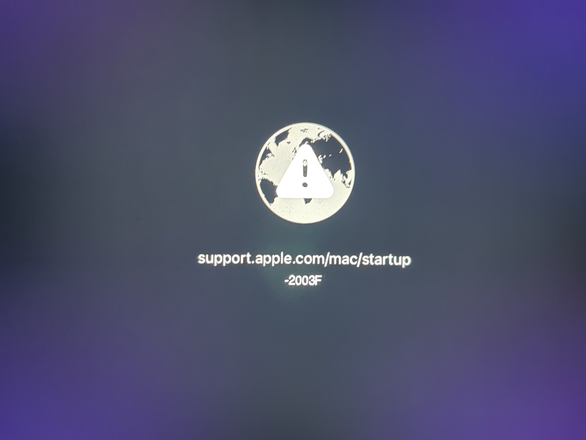

Below is the error message I get after using ETHERNET CABLE.

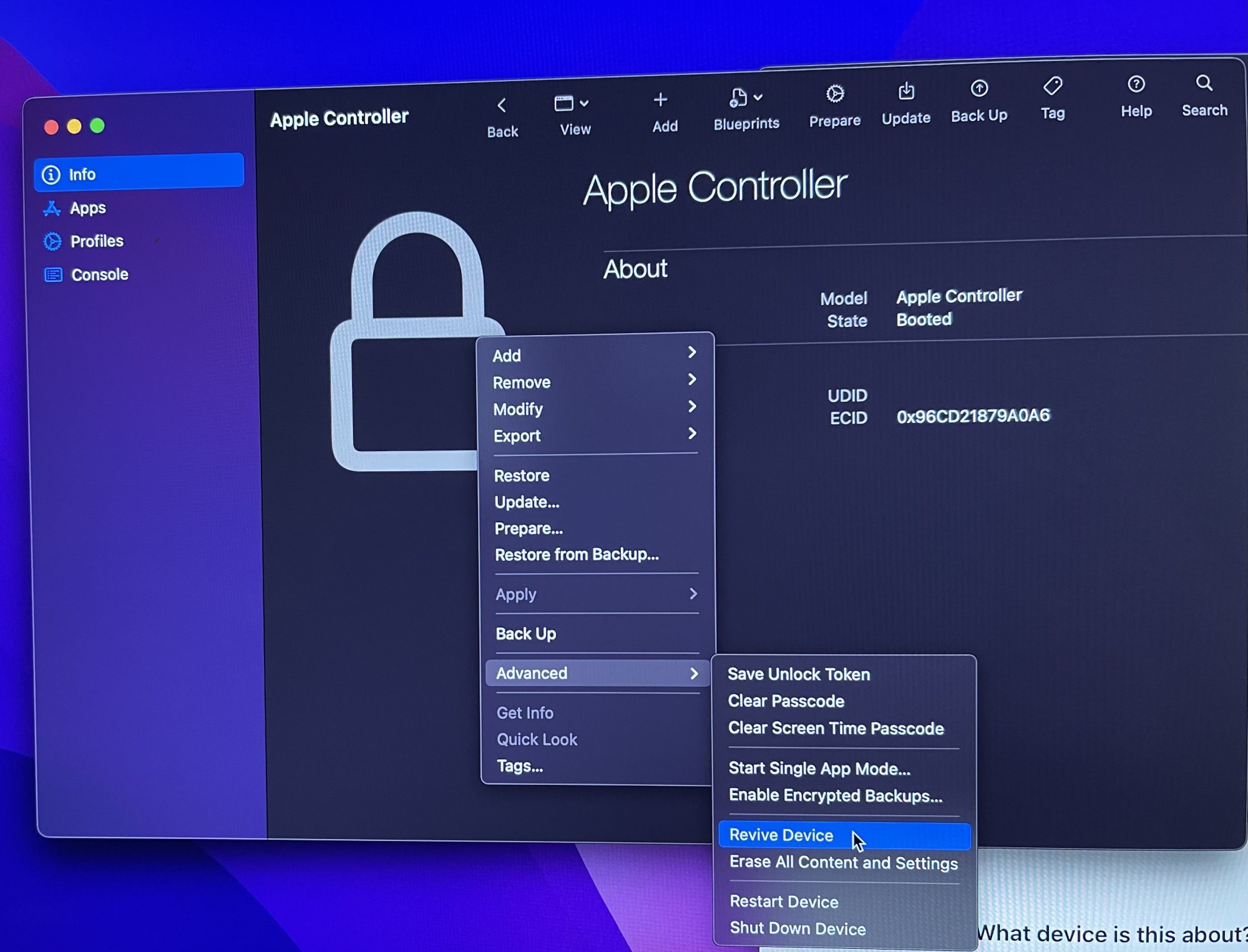

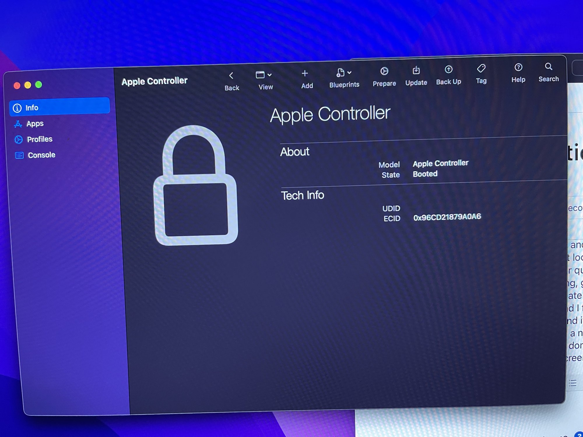

Using a SECOND good iMac running Monterey, this is what apple configurator 2 decides it sees when hooked up with an apple USB C charging/Data cable

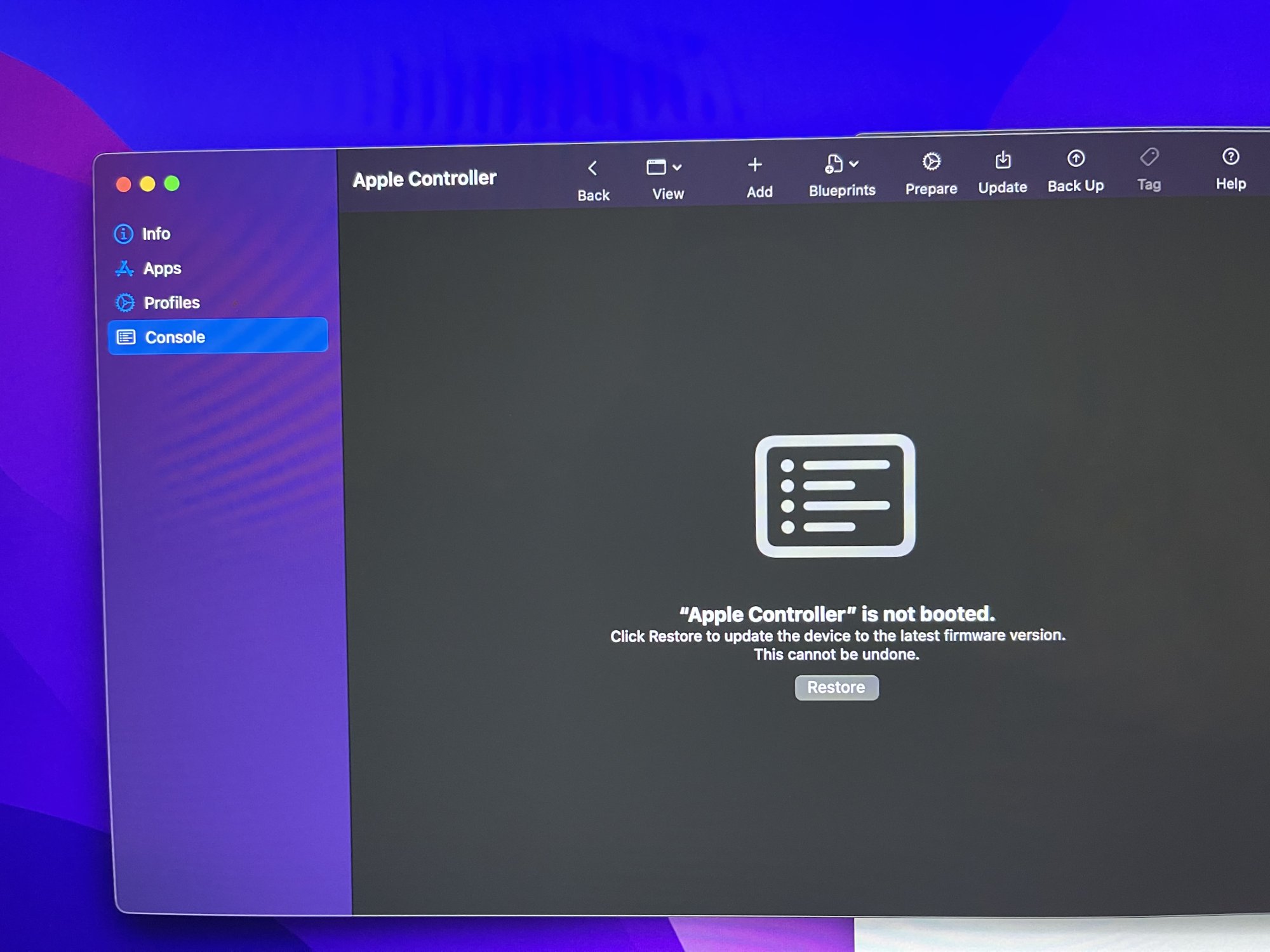

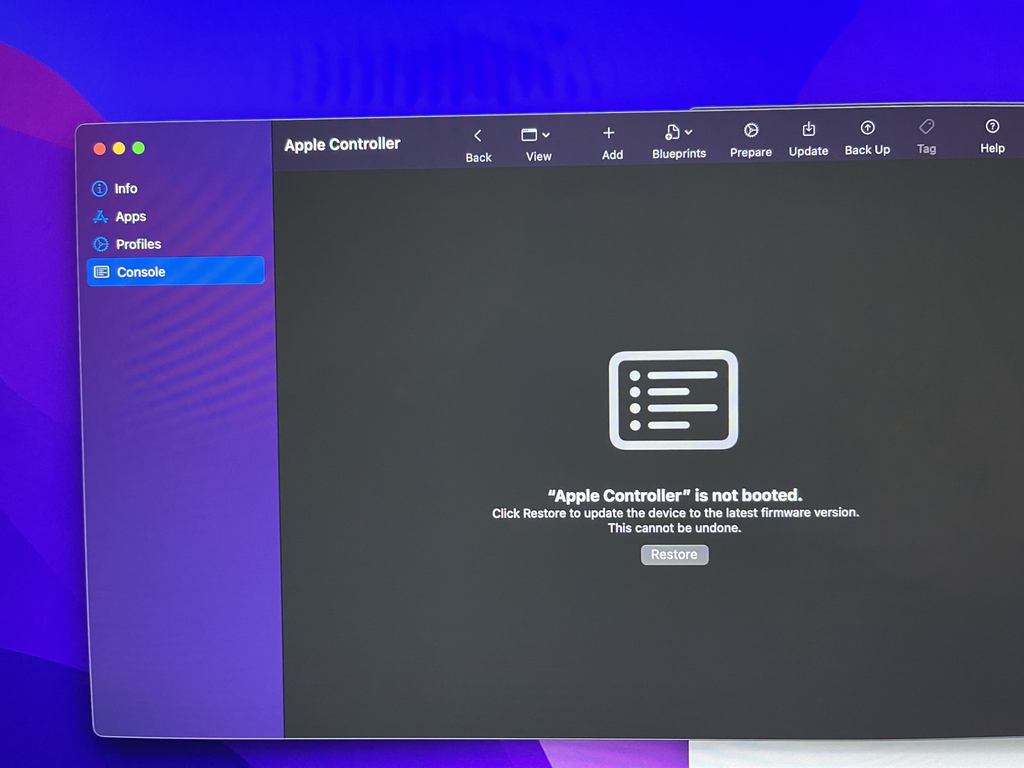

Below is one of several screen that all essentially say the same thing about the "bad" iMac.
Below shows the choices I have and every one of them does nothing.

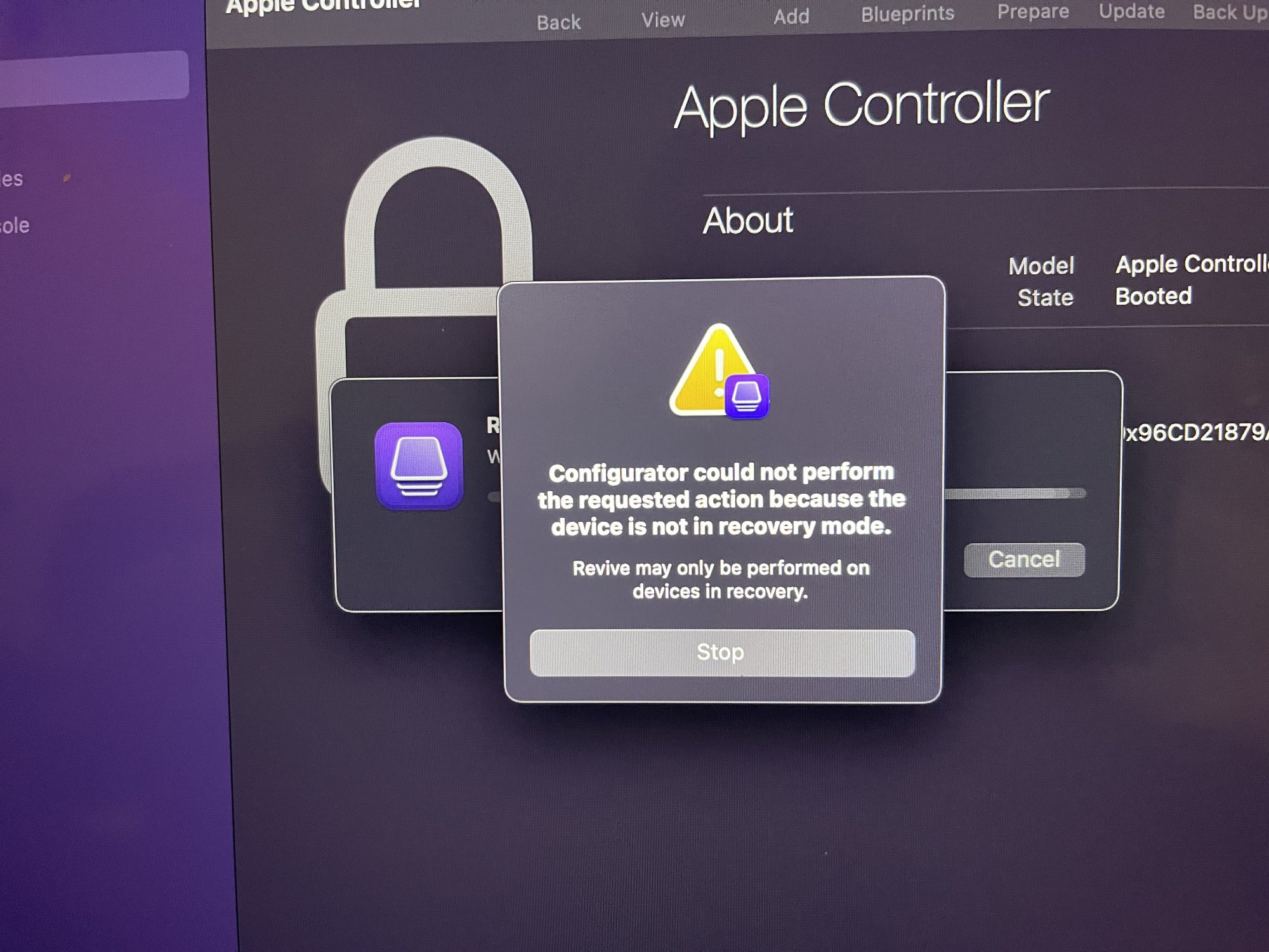

Below is the error message I get when I try and revive. restore, reboot, or erase the "bad" iMac.

It is not DFU mode on your Apple configurater pictures. To enter DFU mode: Turn off the imac power at the wall, hold the power switch down on the iMac while you turn on power at the wall. Wait around 30 seconds till it shows up on the connected computer and you can let go of the iMac power button.
