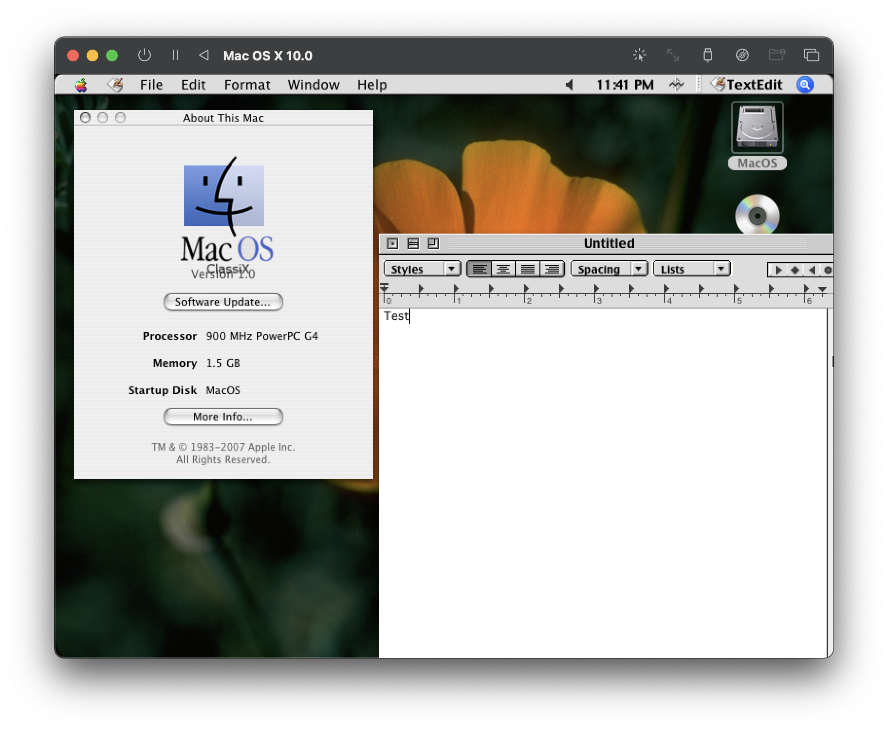

Stupid me forgot to put more than 128MB of RAM in the VM, it's fine now.
