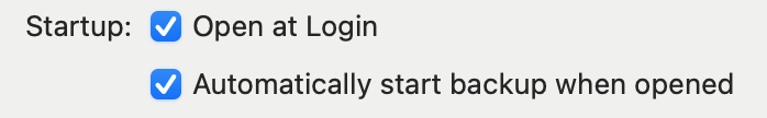

Thanks for your reply. It is appreciated.
Yes - I have Open at Login and Automatically start backup when opened both set. And yes, it has updated.

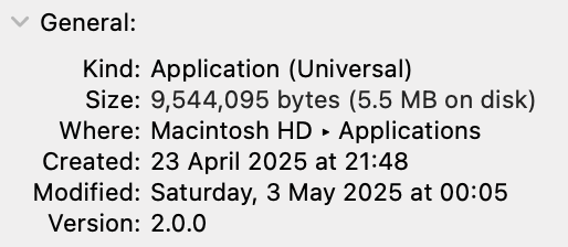

I'm not entirely sure what happened when. :( I think I did restart the other day. Checking I find - Time since boot: 5 days, 23 hours, 54 minutes - which looks like Tuesday 29/04/2025.
Looks like it updated on Saturday 03/05/2025 but failed to relaunch properly. And, when I manually launched, it went through the database updating processes.
As I said before, the ONLY real issue was that I think I could have missed that it wasn't running for a long time. My eyes don't naturally look at the menu bar much.
Thanks for your detailed update and screenshots — that helps a lot. I’m sorry for the confusion and inconvenience this issue caused.
I’ve confirmed that the upgrade to version 2.0.0 can reset the “Open at Login” setting. You can check whether Photos Backup Anywhere is set to open at login by opening System Settings on your Mac, navigating to General → Login Items & Extensions, and verifying that "Photos Backup Anywhere" appears under "Open at Login." If it is not listed, simply launch the app manually and re-enable “Open at Login” from within the app settings.
This is a one-time issue caused by a change in the app bundle introduced in version 2.0.0, and you should only need to re-enable the setting once after the upgrade.
Please let me know if that’s not the case or if you have any other issues or feedback.
Thanks again for using the app!
