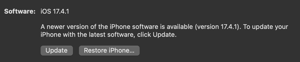

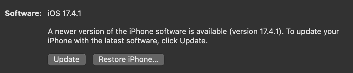

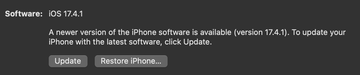

I have 17.4.1 on both iPad and iPhone and they seem fine. Yet when I hook em up to MBP I see this: (below.) Is that the version I should stay away from?
Apparently, yes. But personally, I don't let my Mac or even iTunes upgrade the iOS on my devices. I prefer to grab the IPSW and do it that way. I'll download it, connect my device, hold down the option key on my Mac while clicking on Update, and select the newly downloaded IPSW file.
I did that with my 15PM when the new build came out, updated to it, saw some (but not significantly stark) drop in battery performance, then reverted (updated "back") to the 236 build, which I had already downloaded the IPSW for (both are still signed).
