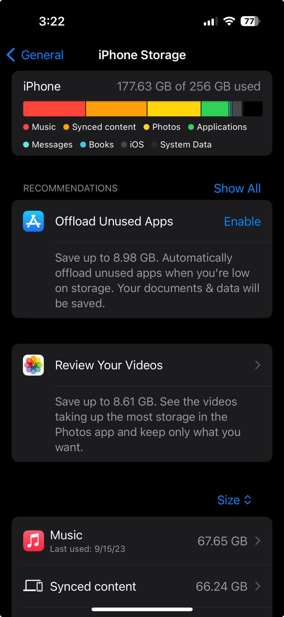

System data isn't the problem for me. It's the synced content category that is taking up 66GBs of storage. TEch support is now seemingly avoiding me! I've been very nice....I swear.

Storage says I have 66.67GB of music on my phone. 66.24 of Synced Content. The category under Synced Content is Photos at 58GB and then Gmail at 625MB.
I did just now speak with the rep whose attitude has totally changed from being helpful and trying to find out what happened, to well, I emailed engineering and they initially said it was a new feature and it's basically out of my hands. She wanted to get off the phone as fast as possible. But she say she will let me know if engineering says anything new. I am not going to hold my breadth.
If Synced Content consists of music, podcasts, books, and other stuff (she told me photos are not included in this total) then why are there separate amounts for music, apps, books, etc. and also Synced Content? I don't get it.
I guess the test would be to see how much storage I would end up with if I synced up my phone again and unchecked music. If synced content were not counted against storage, then I should only gain the 66.67 of space. If I gained more like 133GB of space we know synced content is being counted as storage.

System Storage is not the issue here (it may be another issue). It's a category called Synced Content. You can see it at the bottom of the screen shot I posted above. I have 66GB of music I have ripped over the years and my laptop and synced it to my phone. All of a sudden with iOS 17, this new category called Synced Content show a bit less than 66GB. I understand the category is trying to tell me how much stuff I have synced from my computer to phone. But it's counting it as a separate storage category and reducing what the stats say I have left as available space. That's the issue a number of us are encountering here.

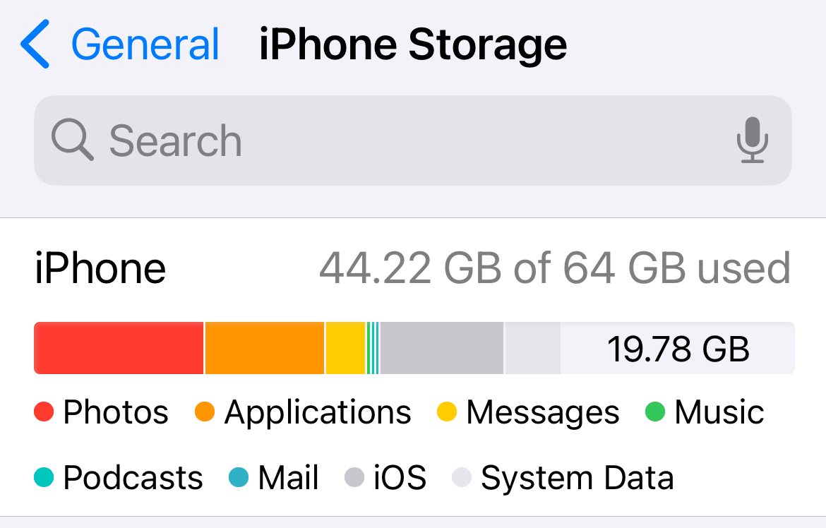

Update: iphone 12, 64GB, 17.0.1
I would delete random apps and race to back up the phone before whatever is wrong filled up storage. I was up at 63.xxGB constantly, delete some apps to get it down a couple gig, but would get so full that even the camera wouldn't work, no new messages. Missed a few good pics from my kids' soccer game...
Finally succeeded in backing up, then performed a Restore from Backup. After the restore, used storage dropped by ~20GB to about 45GB and has remained around that for 24h now. I'm calling it victory, and perhaps going back to my policy of never installing on day 1 of a X.0 release.
Updating to 17.0.2 now. Will see if that changes anything, though now that it's working maybe I should just wait till 17.1.

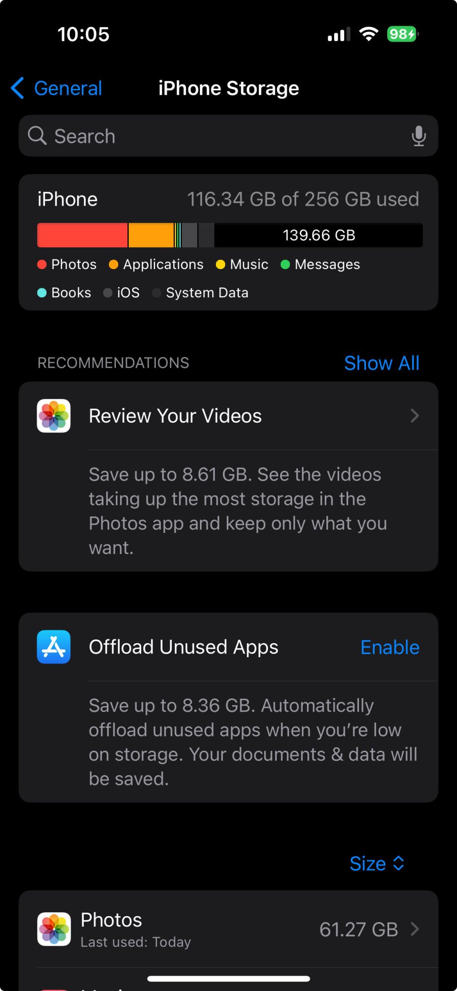

OK, I just unsynced all my music via iTunes. As seen in the pic above I had these storage figures before I did this
256GB - Total storage
177GB - Used Storage
Music - 67.65GB storage
Synced Content - 66.24 storage
Other Storage Categories
Photos Storage - 61.26
iOS (17.02) - 11.09
System Data - 11.52GB
By my reckoning - and maybe I am wrong here - by deleting my music and thus synced content, I should have gained about 133GB of storage, right? 67GB + 66GB = approx. 133.
Instead I gained approximately the amount of storage used by my music, 66.67GB. And after deleting my synced music, I now show 116GB used and 139.5GB free. The category synced content is no longer listed in my iPhone Storage section of settings.
So, if the Synced Content was really being double counted, should I have been left with about 200GB out of the 256?
Maybe Apple was correct and the Synced Data category is not being counted against total storage.
Thoughts.

But synced data, I believe, only pertains to data, such as music, that has been saved to your computer and then transferred/synced via iTunes to your phone. My music is mostly years of ripping CDs via iTunes and then syncing that music with my phone.
When I unsynced that music/data, I didn't gain 133GB or storage (66GB for music and 67GB for synced content). I got 66GB of additional storage as the music was gone and the synced content category also went away.
So this leads me to believe that even though we see synced content listed in the storage bar and list under iPhone storage, it's not actually being counted against actual storage. It's misleading as heck and making many assume it is additional data taking up storage but now I am not so sure.
