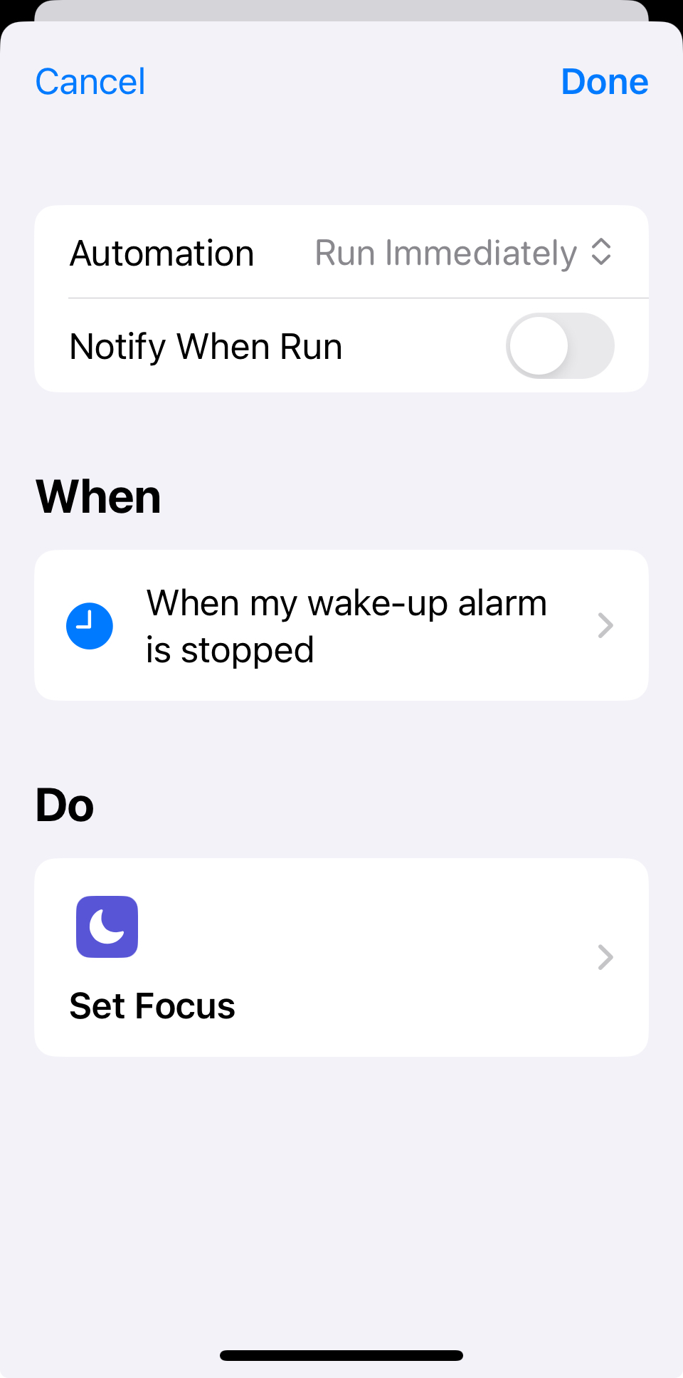

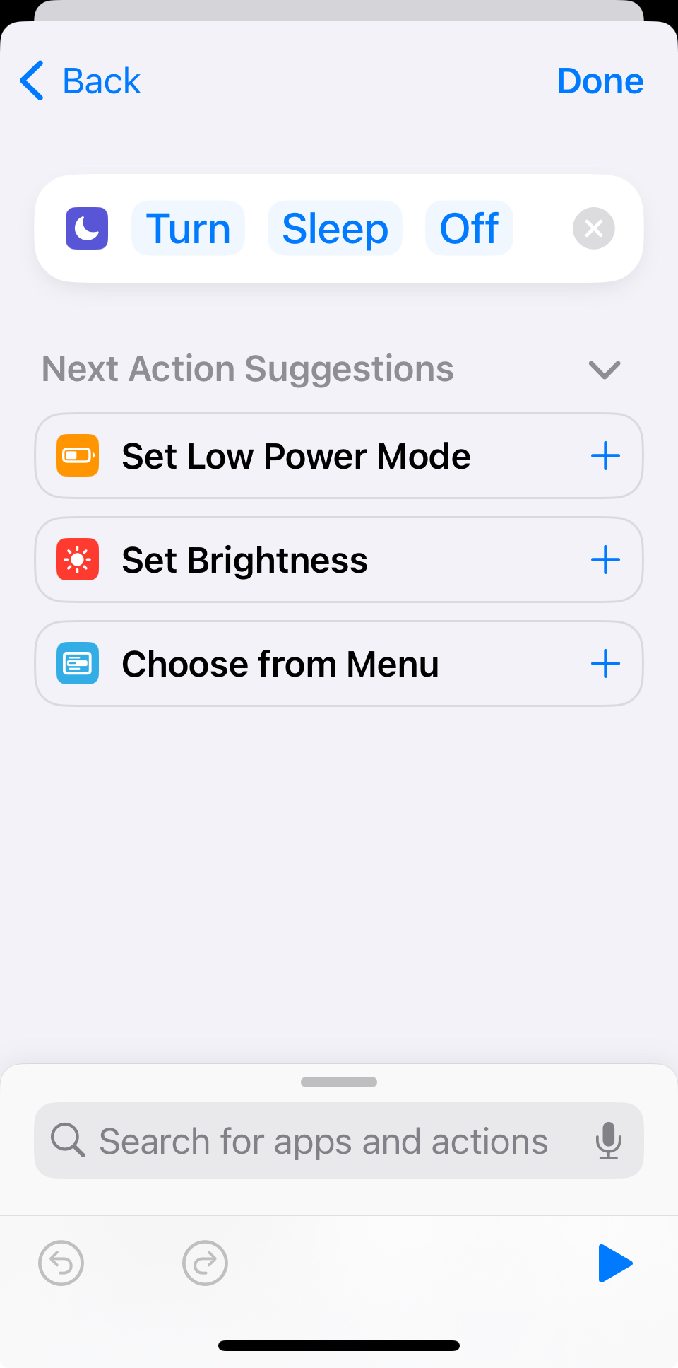

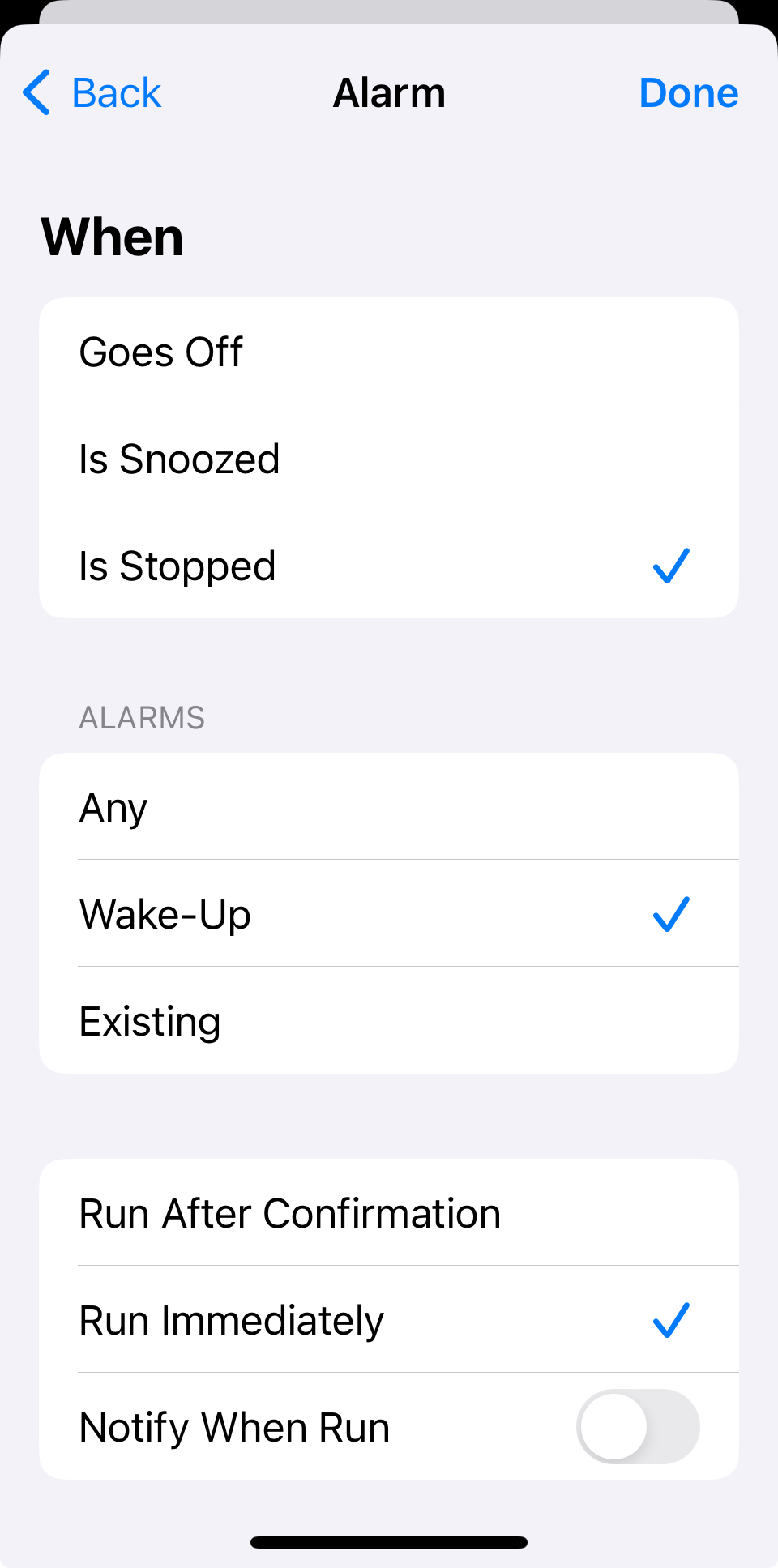

@andreagrandi , @CyndyR --- I was able to work around this issue by using the shortcuts app. This ensures that when the alarm associated with your sleep schedule is turned off, the sleep focus is also turned off automatically without you having to do anything.
