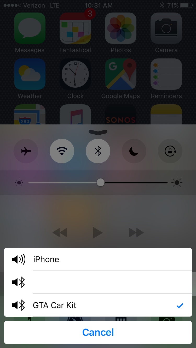

Prior to iOS 9 - everything was fine. The kit I installed in my car auto-connected and disconnected perfectly every time. It would auto-route calls, music, nav, etc through the car stereo and all controls functioned as expected.
Since updating - connecting to the GTA CAR KIT I installed in my Honda doesn't happen 100% of the time as expected. I do not believe it's due to the kit (simply works over A2DP BT profile and works flawlessly (yet, sporadically - which is the issue)).
I do not know where along the line it happens - but, I end up with a 'blank' Bluetooth profile under my AirPlay settings that seems to get in the way of the kit connecting.
A reset will clear it - however, I cannot reset the phone every time I get out of the car and this profile pops up.
After a reset - the kit connects flawlessly the first time, every time. Then, somehow - things get 'off' and it won't auto-connect without some serious finagling (messing with stereo settings, toggling Bluetooth on/off and switching AirPlay settings, etc).

I'm so happy I found your post! I was going crazy disconnecting and reconnecting the GTA kit trying to get the bluetooth to work. I didn't even think it could possibly be the phone. I kept thinking I plugged something in wrong, even though it would always work perfectly after I disconnected the unit from the back.
I am also getting the 'blank' bluetooth profile.
Have you contacted GTA support? Or found a workaround yet?
I will try to reboot my phone and see if that fixes it for me as well, but yeah that is not an ideal solution at all.
Not sure if this matters or not, but mine is for an Audi A4 2008.
My bad! Don't know how I didn't catch your post until now.
After a long go back and forth with GTA Car Kits - they were super helpful and reasonable by the way - they deemed it was something in iOS 9 that changed Bluetooth protocols, etc (they weren't too specific and its above my level of understanding anyway)..
But, they did extensive troubleshooting as did I and they agreed the blank profile, having to reset, etc was not satisfactory - so they came out with a 2nd gen model of the Pure Bluetooth kit for my Honda Pilot. Not exactly sure what models they did this for - possibly select models, possibly all of them - don't know.
They shipped it to me for free and all I did was ship the first one back.
End result - awesome. Works perfectly and as intended (I really hope upgrading to 9.3 tonight didn't break it again haha).
The one thing I wish is that the firmware on the GTA car kit was user upgrade able. Maybe avoid the run around if things go bad again.
