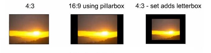

I'm not sure what are you hoping to achieve because pillar box as seen below is the expected behavior.
And you mention you are getting 4:3 with bars on top and bottom, that could be an issue with a certain setting on your monitor. Because normally pillar box is what shows when connected to an external monitor.

I am getting the third look from what you are showing from my monitor, while i thought i would get the second one, at least using the most screen estate as possible. I tried every option on my monitor so i hoped that maybe it had something to do with a setting on my ipad or the dock itself. Thank you so much for answering though.

yeap, that was it! a displayport adapter and a cable did the trick. So reporting about this, hdmi wouldnt work for a fuller screen but displayport did. Only have black bars on the sides now.
