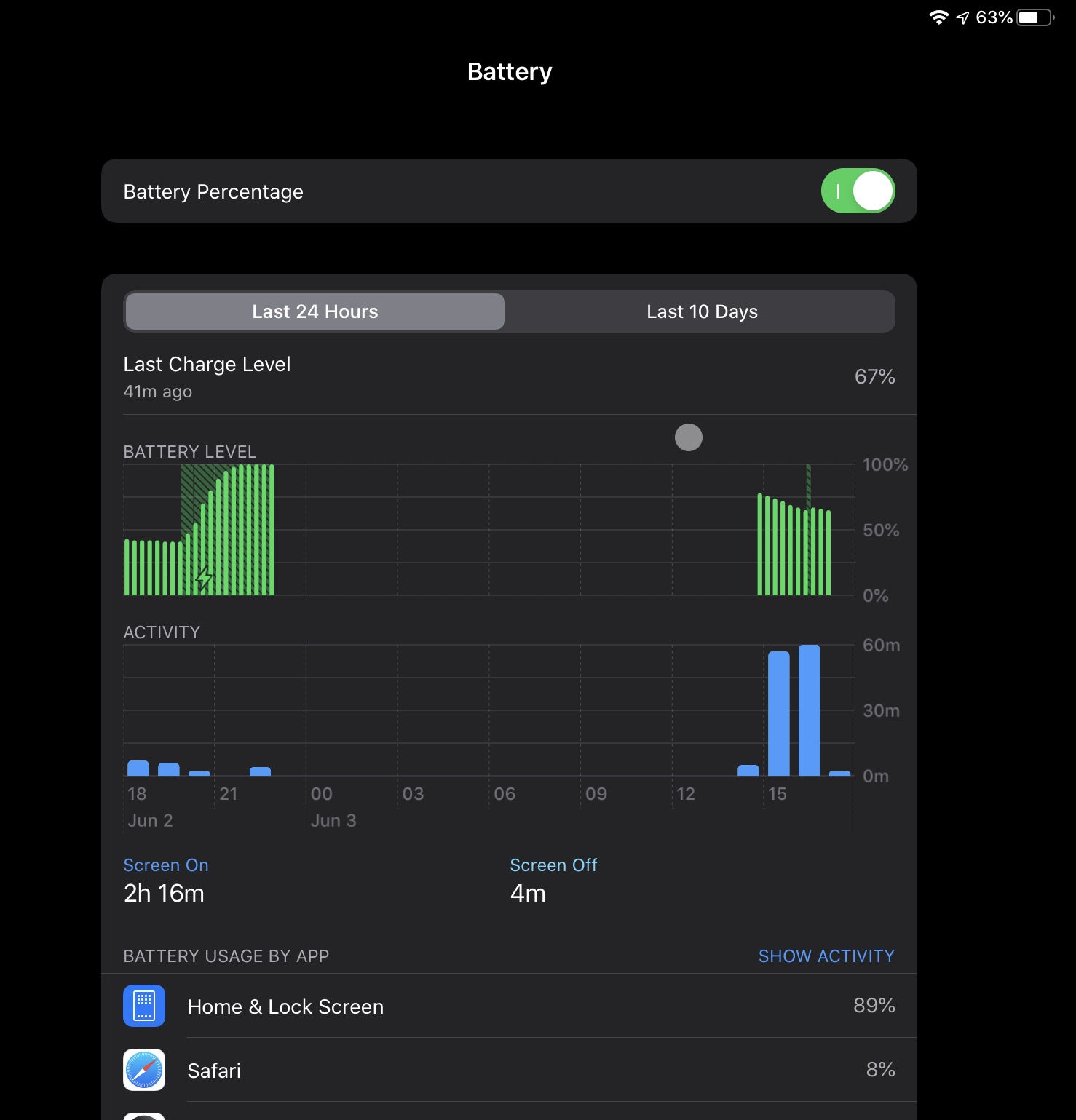

I’m definitely seeing the iPad drain on the magic keypad when it’s closed without power connected. I was at 80% charge and did not use it for about 2 days. Today I went to use it and found it was at 14%. That sucks! I saw in a earlier post that shutting off WiFi helped. I could just take it off the magic keyboard but I really don’t want to do that. I have the 12.9 iPad Pro. And the actual iPad alone has great battery life. I’ve only had my magic keyboard for a couple weeks now. Could this just be the newer ones?

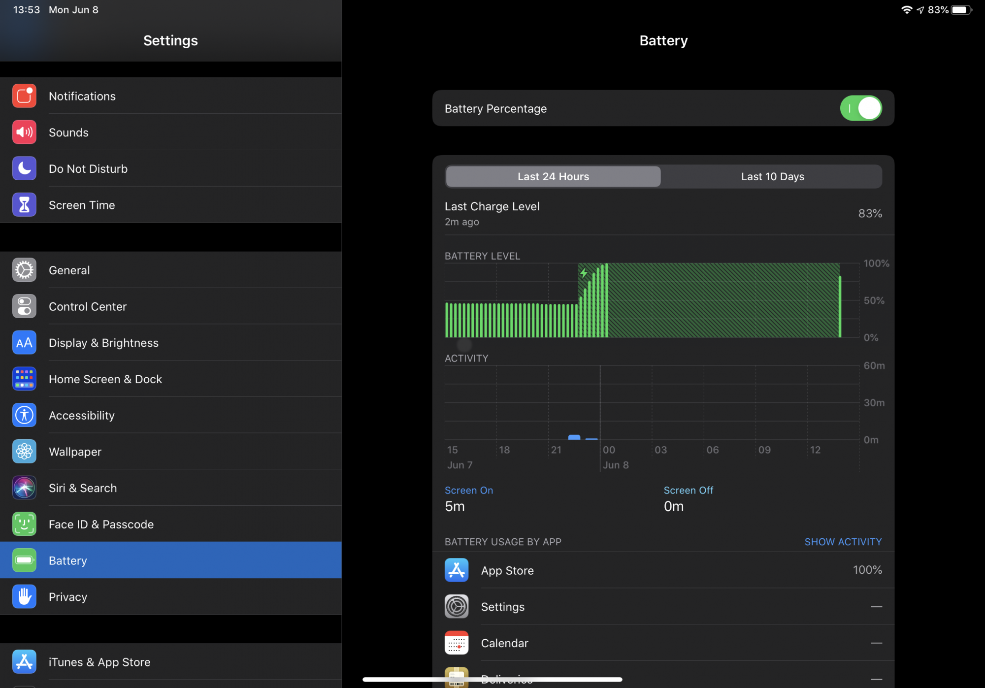

I performed my test again, and now I am irate.
I fully charged my iPad to 100% last night. I turned it off (full shutdown) and made sure the keyboard backlight turned off. Today, after almost 13.5 hours, upon turning it on, it was at 83%. (Also, the iPad thinks it was charging all night as evidenced by the shading even though I disconnected the USB-C cable prior to shutting it down. I’ve never seen that before.) I am past the return period, but I am exploring my options.

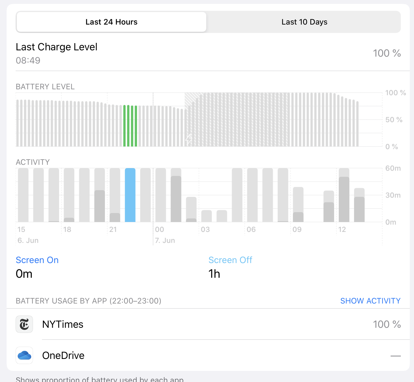

However: There appears to be an issue with apps like OneDrive and the NYTimes “constantly” refreshing in the background? Seems to be more of a software issue with iPadOS 13.5.1, than with the magic keyboard, though, and it didn’t noticeably affect my iPad Pro’s battery while it sleeps, as far as I can tell.
I explained the background activity drain two posts above yours (post #40). If you haven't already, please submit a bug report to Apple. I have, but they need to be made aware that it's a pervasive issue.
I’ve filed a report to Apple. In the meantime, I’ve deactivated Background App Activity for OneDrive and that has resolved the issue.
