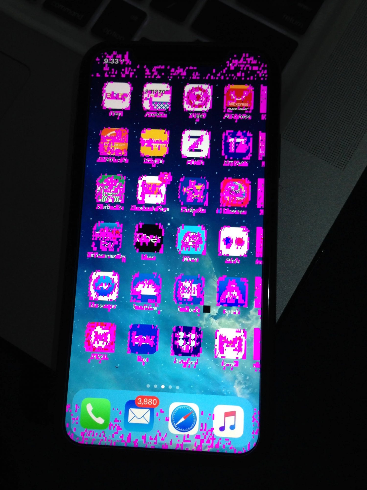

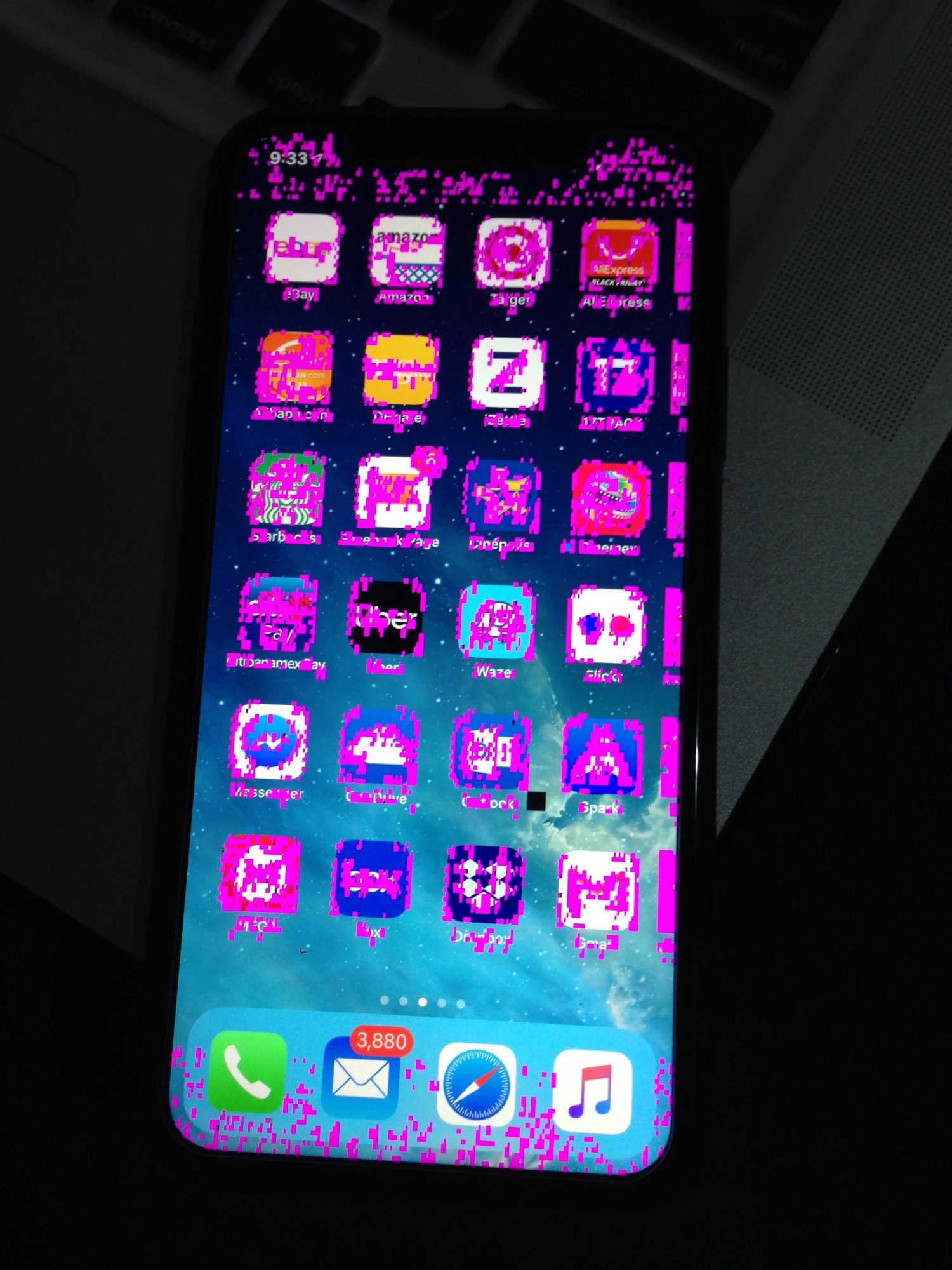

This evening, I was watching a video on my phone, and it bugged out in a way I’ve never seen before.
The phone suddenly froze and displayed some pink artifacts on the screen and made a short static-like noise. The phone remained this way for about 15 seconds. After that, it restarted itself.
This has only happened once (this evening). Apple iMessage support chat of course was no help. The diagnostic said the display is fine (it’s not the display but whoever is on the other end is really good at sticking to their script).
I’ve attached a photo. It’s not my own; found on Google. But it looked almost exactly like this. Anyone else ever see this before?
I sincerely hope I don’t have to deal with Apple Support again. They are a freaking nightmare.

Wow, it looks like someone took a pink marker to it. Do you live close enough to an Apple Store to make a Genius Bar appointment?
This is my first time seeing this. At first glance, it looks like a screen problem. Did you recently dropped your phone or something?
If not, have you tried to factory reset your iPhone? Factory reset should rule out if this is an OS issue, otherwise, your screen might be damaged.
Edit: Try doing a restart first. Lol. I forgot.

The display was replaced about a month or two ago for the green tint issue.
However, I’m hesitant to say it’s the display. I’m not sure why the phone would freeze and emit a sound.
Apple Store is very close but I have a bad reputation there, it seems. I got the same advisor for two different issues and both times he gave me the run-around. Pretty sure they think I’m a grifter or something. (“AirPods exhibiting the whooshing sound in ANC? There’s no way I could possibly test that except by flicking through my iPad!” “Display has green tint in the dark? Well, not according to this iPad!”)
That happens in computers sometimes too. Usually coming from a hardware failure or glitch such as the graphics card. Stop by an apple store sometime. I bet they tell you everything’s alright though. It probably won’t be able to be replicated. Or an issue found unless it happens again. In front of an apple person. It could have been just a freak glitch or an underlying hardware issue. Is my guess.
It could very well be a pinched screen cable as well. It honestly could be a few different things.

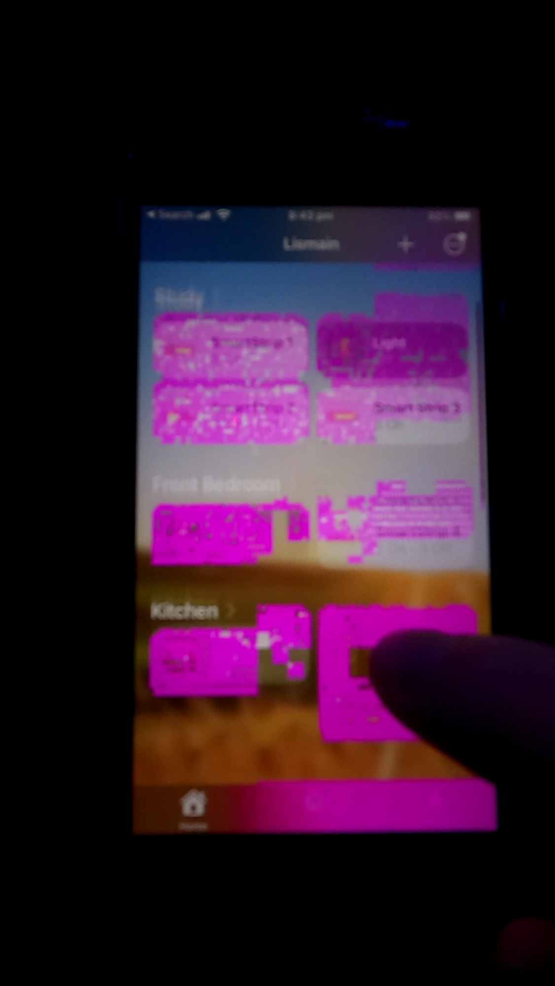

Just came here to say I've been experiencing the EXACT same issue with my iPhone SE (2020) after upgrading to iOS 16. Upgrading to iOS 16.0.2 didn't solve the problem either. I'm inclined to think that this is a software rather than a hardware issue given that it only started happening since I installed iOS 16 and I've never seen this behaviour before then. For me, some apps are affected more than others - such as the Home app when I scroll up and down through my smart devices or on the new customisable lock screen - intermittent pink glitches and occasional pauses. XBox mobile app is badly affected too - yet if I fire up some Apple Arcade games, they play absolutely fine without any issues.
I've tried soft and hard resets, recovery mode reinstalls, DFU mode reinstalls - but no luck with any of them - unfortunately iOS 15.x is no longer signed by Apple so I can't go back to those versions (at least not via official means, i.e. iTunes) - I wish I'd taken a local backup via iTunes before upgrading although this is the first time I've had such issues, at least then I'd be able to roll everything back - normally I just do the regular iCloud backup before upgrading but that doesn't backup iOS, just my app configuration, data and photos.
From what I can see, the issue doesn't seem to be widespread, but in some respects it's reassuring to see that I'm not the only one.
I've attached a photo (sorry its a little blurry) but you get the idea...

I've seen a few different posts were people have said it caused their phone to restart - it's never gone quite that far for me - just temporary pauses where the screen becomes unresponsive before continuing. In my case it started happening immediately after I installed iOS 16 - I was looking forward to trying out the new customisable lock screen - as soon as I went to tweak it for the first time thats when I started to witness this behaviour - I was kinda hoping this would be a more widespread problem that lots of people were reporting and that Apple had identified an issue to be addressed in the next release but it would appear that the numbers of people affected by this is relatively few - at least not a large enough volume to result in lots of articles on tech websites discussing the problem.
Is this the first time you've experienced this and do you recall what you were doing on the phone at the time it occurred?

Yeah - I tried to enable screen recording on mine before going back into one of my affected apps and the phone completely hung on me - had to do a force restart - tried this multiple times with the same end result - and taking photos directly on the device was largely unsuccessful with none (or very little) of the pink artefacts being captured in the image.
My phone hasn't been dropped (or had anything else dropped on it) - I generally take pretty good care of it, so I feel (or at least hope) its not a hardware issue - as I said earlier, this issue started occurring for me as soon as I booted iOS 16 for the firs time - but is seems that some people have been experiencing very similar symptoms before iOS 16 was released - the OP post was back in Sep 2021.
