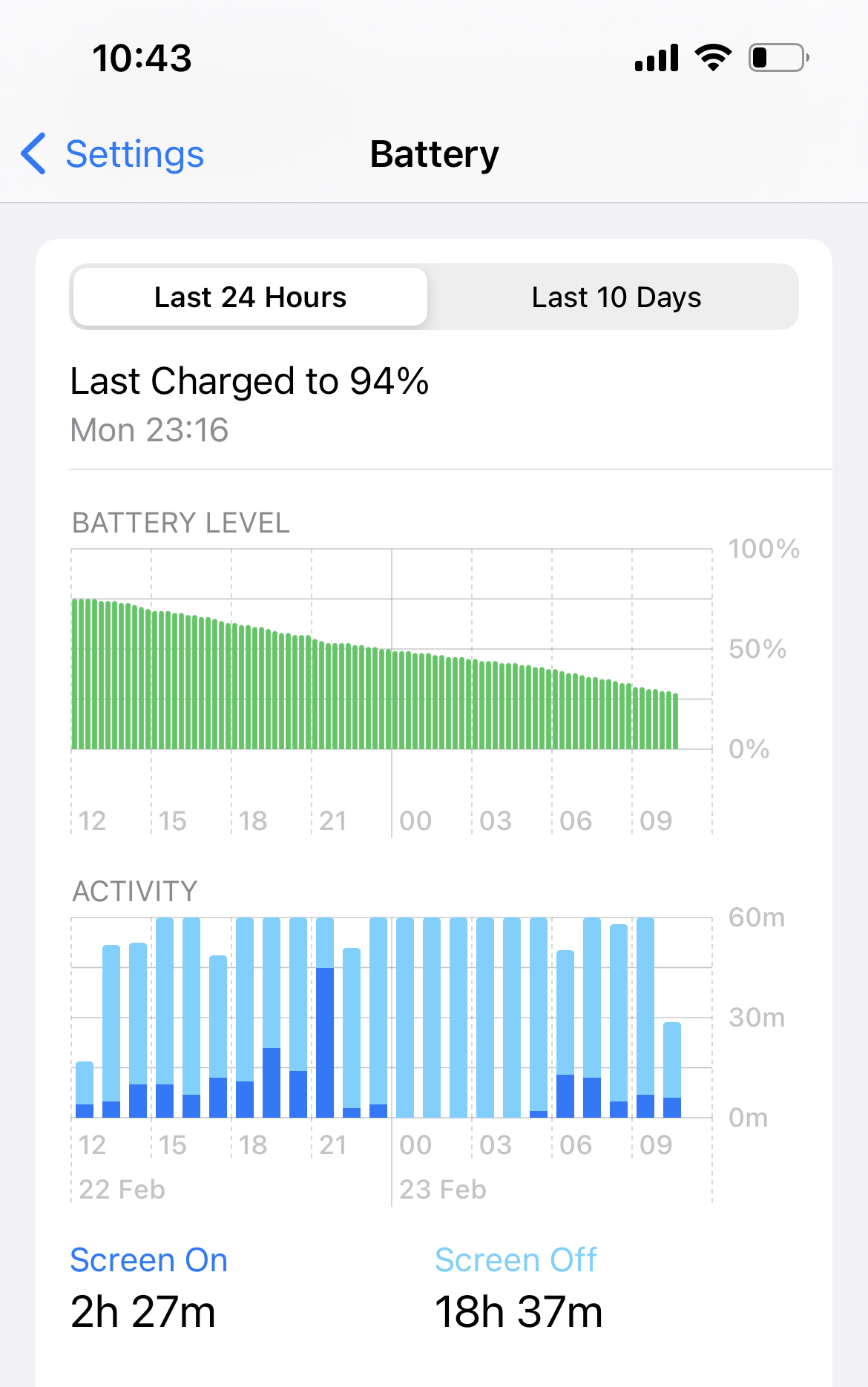

I tried to maximize the battery life and have optimal setting for this test: everything is switched off:)
I need to say that I was expecting more. I think I will only have 3 hrs of screen time on a battery.
That is pretty poor. What is your situation?
  • Wow
Reactions: Cobold
No surprise looking at your screen-of activities (light blue bars)... o_O o_O o_O o_O

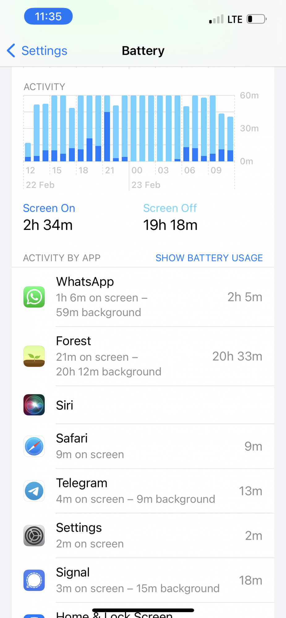

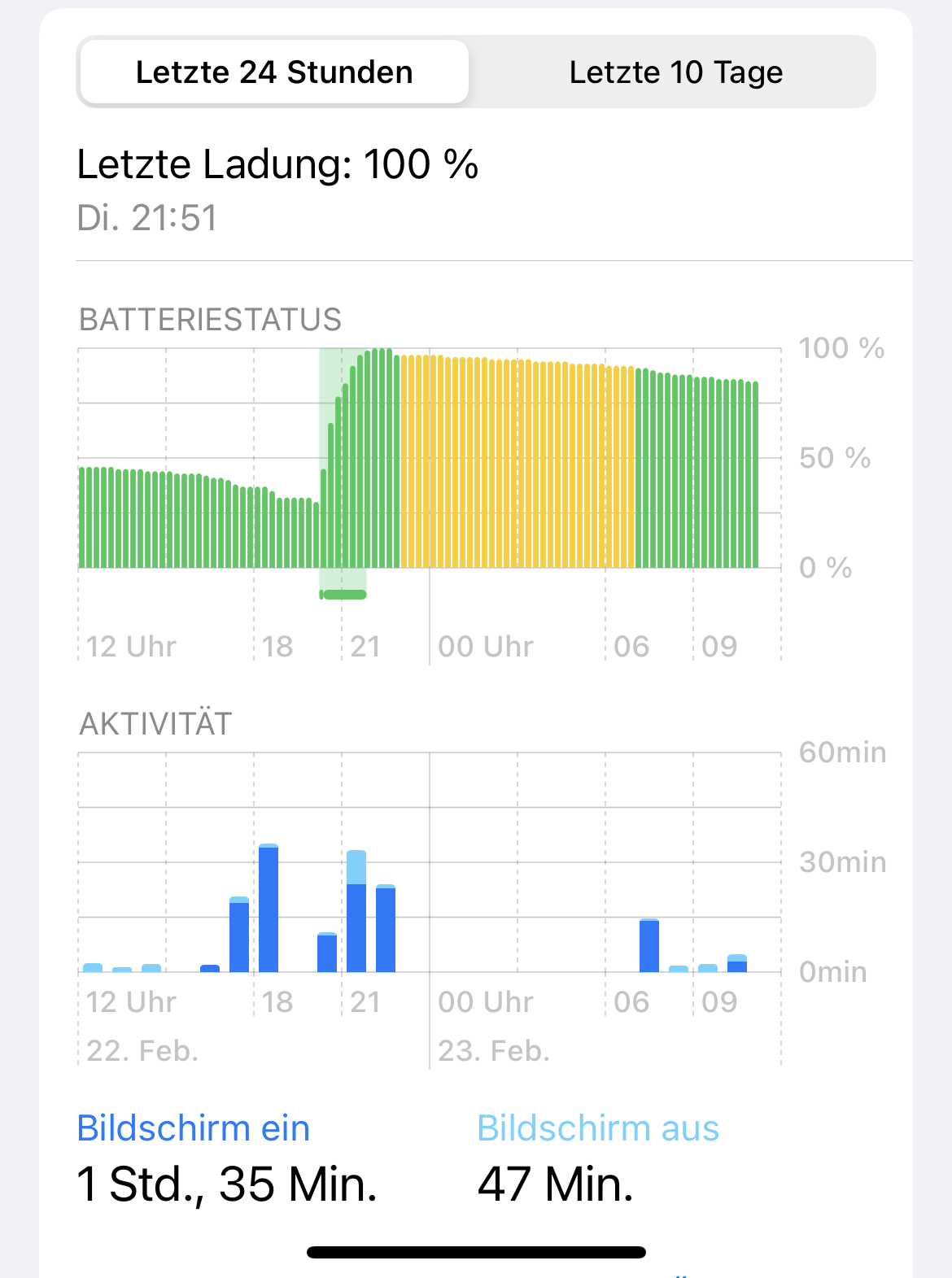

There is something major going on 60 minutes almost evey hour! Could you share some details about the apps that are running? I have close to NO screen off apps running and thus getting GREAT battery life with my 13 Pro!
Reactions: Saladin12

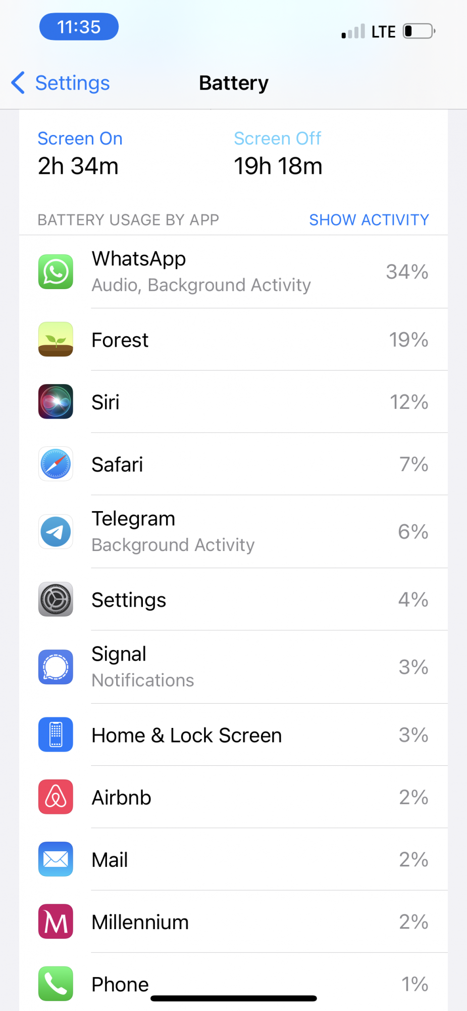

What ist that "Forest" App?
That seems to be your problem! More than TWENTY hours of screen off/background activity?!?! WTF?
Disable background refresh for that app. Or kill it after usage.
Or - my 1st solution - get rid of it! An app running almost every minute in the backgroud would fly off my phone in no time!
Reactions: Reggaenald
Yo, delete that Forest app. Not only does it suck life out of your battery, it also accesses quite a lot of data of yours.
