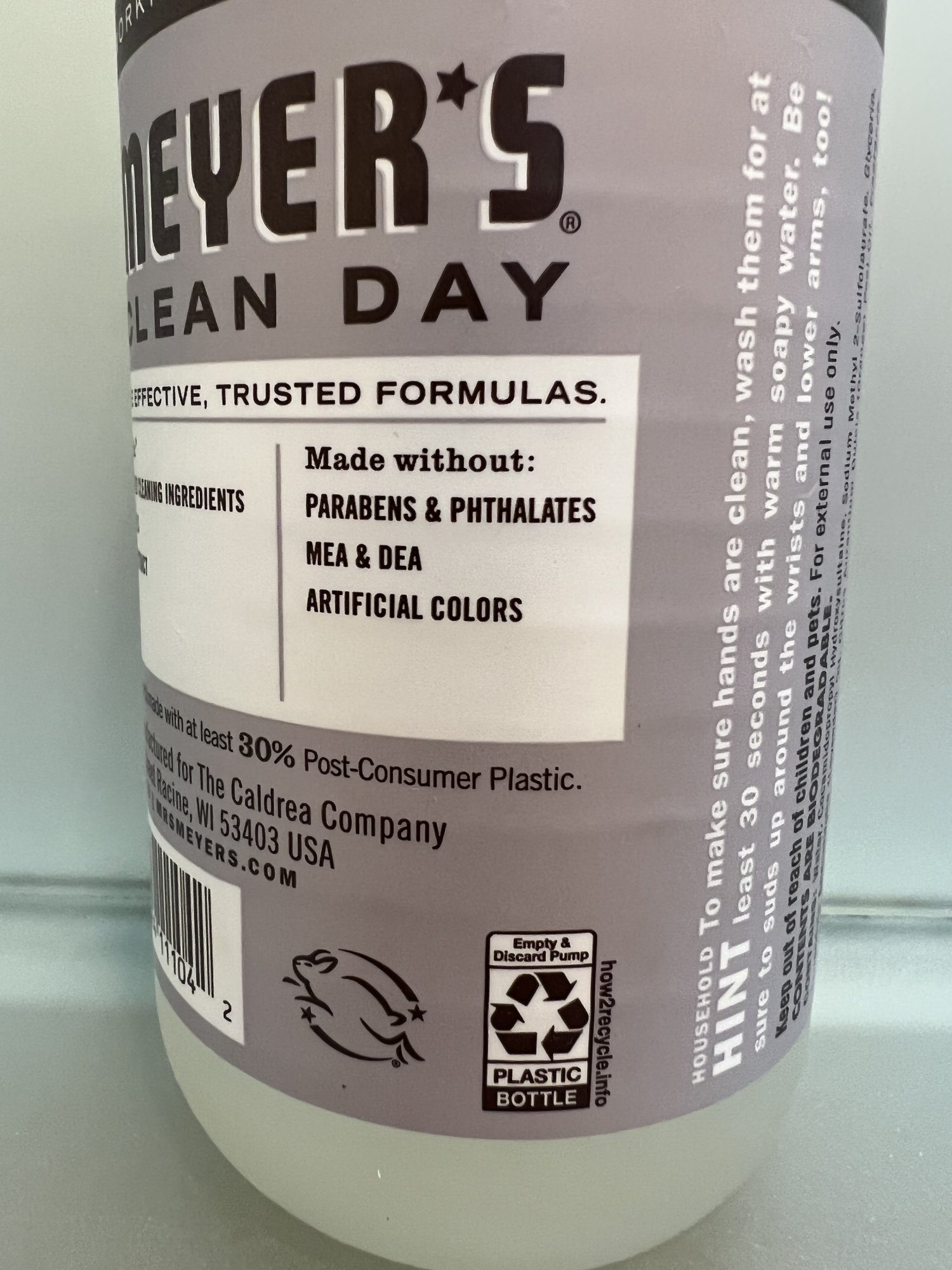

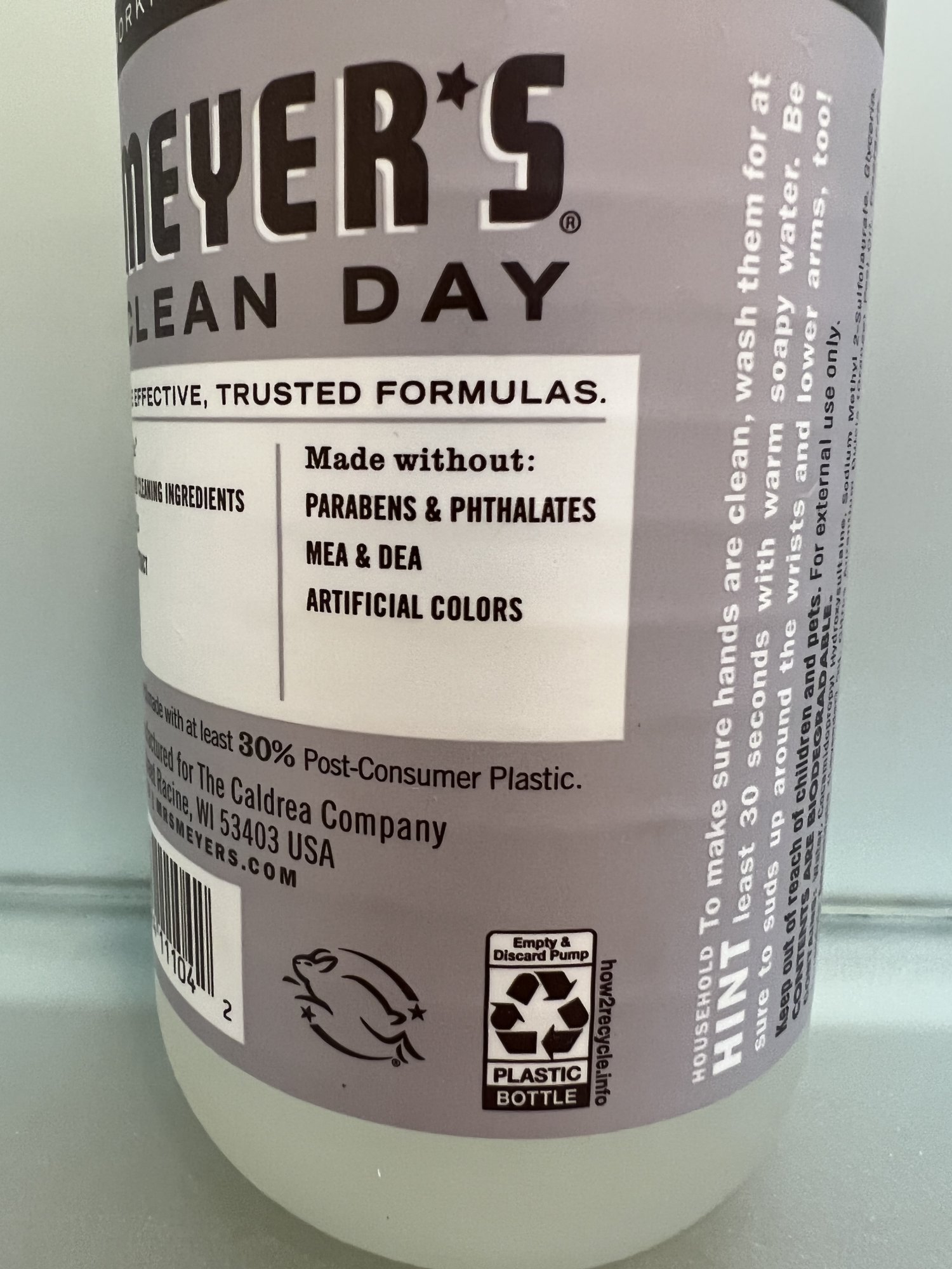

Some lenses are known for being soft up close and wide open (X100 until the V). I think this is processing.. even with the RAW (I know..) because it looks more like the old smudging issue from the 7. Look at the text in this image. Compare the large area of text to the text above the recycle logo. That text looks smudged.

I think Apple decided to oversharpen fine detail to enhance the perception of sharpness. Sometimes the result are weird, with super sharpened part of the image and softer ones, like in the one you posted (the big text in the upper part is soft, then line just under is super sharpened). They might tune the software differently, but the fundamentals of the main lens are here to stay. How well, I’m keeping it so let’s see

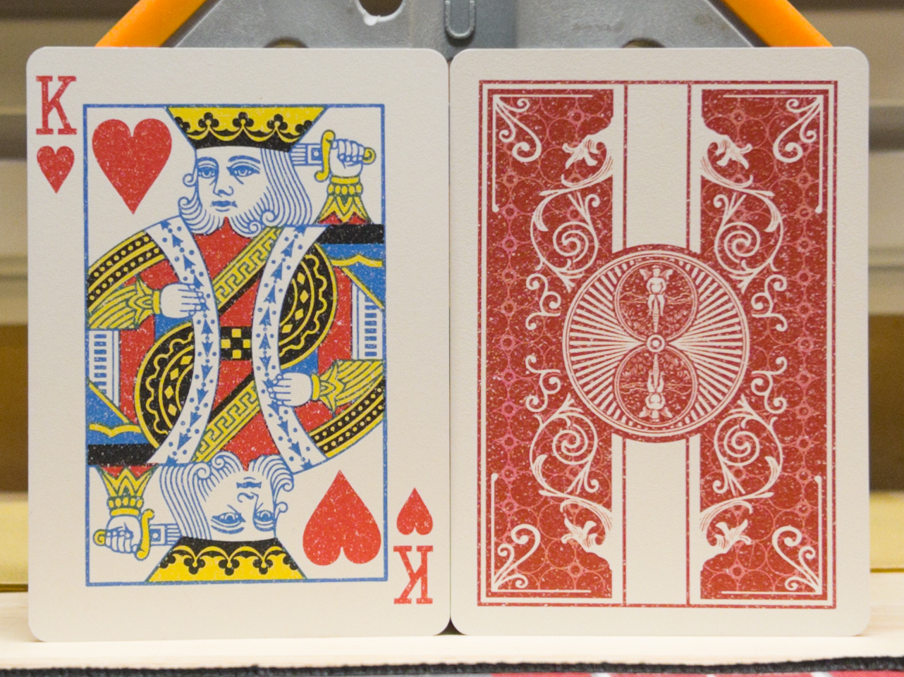

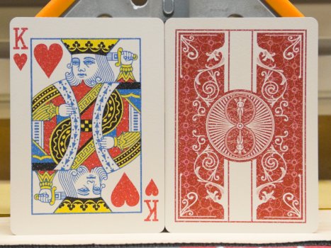

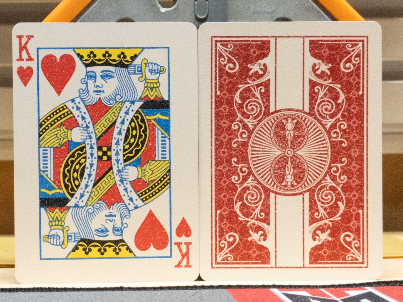

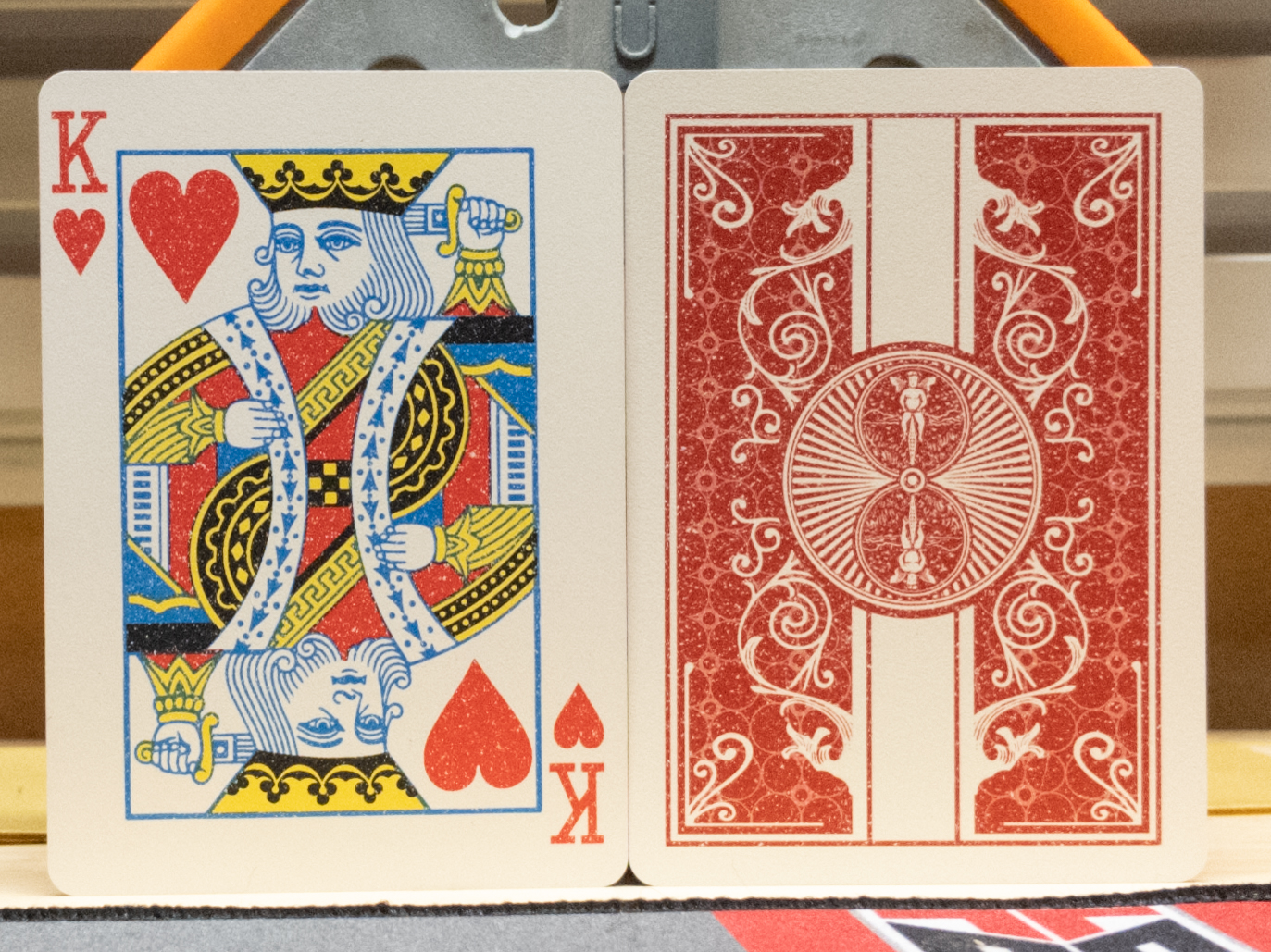

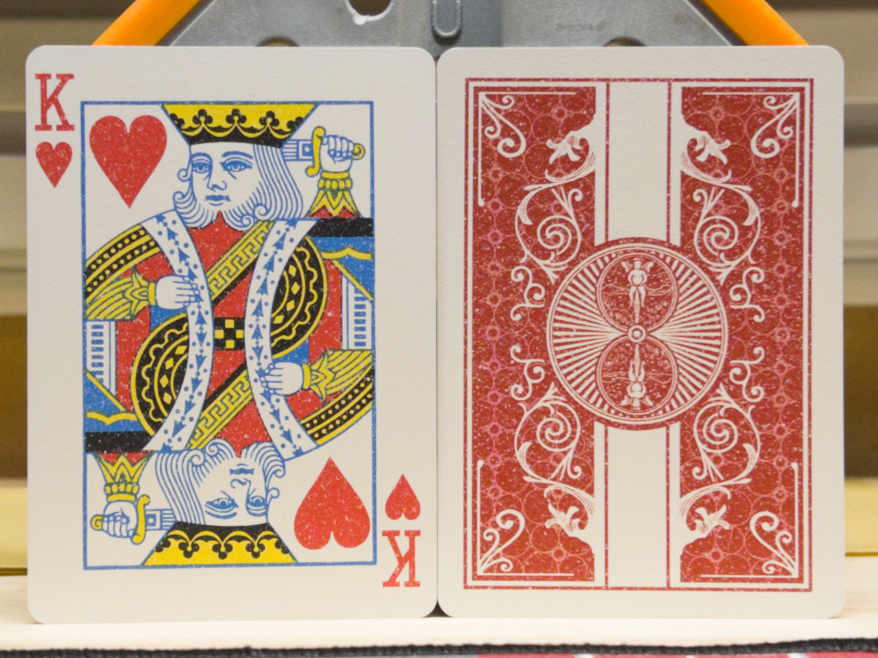

My 13Pro came in today and I did a quick comparison with my Pixel2 (essentially the same as the Pixel3). This isn't scientific as I don't have a phone tripod and framing is a little different (it does seem like the Pixel puts more pixels on target, which could account for some difference). To my eyes at least under these conditions (indoor artificial light), the 13Pro is slightly softer than the Pixel2. The difference isn't nearly as drastic as some examples shown with other conditions and subject distances. I would say this looks to me like possibly slightly lower resolving optics or possibly a stronger AA filter (do phones have AA filters?). The difference here could be made up with +10 on the capture sharpening slider in LR. More testing needed for sure.
Photos should be downloadable and exif intact. Included full jpeg and 100% crops. These are DNG files captured with the LR app in each phone, processed in LR Classic, zero sharpening, zero NR, zero export sharpening.
ETA: the sharpness discrepancy in these examples should absolutely not be an issue at display resolution and post starpening. Really hard to say what is going on overall. Will get out and play in the daylight tomorrow.
ETA2: Attached previews, hit the link for full res and 100% crop files.

I suppose that to a much more limited extent this filter is also applied in shots with plenty of light, like the card one @dallegre has posted above, the pixel 2 photo has more noise while the iPhone 13 photo is softer.
The exposures are:
iPhone 13: 1/120, f/1.5, ISO 80
Pixel 2: 1/125, f/1.8, ISO 125
So there's the expected ISO bump due to the narrower aperture on the Pixel. The IMX362 of the Pixel holds up damn well.
What's baffling is that some of the worst iPhone13 "softness" examples are in broad daylight with grass/leaves. That would be more light than in the scene I used. Imo (at this point at least) the 13 is making weird decisions about which textures need smoothed and which edges need enhanced. Or maybe things just break down optically at longer subject distances.

Thanks for the samples. To me it still looks optical performance, because as you noted also happens with lots of light. What’s funny is that portraits with the front camera are sharper than ones with the 1x camera 🥲

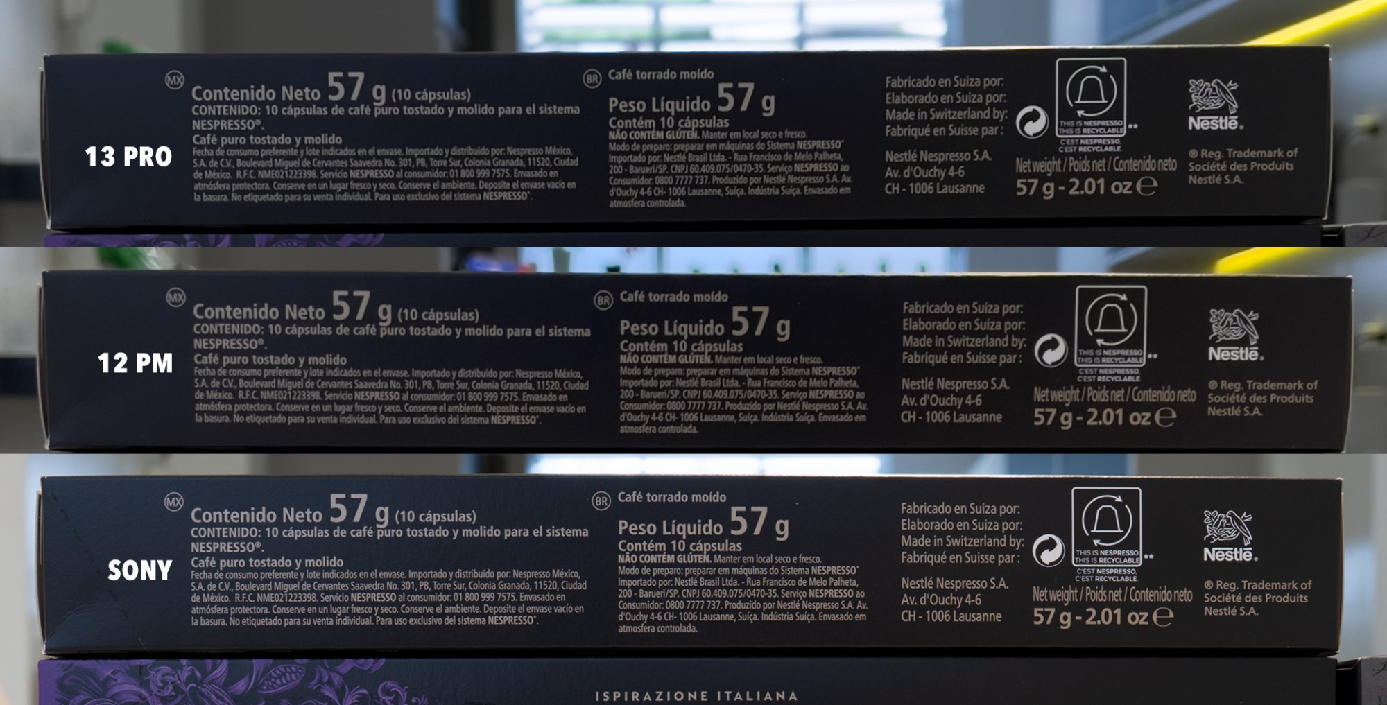

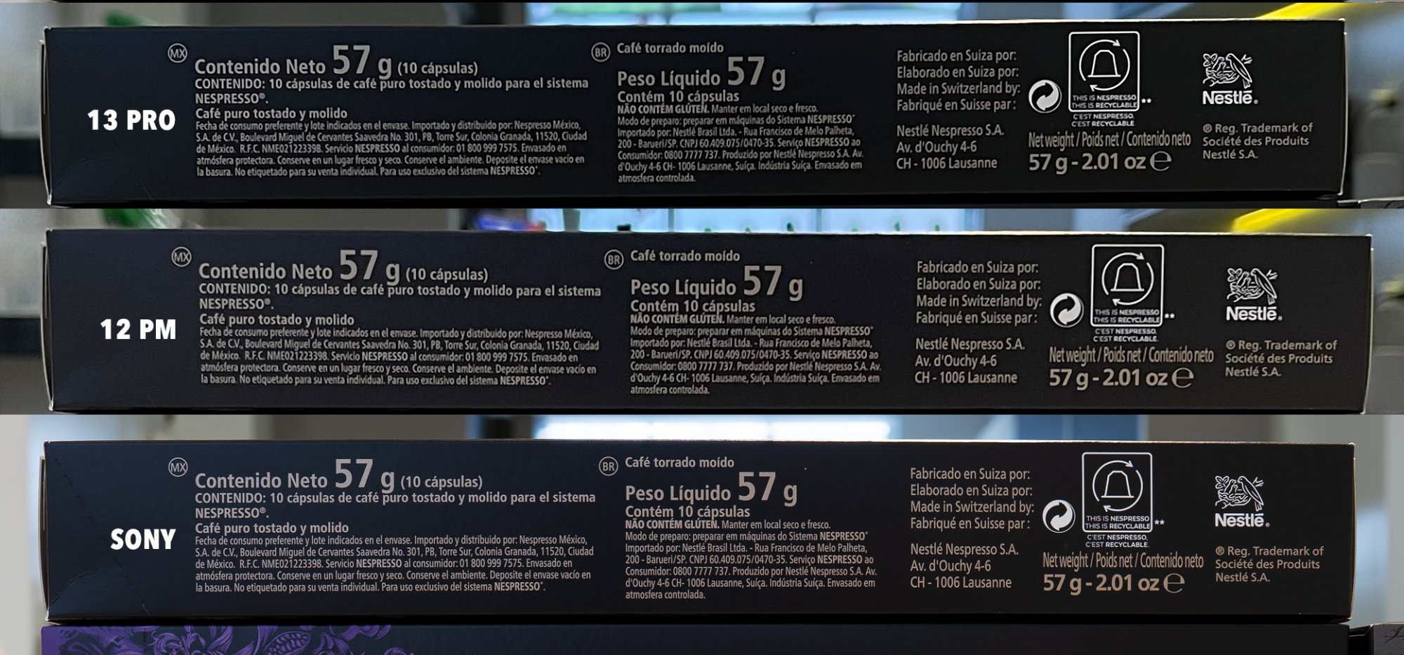

I've been following this thread and yesterday I was able to get my hands on a 13 Pro. I've been testing it against my 12 PM and honestly I can't see any difference. The post processing that Apple is doing to the JPEG/HEIC files is slightly different, but once you switch to ProRaw they look about the same.
Here's a comparison between the 13 Pro, 12 Pro Max and a full frame camera using the Sony 24mm GM (which is as sharp as it gets for this focal length). If anything, the 13 looks slightly sharper.
These are all ProRaw/Raw imported to Adobe Camera Raw with default settings and sharpness set to 0 (full size)

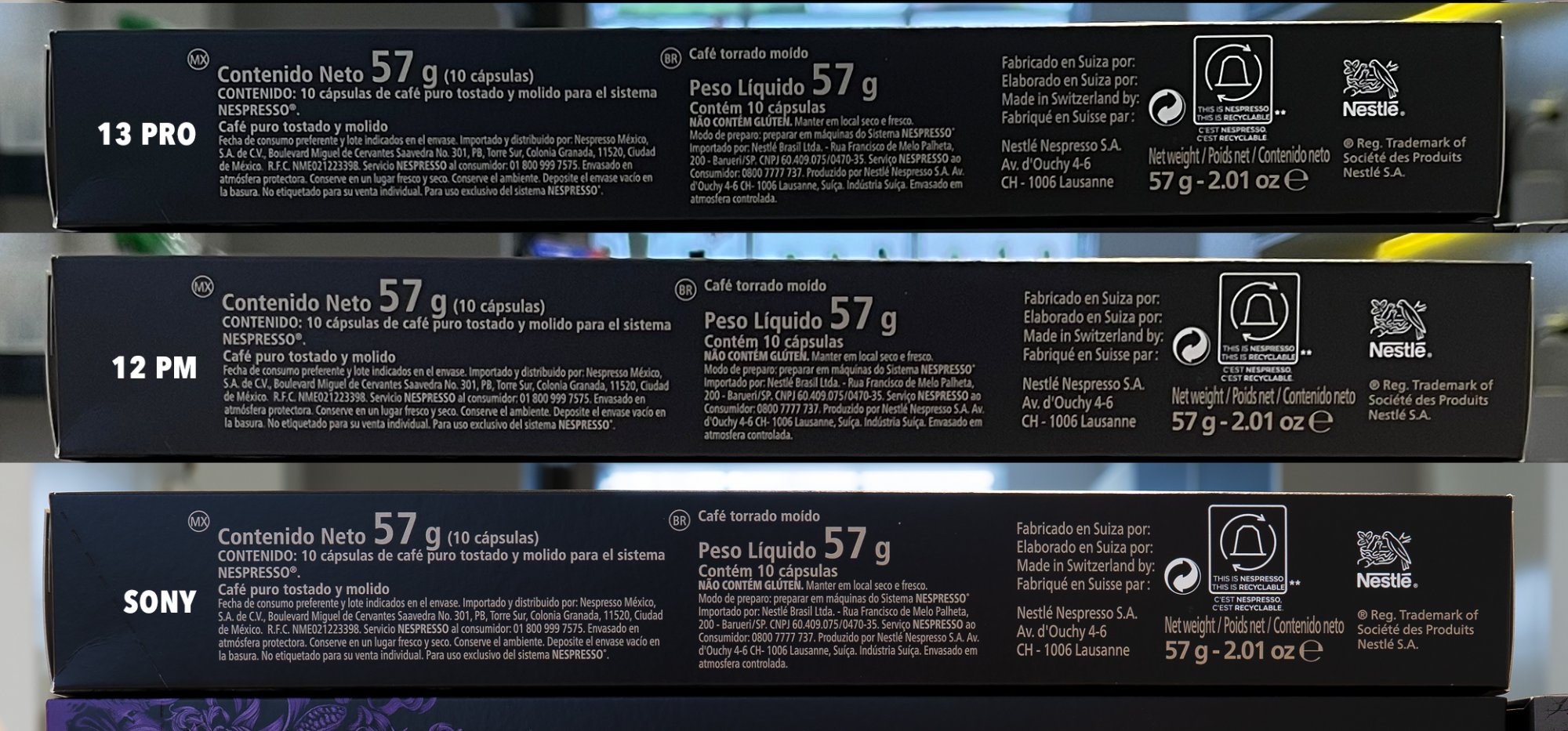

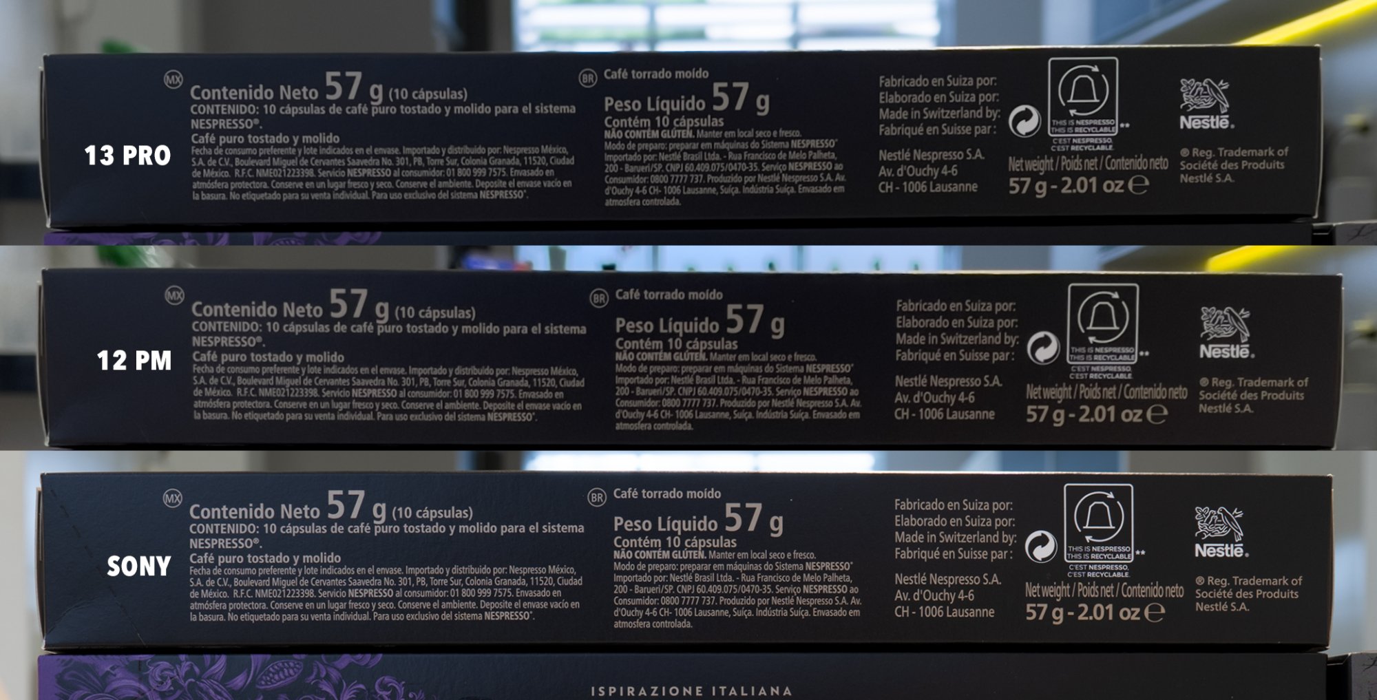

Edit: If anyone is interested, here is the comparison of the HEIC/JPEG files (full size)
You can download the full size JPEGs here:

That's certainly an encouraging result. I was thinking about doing the same with the 24GM, but you beat me to it!
The Sony is clearly much better. The 12 is on par or slightly worse than the 13. Maybe the sharpness started lowering since the 11 with the bigger sensors? Probably the smaller sensor of my 8 made it even sharper
