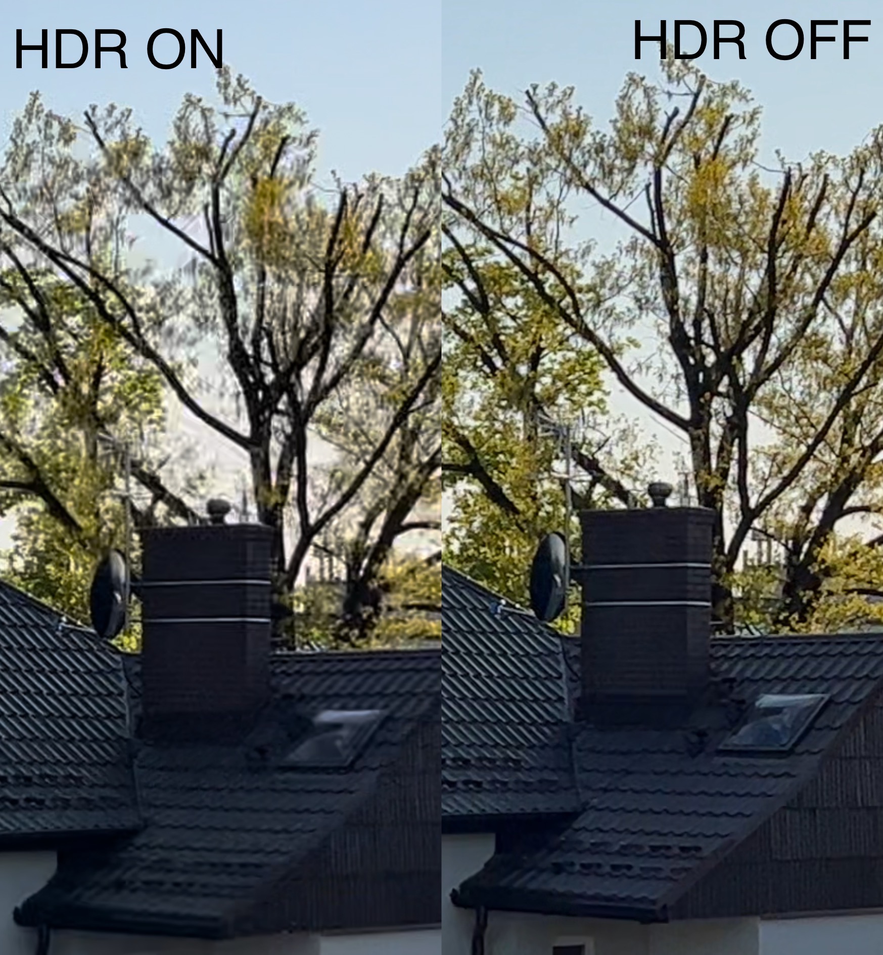

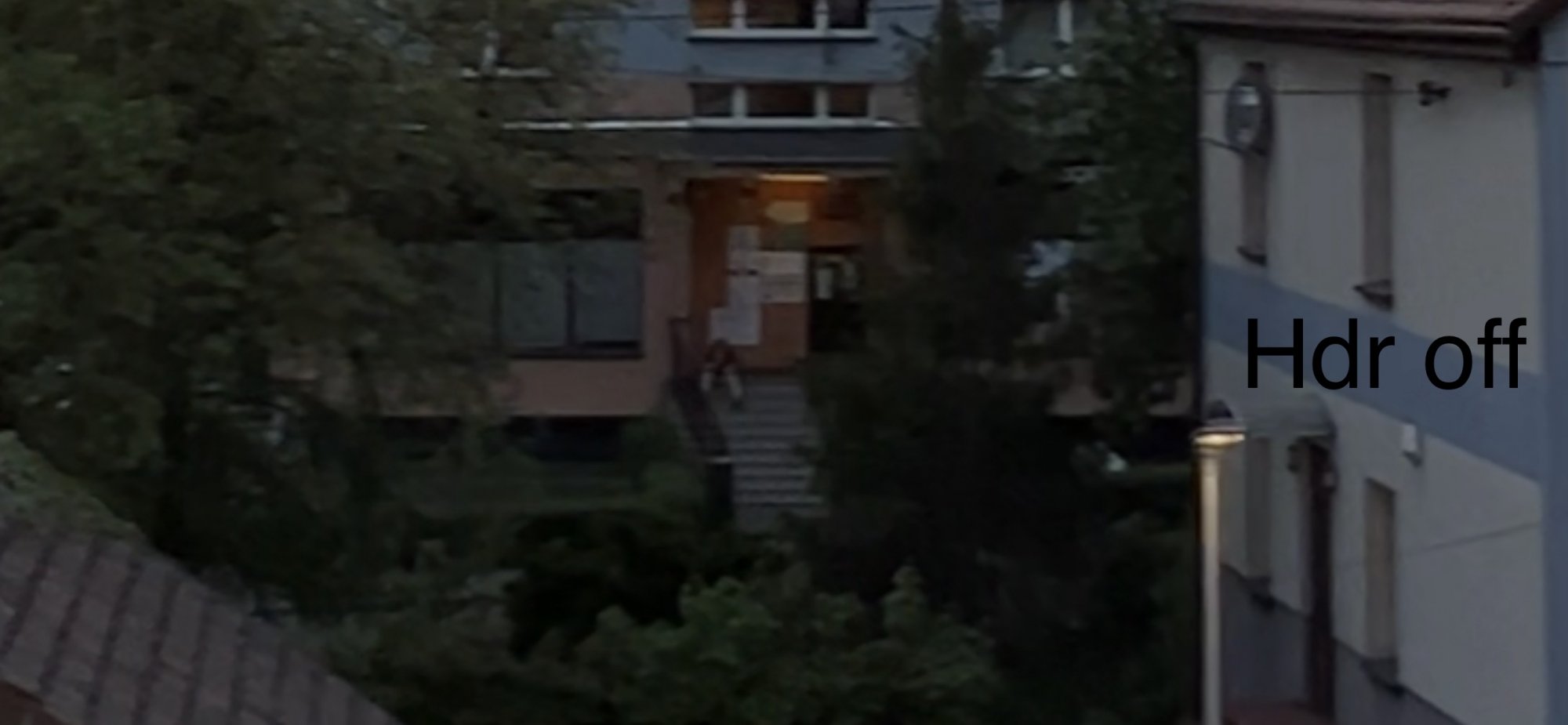

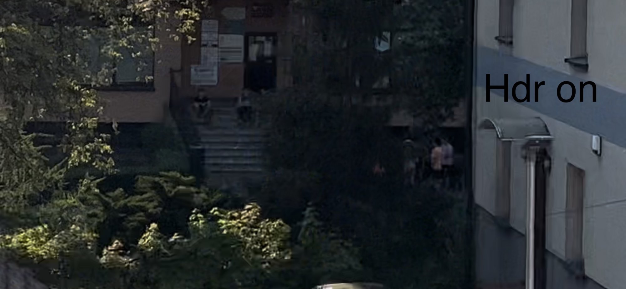

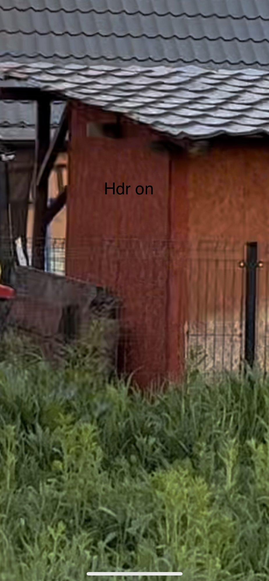

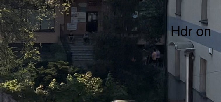

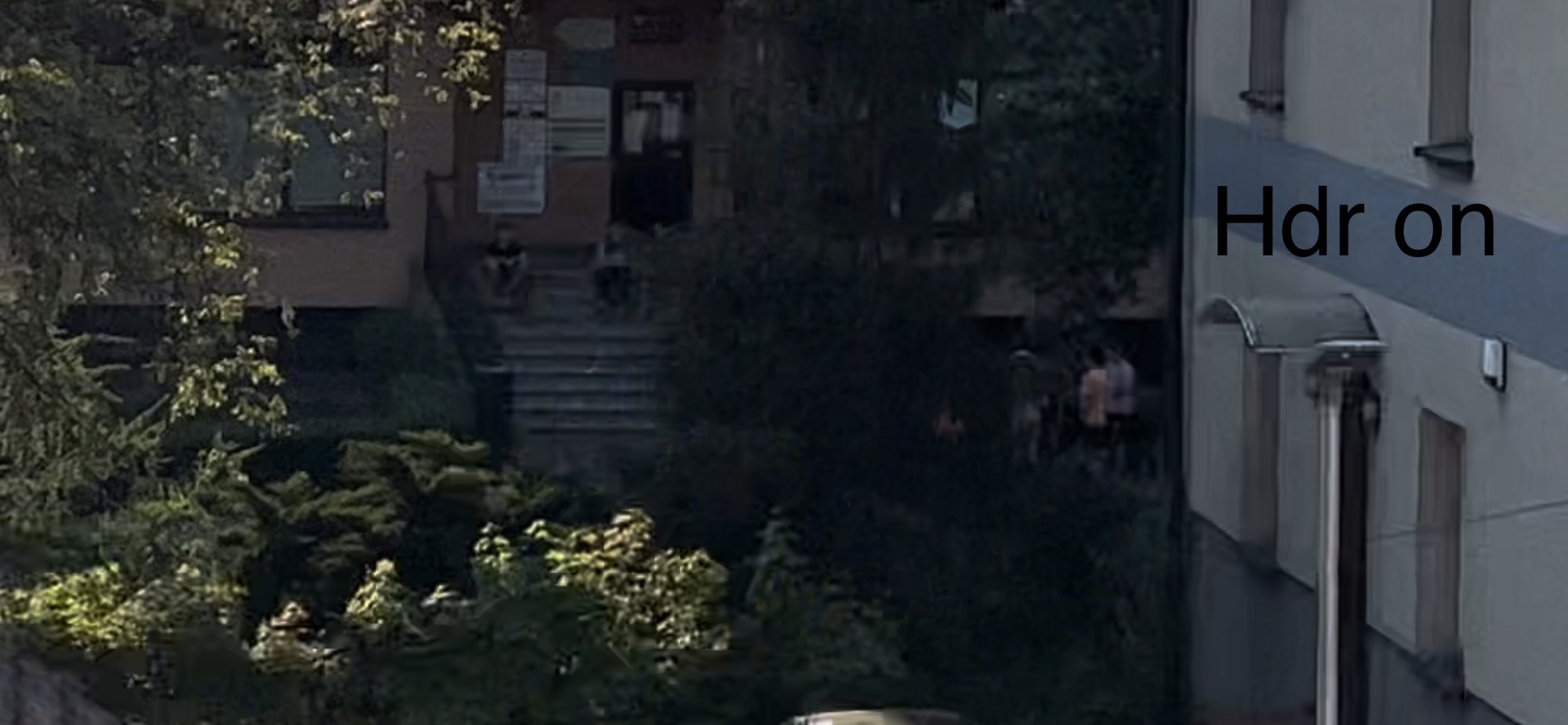

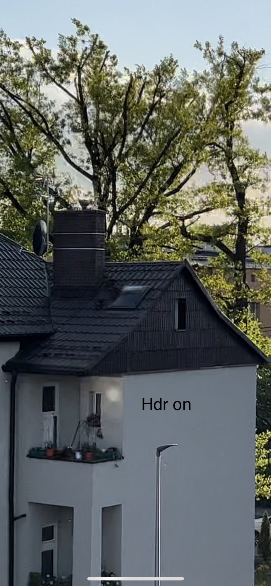

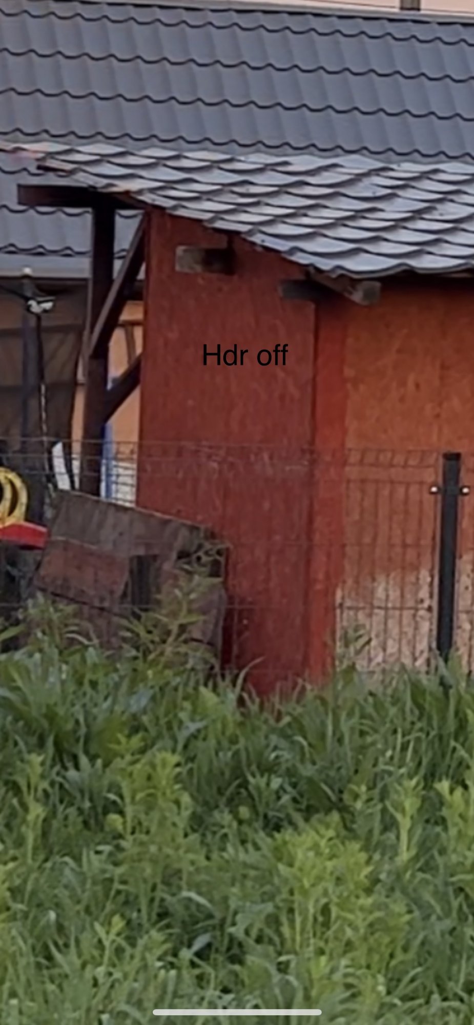

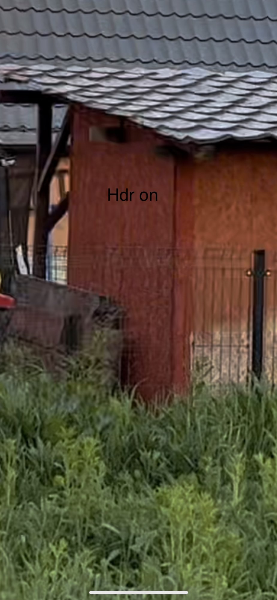

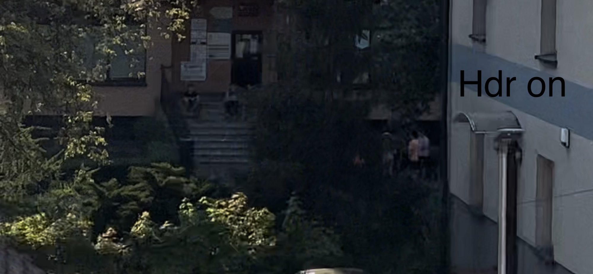

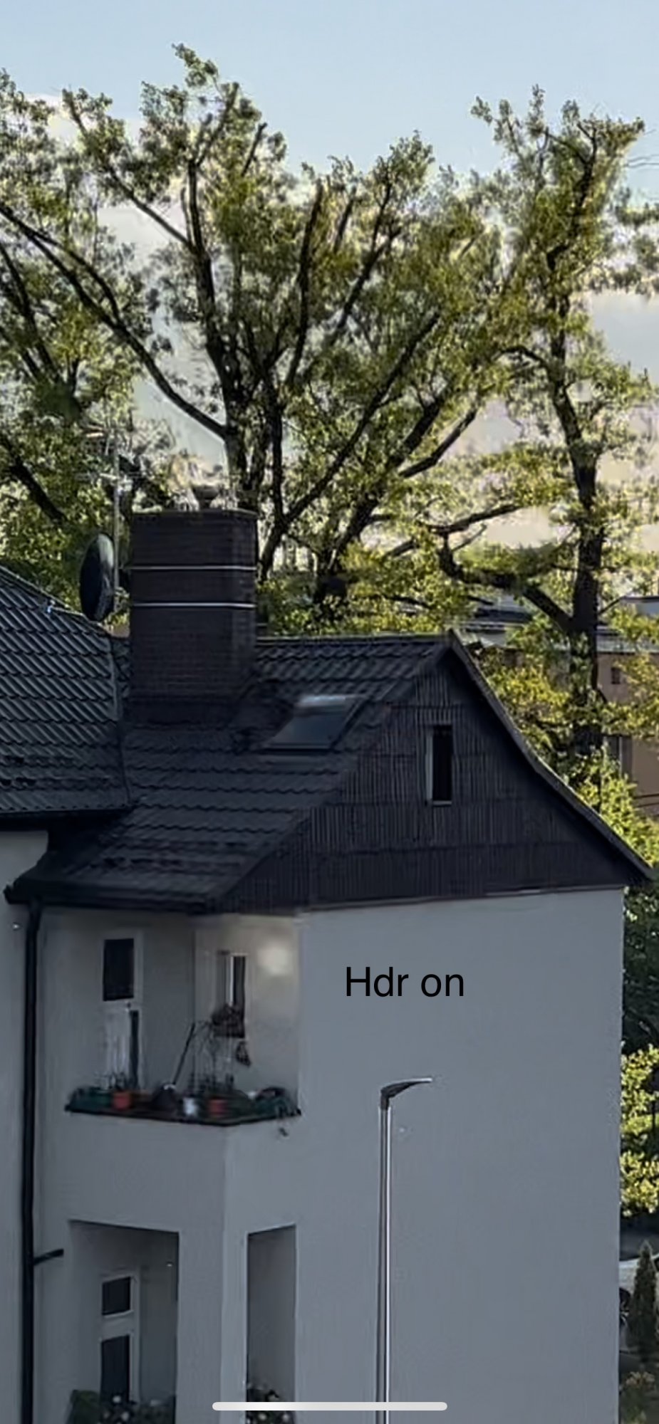

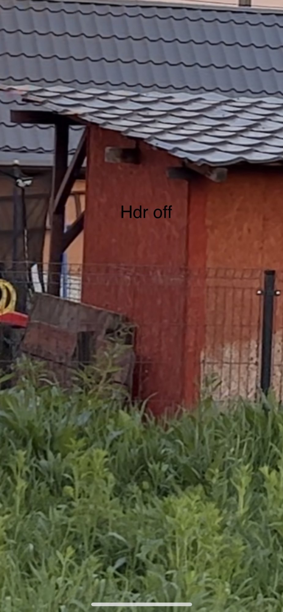

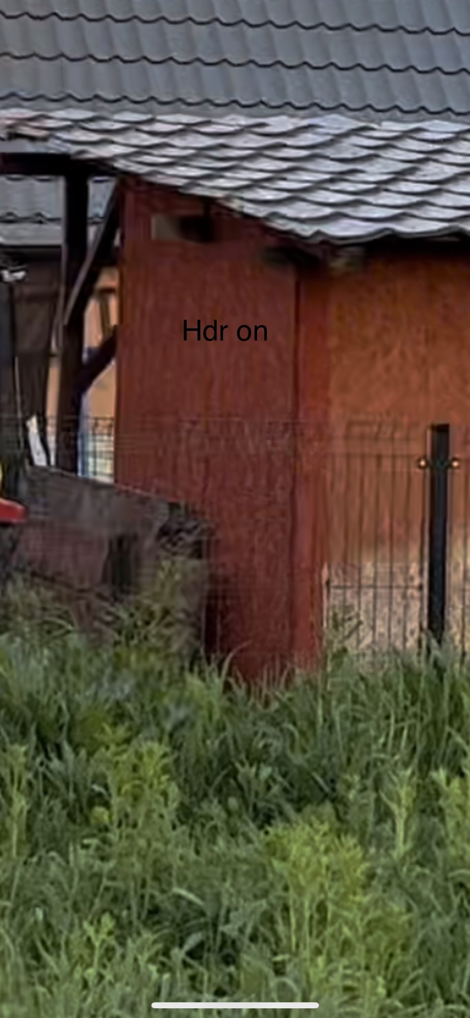

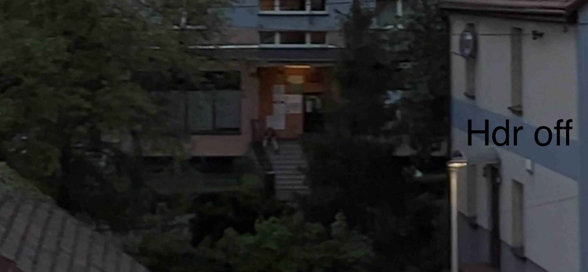

Actually I can confirm this! From the very first day after purchasing the 13 Pro i noticed the grainy effect in 4k 60fps HDR video recordings. I have bad news for you: this "grain" or noise is actually... video compression artifacts. The same ones you get with bad quality JPG files.
Just take a look at this closeup screenshots of 4k 60fps HDR-ON and 4k 60fps HDR-OFF:
The compression and quality loss is clearly visible on the left.
I think there are two possibilities:
a) iPhone 13 Pro is not powerful enough to maintain stable 4k 60fps with HDR ON, so Apple had to implement a lot of compression to make it even possible.
b) this is purely software shortcoming which can be fixed with next ios update - HOPEFULLY THAT'S THE CASE
What's interesting is that if you lower fps to 30 and keep 4k and HDR ON, those compression artifacts are gone! So the problem is only with 4k 60fps HDR ON. This proves that this grainy effect is a result of compression, which Apple implemented to be able to show off with 4k 60fps Dolby Vision videos. Nevertheless the quality loss is visible especially in darker areas, trees, grass and other tiny objects. Also I noticed that artifacts are the most visible while camera is moving.

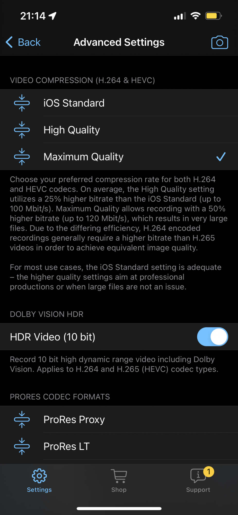

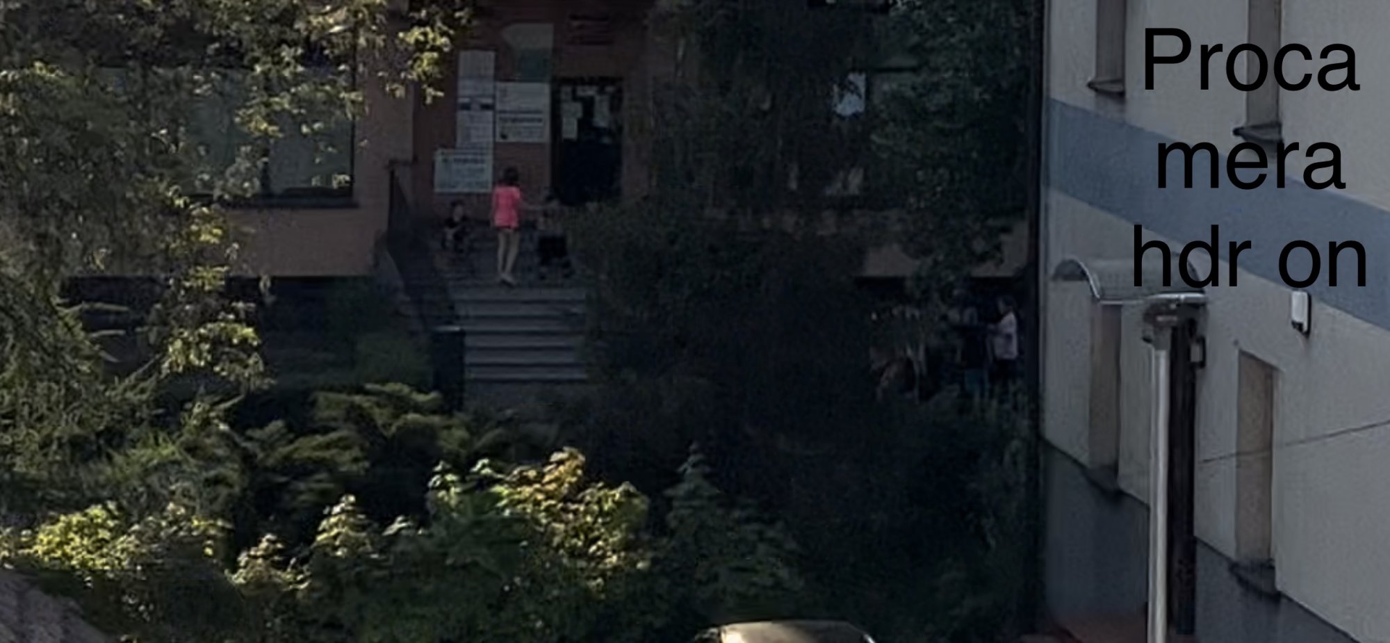

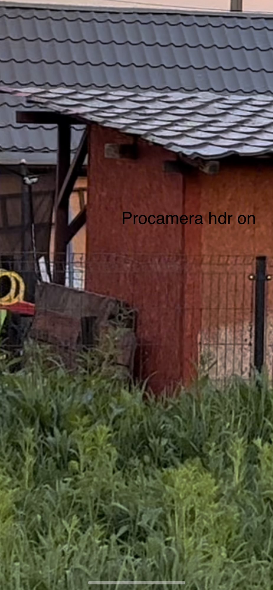

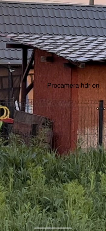

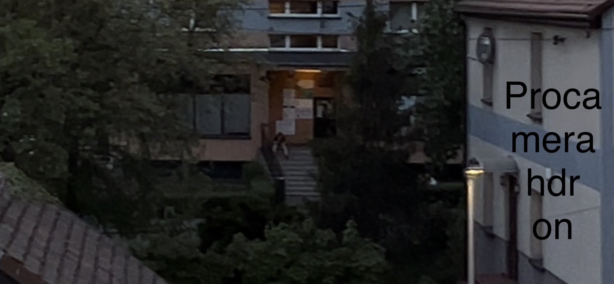

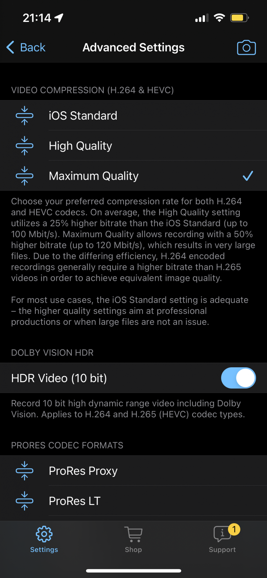

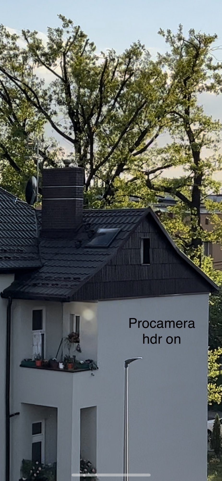

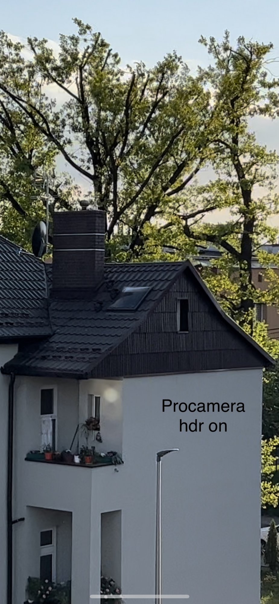

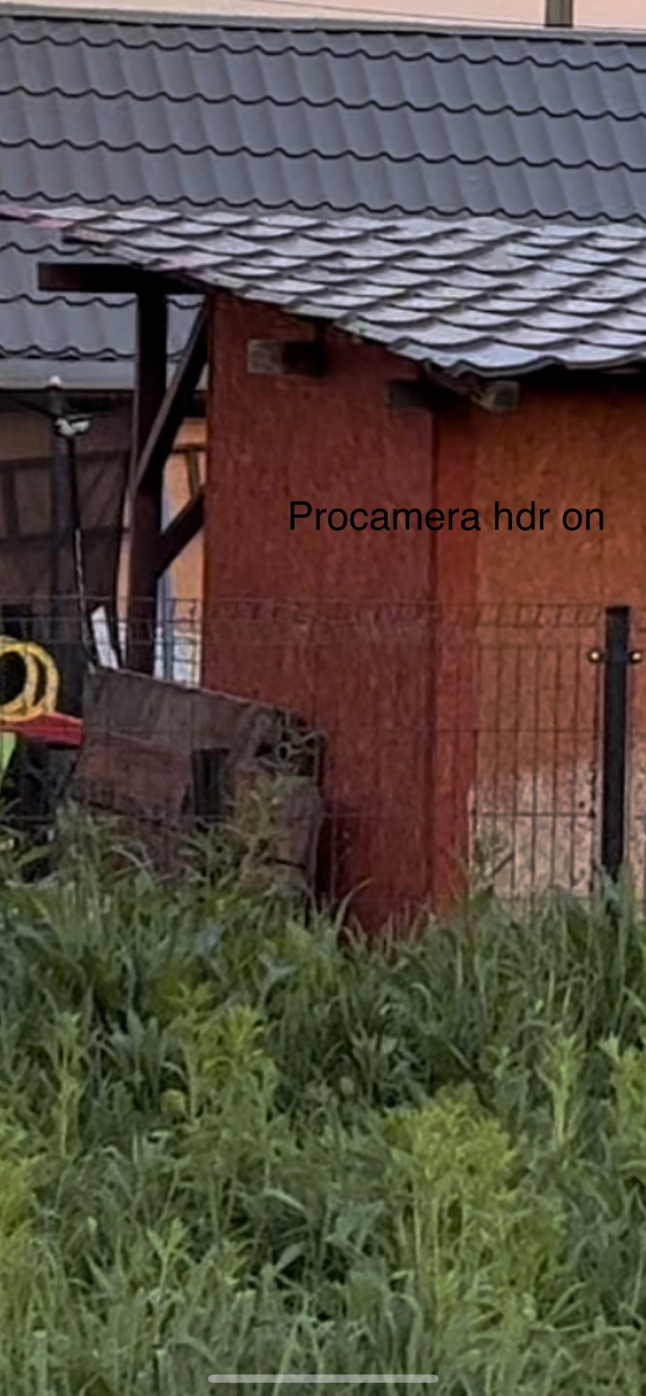

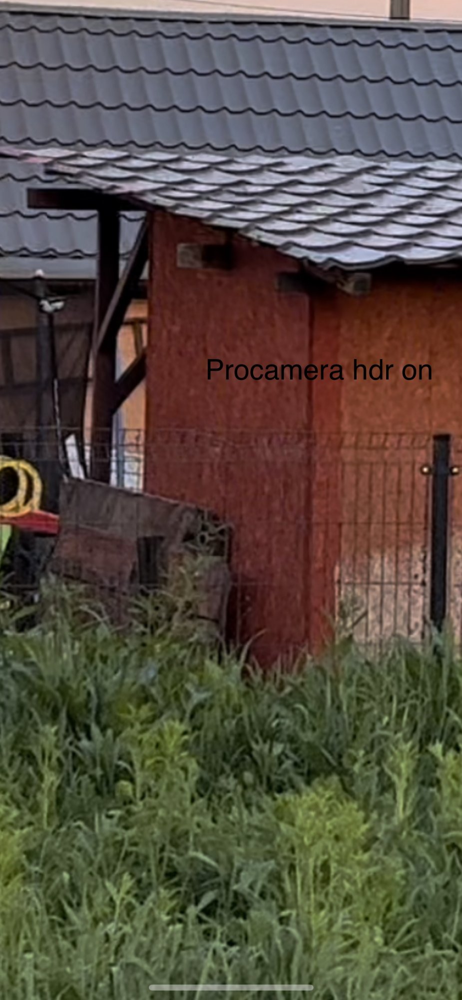

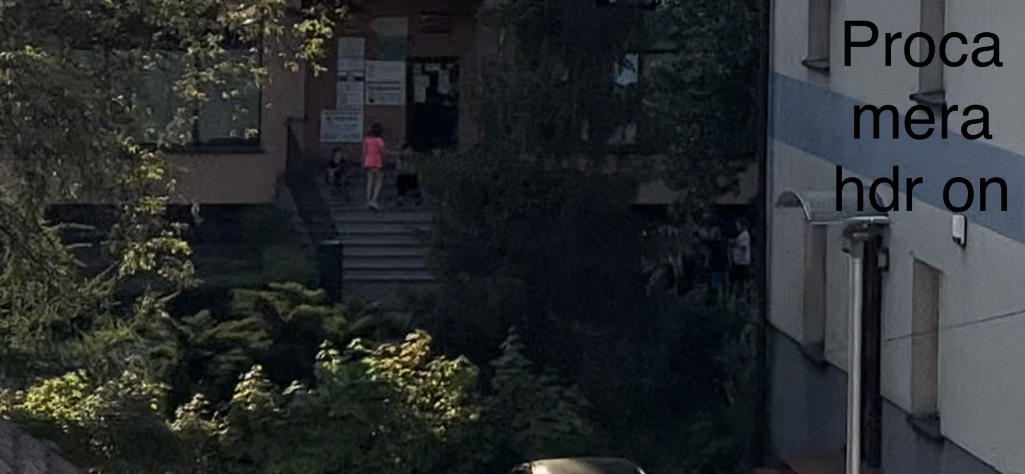

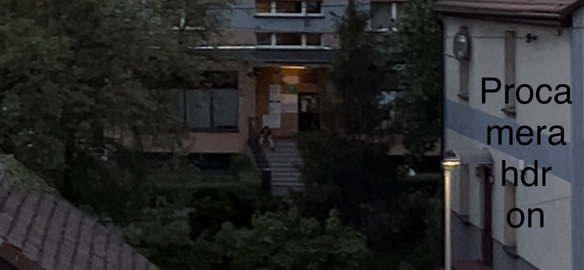

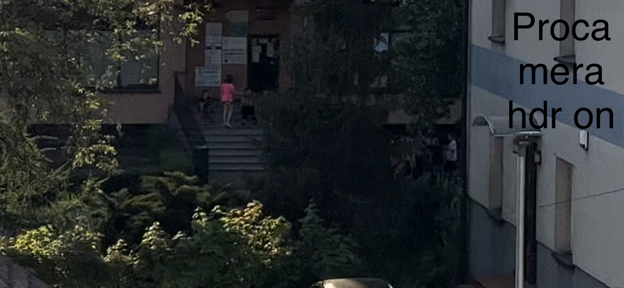

I have some good news people. There is a way to get much better quality videos with HDR ON. The quality is soo good that it even surpasses the standard camera app HDR OFF quality.

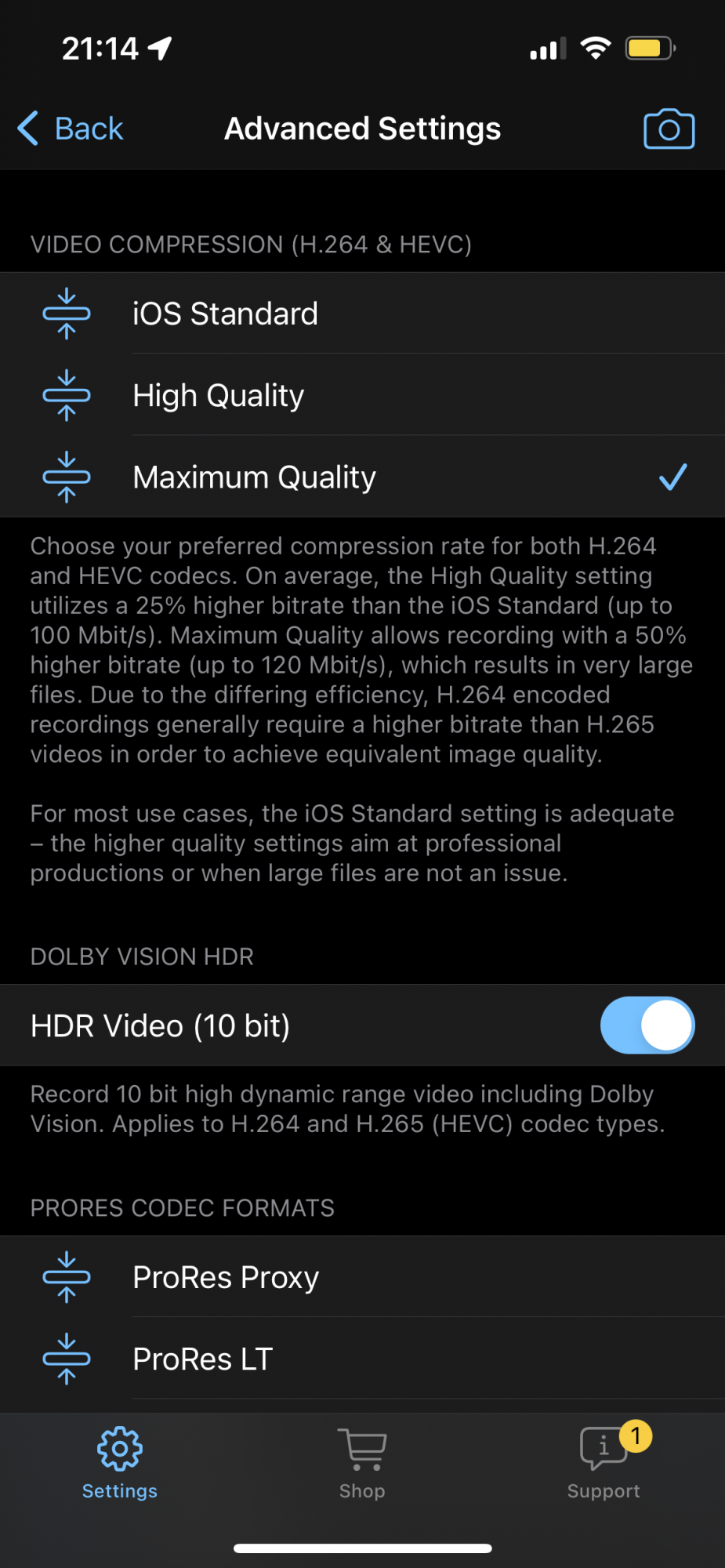

Don't think that it's some kind of ad! It's not! I accidentaly discovered that my favourite HDR Photo app has some serious Video functions. This app is ProCamera and you can buy it on the AppStore.
Here you can see the settings that you can change (also you can change formats between H.264, H.265(HEVC) and ProRes422 and even set many different fps settings like 48 or 50):

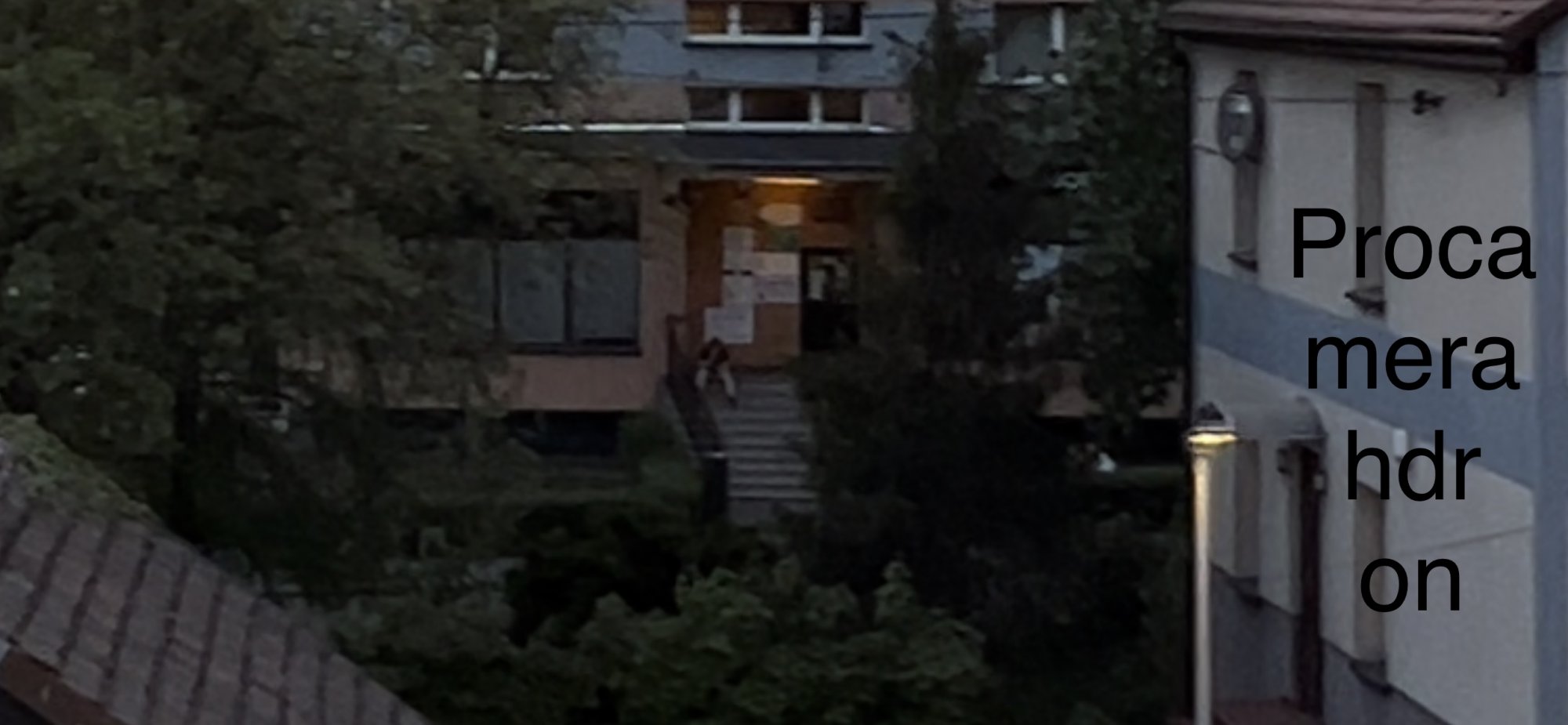

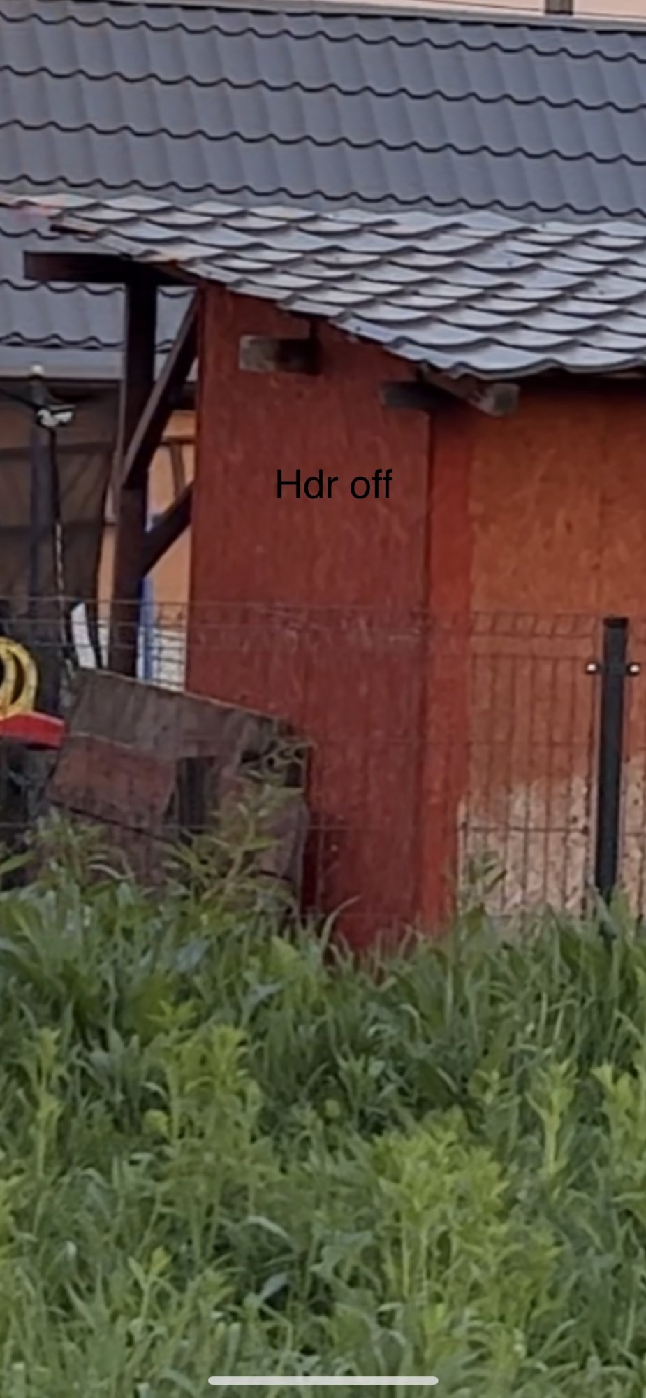

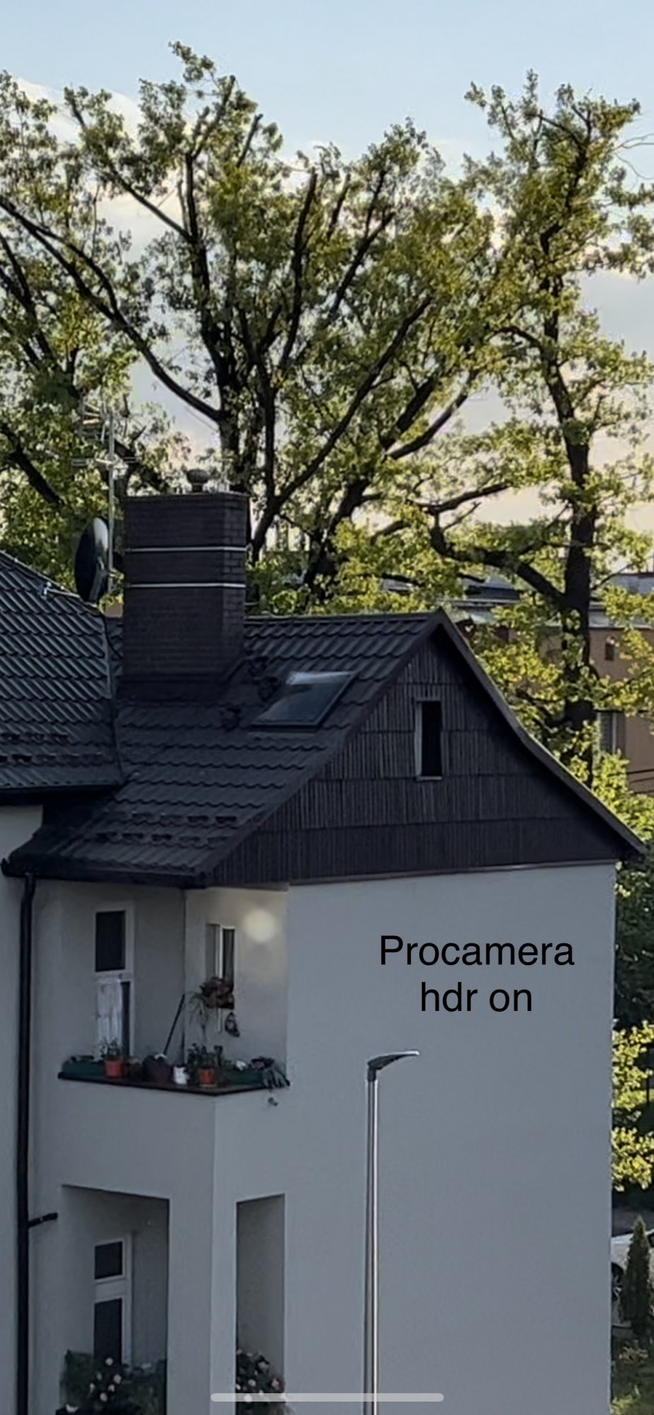

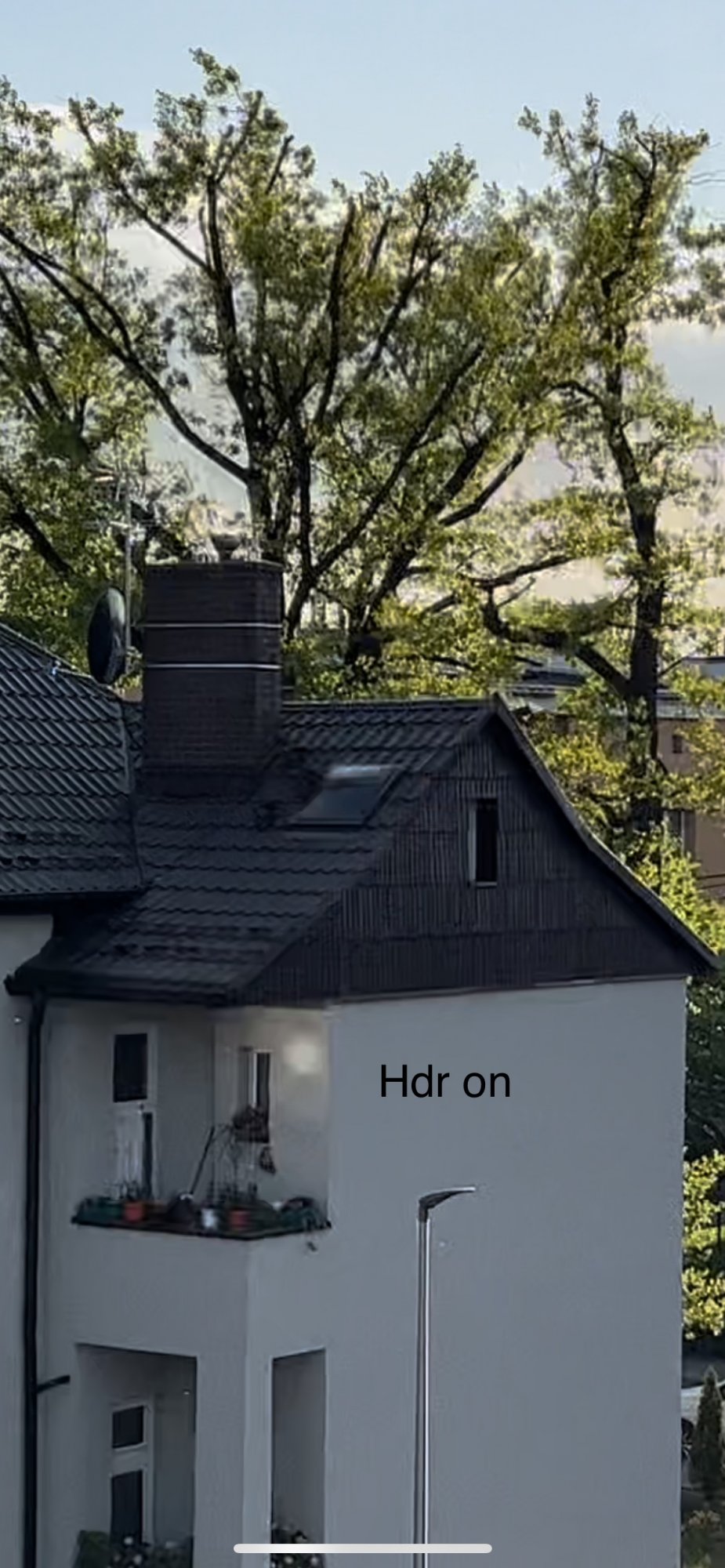

And now the good stuff. Some comparison of close up screenshots between standard iOS camera 4k 60fps HDR ON, 4k 60fps HDR OFF, ProCamera 4k 60fps HDR ON - see the attatched files.
As you can see the quality on ProCamera is really great. The conclusion is that this is not iPhone 13 Pro being too weak to record good quality 4g 60fps HDR videos. The issue is the iOS camera app itself.
I am going to report this to Apple Support and hope they will fix it in upcoming updates.
Hello. Mind to share which of this two apps are you talking about:
1. ProCamera - https://apps.apple.com/us/app/procamera/id694647259
2. Pro Camera by Moment - https://apps.apple.com/us/app/pro-camera-by-moment/id927098908
Thank you.
It's the low bitrate. The phone changes the bitrate likely to save on space, it may average around 40Mbps from what I have tested. Ideally you would want 80Mbps even with an HEVC encode, it's clearly visible in the sky.
40Mbps for 4K/60fps and Dolby Vision is way too low, if you want a picture perfect video.
