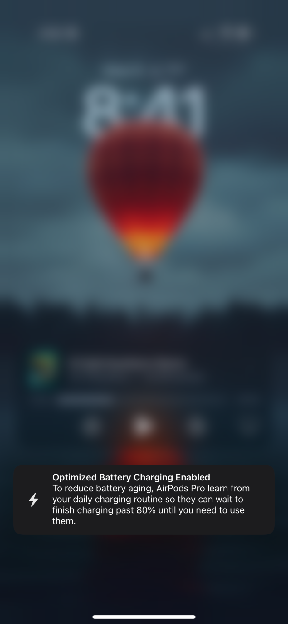

Glad to see one of the Optimized Charging devices kicked in 🤪🥴

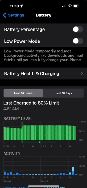

No reason for my phone being so warm in the morning when I take it off the charger. It charged to 80% hours ago.
Anyone know why?
Powering on and off not working and still getting warm. It is like when it is done charging, it redirects the charging current to a heater!

Do you have the 80% charging option turned On under Battery setting?
Have done multiple resets. Yes the 80% is engaged and when I plug it in, according to the battery graph, it immediately charges to that 80% within the first hour when plugged in. For the next 8 hours the graph show it at 80%. when I take it off the charger in the morning.
Never used always on as I wear an Apple Watch, can't believe that apps are refreshing in background. I am closing all apps before putting it on the charger just to make sure. The battery program shows nothing is happen out of the ordinary at nigh while sleeping.
Thanks for the suggestions. I have owned a lot of iPhones and the only time one of them was warm are charging was using wireless charging. I charge via a cable.
Not a big deal, as mystery and was just wondering why it is warm.

Wow. I had given up hope that my optimized charging would ever work and then last night I woke up at about 1:00 am and saw the message that it kicked in for the first time since I got it on launch day. What the? Crazy. Geez
