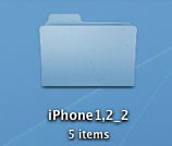

Ugh, okay so this is what I've done so far:
1) Downloaded the firmware (iPhone1,2_2.0_5A347_Restore.ipsw). It downloaded as a zip file, and then proceeded to auto-unzip, so I had a folder -- iPhone1,2_2.
2) Tried Option-Clicking, to install on iTunes, couldn't find the ipsw file.
3) Read up that I needed to zip the folder back to a zip, and then rename an ispw.
4) Tried re-zipping the folder into iPhone1,2_2.ipsw and then iPhone1,2_2.0_5A347_Restore.ispw.

Just to update, I downloaded it again with Firefox, so it didn't download as a zip. It updated perfectly.

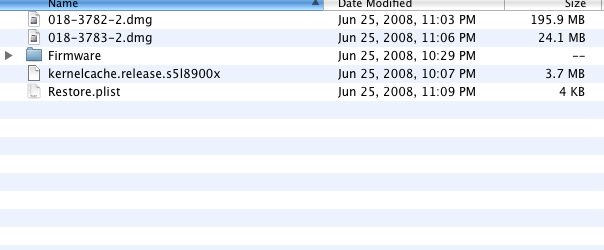

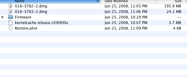

When I download it I get this, where's the .ispw file that I need to use? 😕
Download it using Firefox or turn off "automatically open files" from Safari. Either way you need to re-dl it. I tried re-zipping that file and changing it to ispw, but it kinda botched my iPhone install. Flip back a few pages to see my results (I have a 2.0 iPhone now, works fine).
