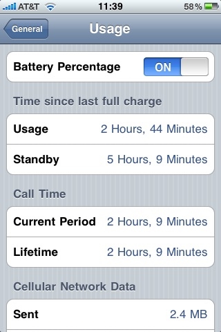

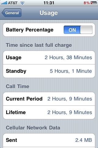

whats going on
these shots were taken back to back no time spent on charger
