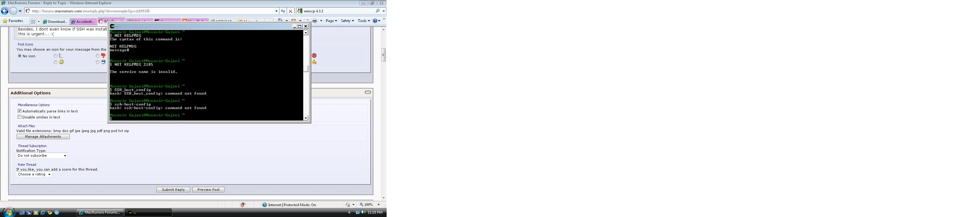

I opened cygwin, entered ssh-host-config, and it says:
bash: ssh-host-config: command not found
:'( i m badly stuck..
This is the very first command I need to enter after opening cygwin right? Besides, I dont even know if SSH was installed on my iphone :( Please help this is urgent... :(
