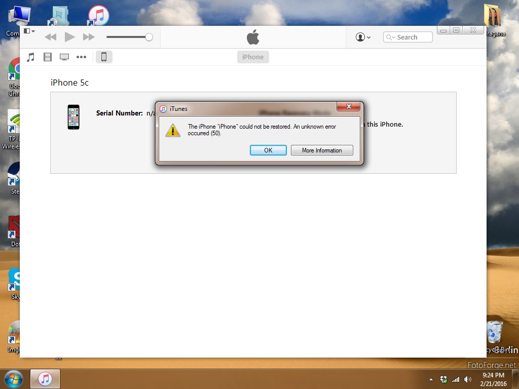

Hi, i have a problem with my iPhone 5c. I tried to update and restore it via iTunes, but when it come to veryfing softvare stops and on the computer screen shows Unkown error (50). Do somebody knows how can I fix that? Thanks
Error 50 is sometimes a bad download. You might want to find the .ipsw file (usually in Library/iTunes/*) and move it somewhere else to force iTunes to download a new copy. No guarantees, but it is worth a try.
If the restore actually completes and you get Error 50 after that, it usually means that iTunes is having trouble talking to Apple, so you should make sure you have a good network connection.

i tried everything now, but the same thing is happening. I have moved the file and it downloads a new one but during the download i 've heard few times a sound like when you pop out and pop in a usb cable/stick. And I tried with two diffrent cables, same story.
