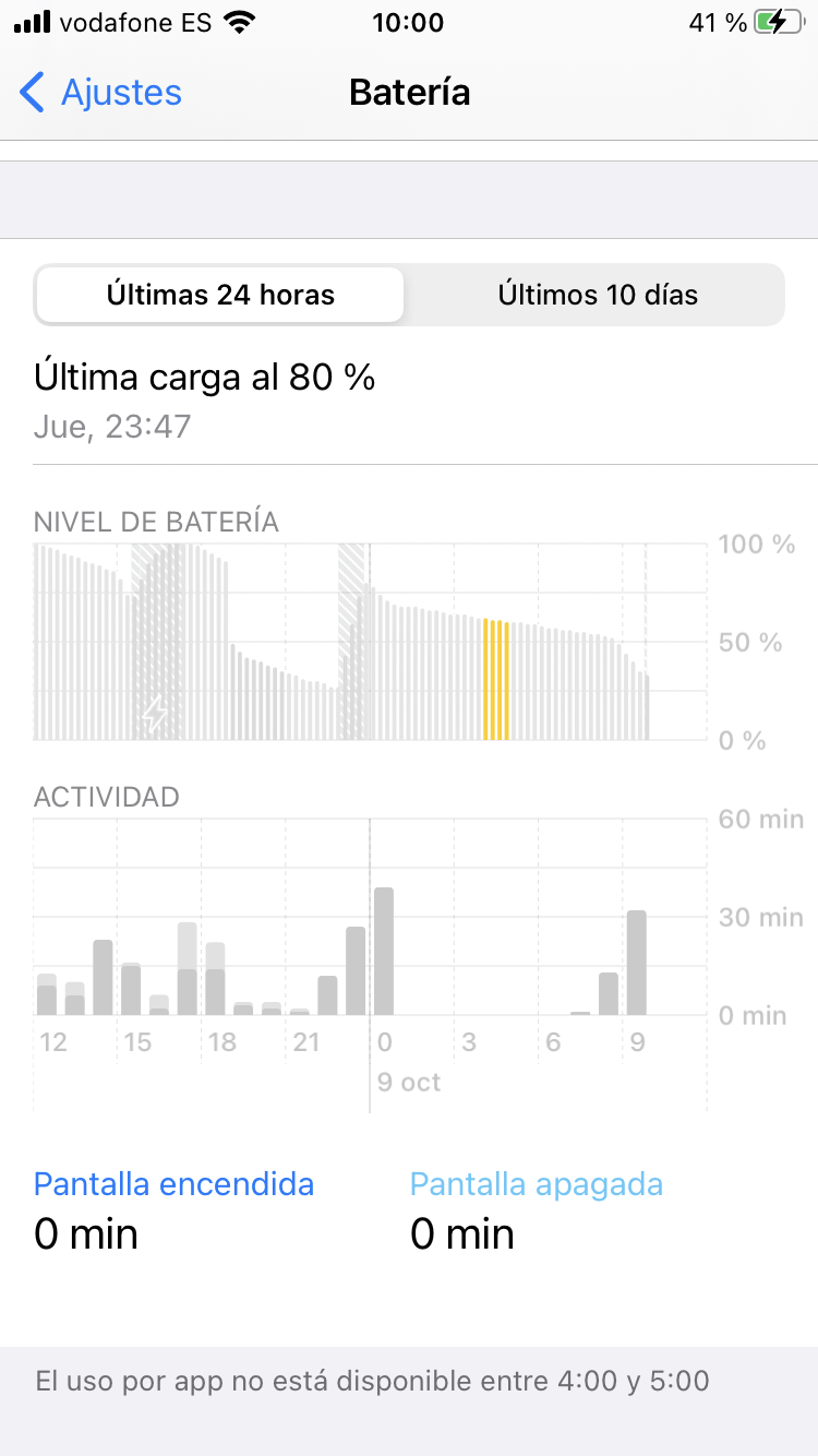

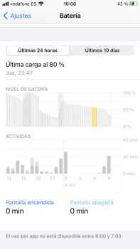

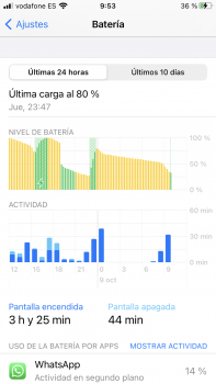

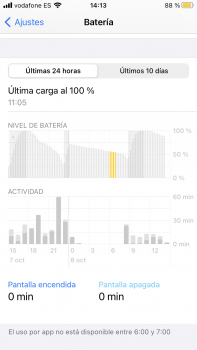

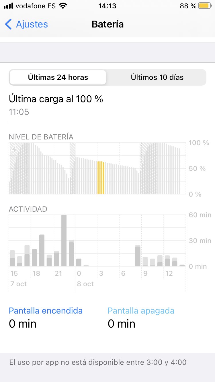

Since 1 year ago approx, I'm suffering horrible battery drains. My battery is in 85% of health, but I need to charge my iPhone 2 times in a day, sometimes 3. Horrible.
I've left the phone without being charged this night and, as you can see, more than 25% battery drain with NOTHING in the background.
Everything is turned off (location, wifi, updates, etc.). My battery dies with less than 2 hours of use on a daily basis.
Nothing special with iOS 14, suffering it from iOS12.
Should I replace the battery? Went to an Apple Store looking for a battery replacement and the technical guys said to me that a default reset without restoring from iCloud would solve the problem. Not at all.

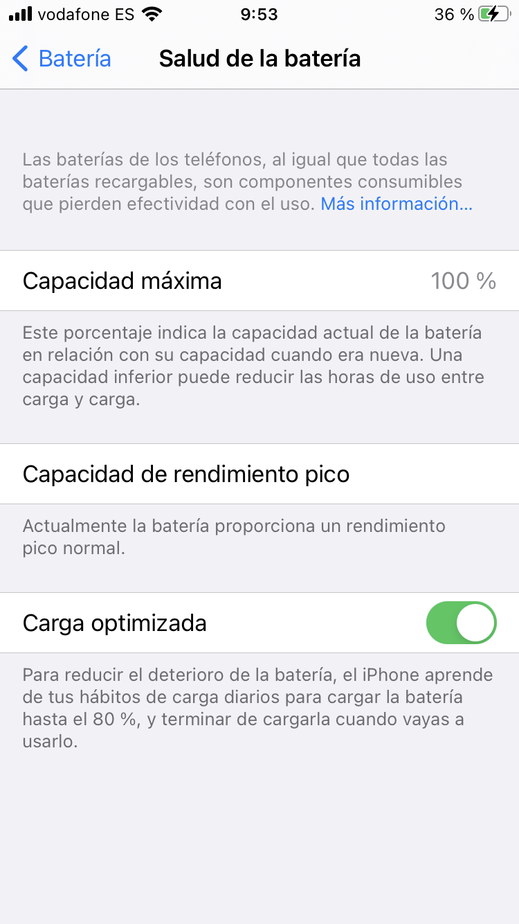

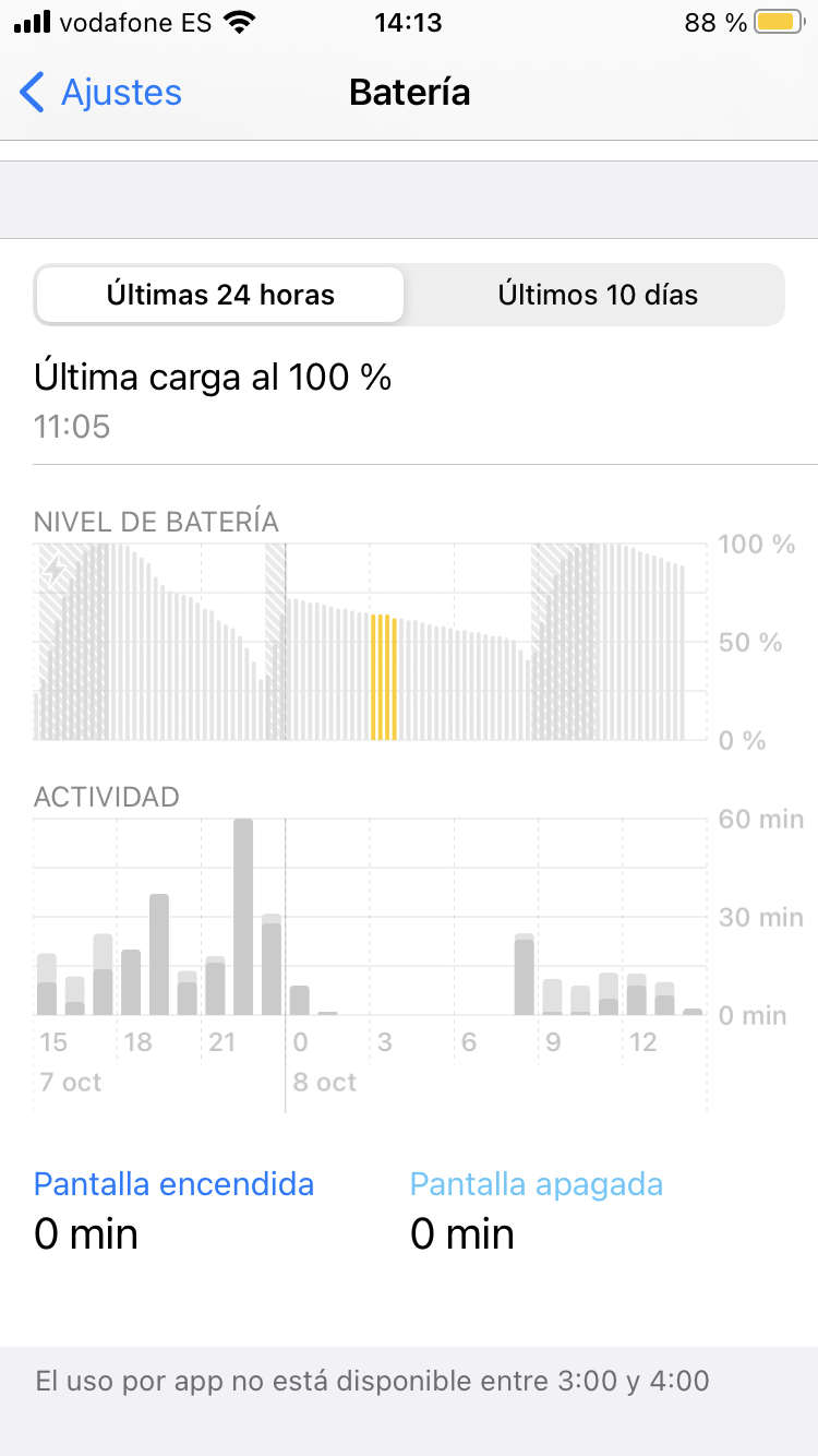

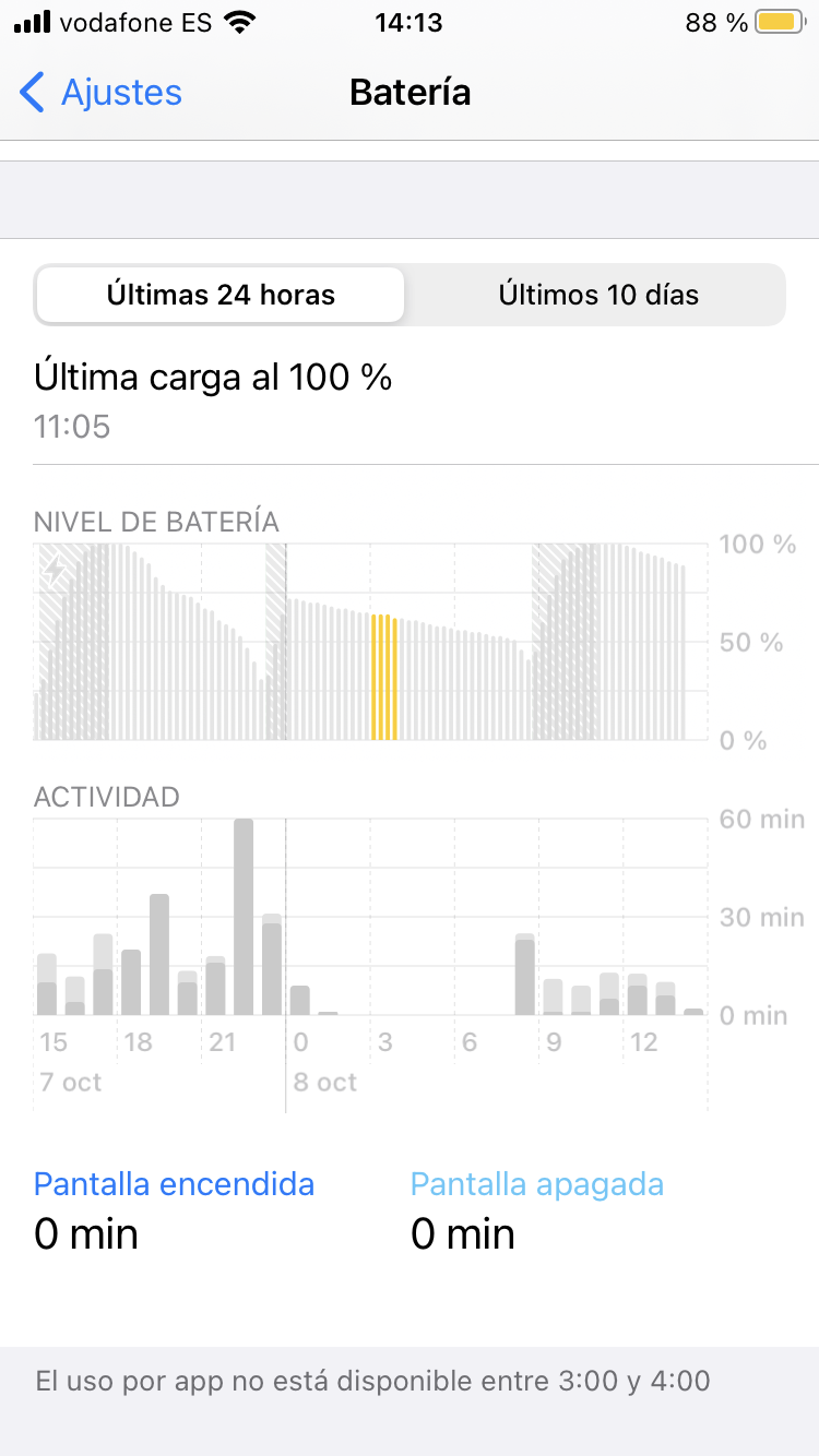

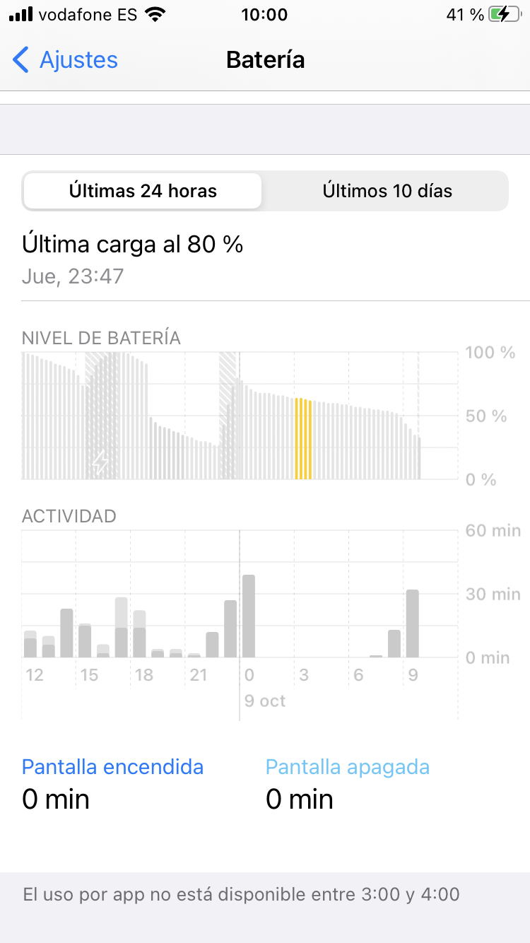

I replaced the battery yesterday. Charged up to 80% from 20%. I left the iPhone without being charged this night to see drain battery results. It's pretty similar to before so... very disappointed.
Maybe the battery needs some time to "be balanced" or something like that. Let me show you some screenshots:
Now the phone is being charged. I will wait until 100% and this night I will shut down the phone and charge it during the night so I might calibrate the battery.

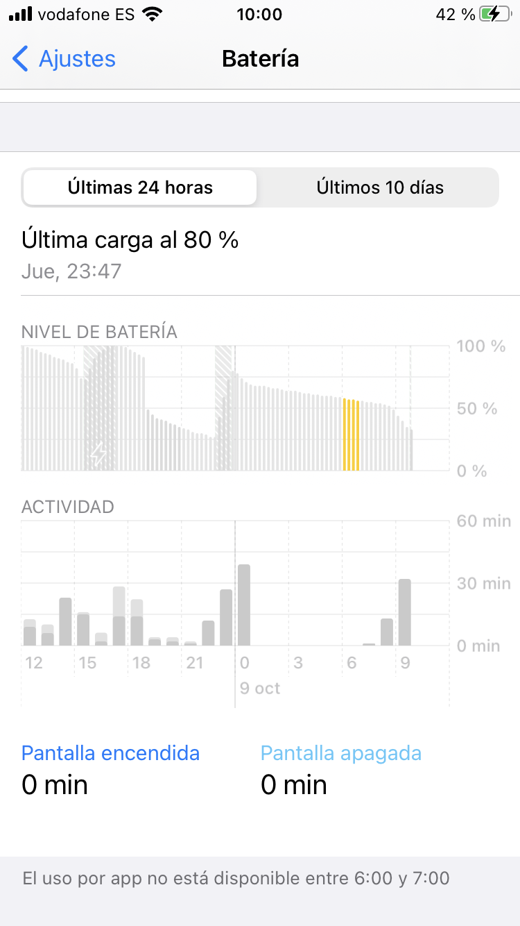

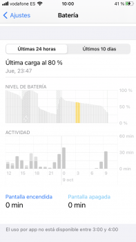

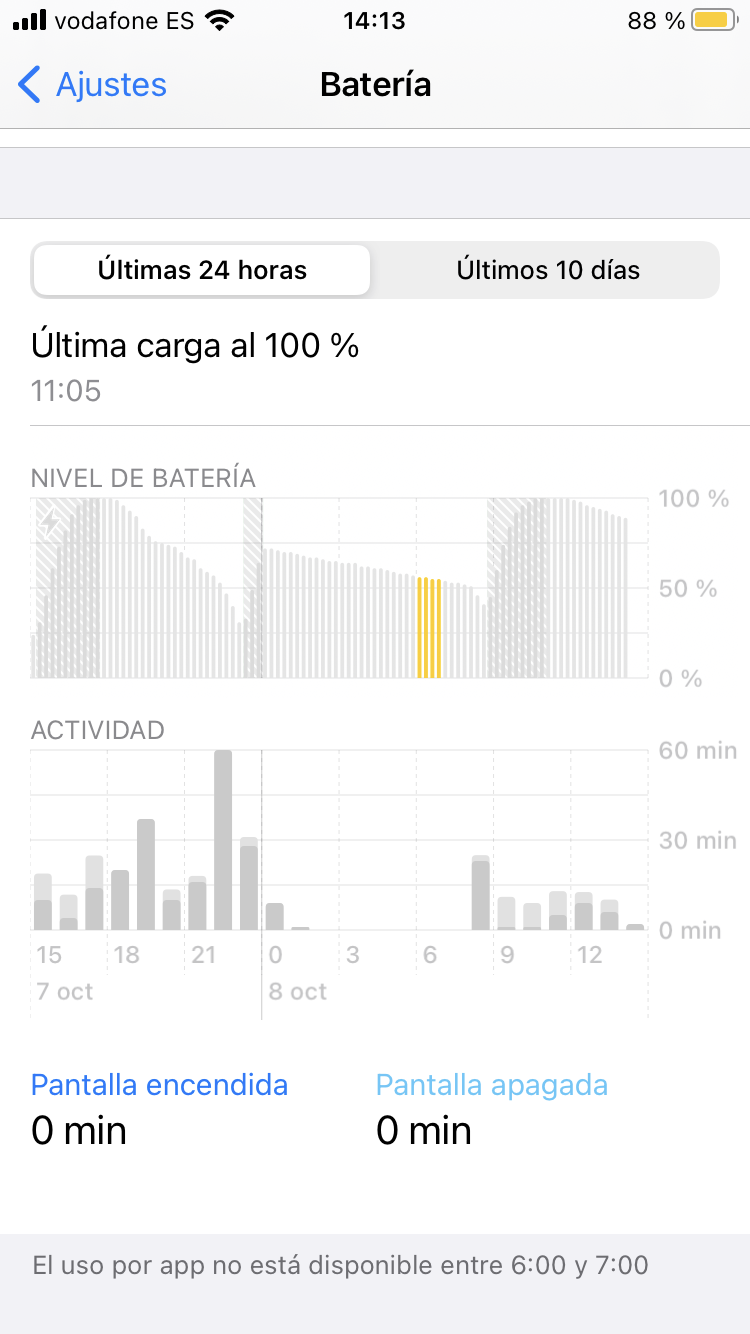

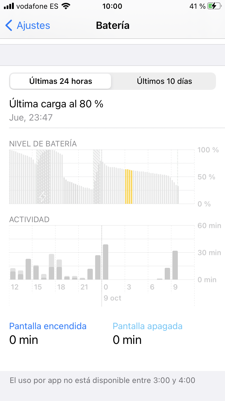

I'm 100% sure there is nothing in the background.
And there is nothing related to iOS 14. In fact as I said, I'm getting this results since iOS 12
