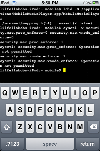

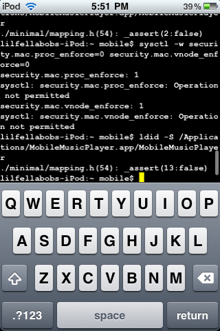

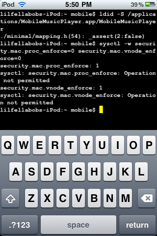

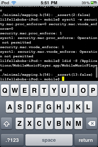

Hmm thanks. tried and got some errors. am i supposed to running this on terminal on the ipod?
ill attatch my commands and mobilemusicplayer
You have to be 'root' to enter those commands. If you use MobileTerminal you are usually user 'mobile'. Enter 'whoami' to prompt who you are.
Enter 'su root' with password 'alpine' to change user to 'root' and then enter the commands again.
