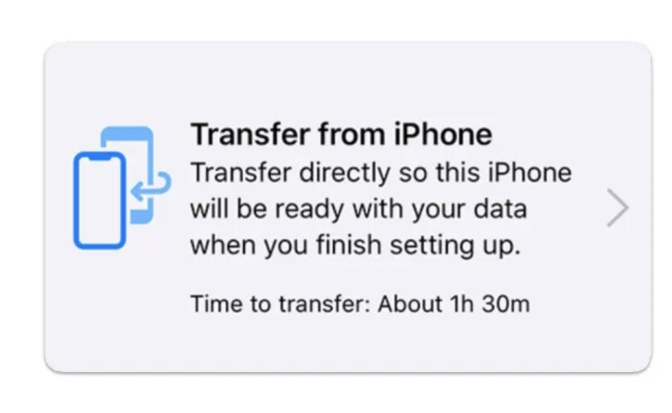

I didnt take a picture but the first time I did the transfer, I believe the plugged in the cable after I clicked Quick Start and the transfer estimate was about 46 minutes and going up so I decided to Reset and start over. The second time I kept the cables plugged in before I started and then I saw the icon of the 2 iphones with a cable and it only took about 10 minutes to do the transfer. I used a TB3 cable and I had about 130GB of data.
This is just a random pic I got from Google but if you see this icon then it is not using the cable. I couldn't find a pic or video of the cable transfer method at the moment.
